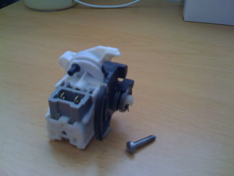

Nah you need a boot release solenoid (sp).
I had same problem. Its the white thing that the rod attaches to.
I have a spare here that I picked up at the weekend. Easy to change - 5 minute job just need a T20 screwdriver.
I can take a picture of it if you like.
Can probably package it up and send it to you if you have no luck finding another one for a price of course ;)

Thanks for pic mate, i take it that is found in the boot lid but removing the lock etc?

nah remove the interior trim from the bootlid and it should be just behind where the diamond sits.
  Skoda Fabia vRS
the button thats in the diamond comes with the mechanism aswell
8200 060 917 £39.94+vat
most dealers will have them in stock
