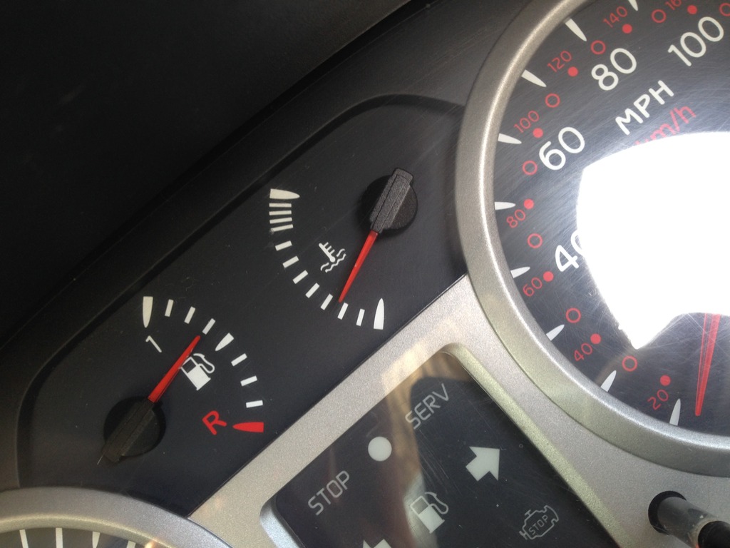

There is also another issue which I have just remembered. The coolant temperature gauge is all over the place and it varies between 0 and ¾ and won't stay in the same place. Is this likely to be an electrical/temp sender problem?
Thermostat likely cause
I did think that. Bought a new one today and will fit it tomorrow.

3. Changed the thermostat, seems to have helped a bit but the gauge seems to always read 2 bars low? When it is switched off the needle goes right to the bottom, unlike the fuel gauge, which rests on the bottom line.. Not sure what is happening here but it doesn't seem to be much of an issue.
This is what the needle reads at full operating temp, OBD says it ranges from 75-95 deg C while driving, which seems about right. Also the fan kicks in about the right time.

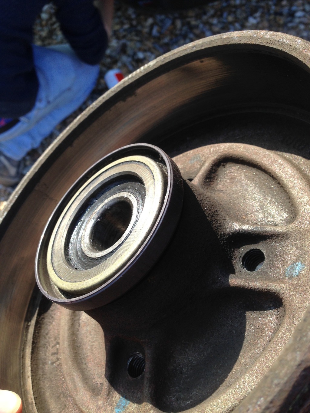

I'm still sorting the rear brakes, I ended up getting a new drum as I couldn't find any bearing that would fit the existing one, so I will change the other side drum and shoes so they are matching. This leads me to my problems with the ABS system...
The two rear drums appear to have different ABS reluctor rings fitted, below is an image of one of them. It doesn't look like it has had or is supposed to have teeth, whereas the other side has chips and raised areas that look like it would have had teeth but they have broken off. The new drums don't have ABS rings fitted, so am I right in thinking I can fit these? http://www.ebay.co.uk/itm/190914917581?_trksid=p2055119.m1438.l2648&ssPageName=STRK:MEBIDX:IT Does it matter that they are different to the rings removed?
