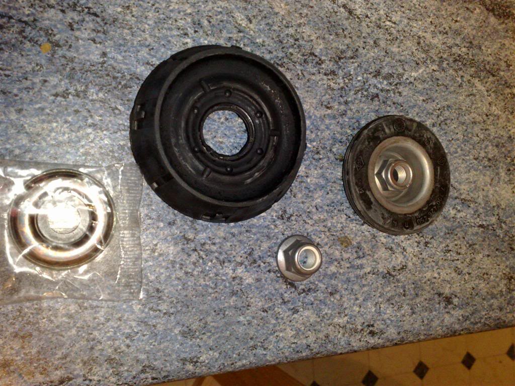

i just bought a new top mount KIT from renault
but the nut is different to the one already on the car?
the one ontop of the rubber mount?
should i use the newone or the old one?
and will the washers wont fit over the nut either

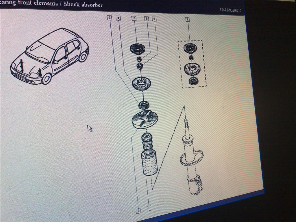

this is the revised kit
the kit is number 8
and yeah i took a picture of the screen while the guy had it up...lol
That seperate nut is not used. Just biuld it up with your old nuts but the new rubber and bearing.
ok cheers
which way up does part number 3 fit? and that fits on top of the top spring cup yeah?
infact is that the correct order of fitting?
and is number 2( in pic below) the right way up?

the drivers side, (the one i just changed) fits better than before and compared to the passenger side
what i mean is there is less gap between the turret top and the top washer (6 from pic below)
