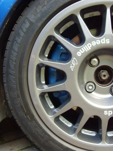

Hamerite smooth for the win, but won't match the 182 blue.
Hammerite Smooth, around £6 a can for 250ml and they come in quite a few colours

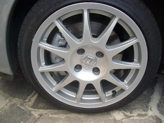

Silver FTW
Hammerite Smooth
I wouldn't use hammerite tbh after seeing how easy it peels off when it gets a bit hot...
Nope..... Thorough Wire Brushing and a Wipe Down and then just Painted on.

Hammermite is just Brushed on It's very easy to use and its quite thick so you shouldn't have too many problems getting a decent finish
yep as said, very easy to do, give it a few layers and it will be fine. shouldnt come off, dad used hammerite on his impreza, i used it on me clio and its done a good job!
