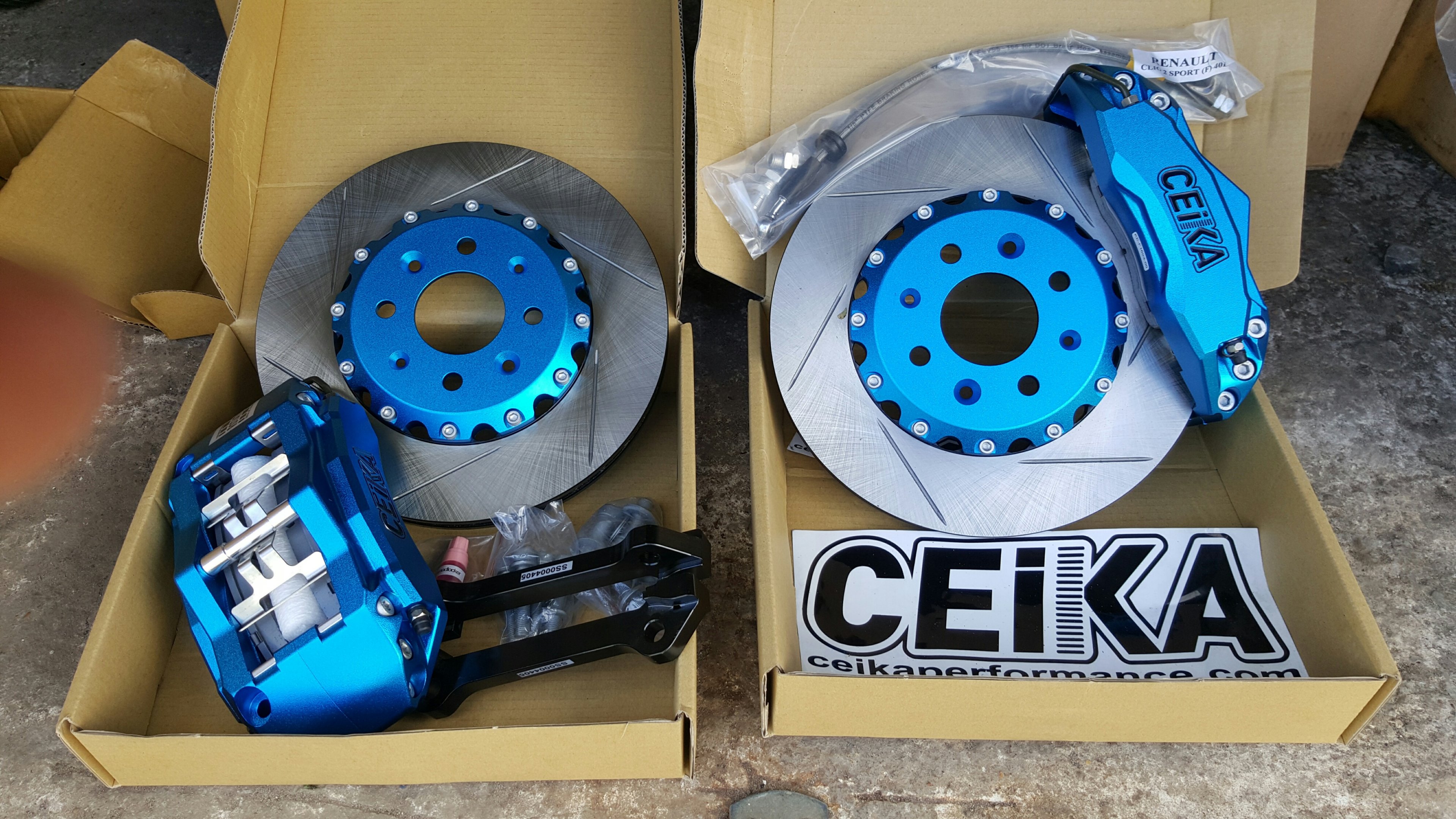

Ceika front brake kit has arrived, just finding time to fit it during the next month is going to be impossible.

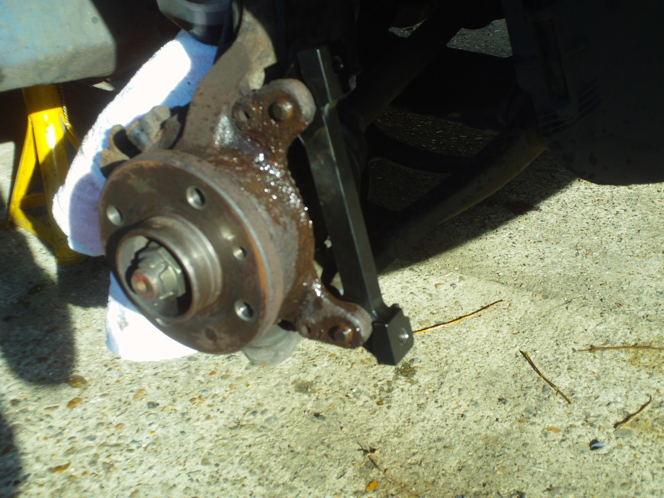

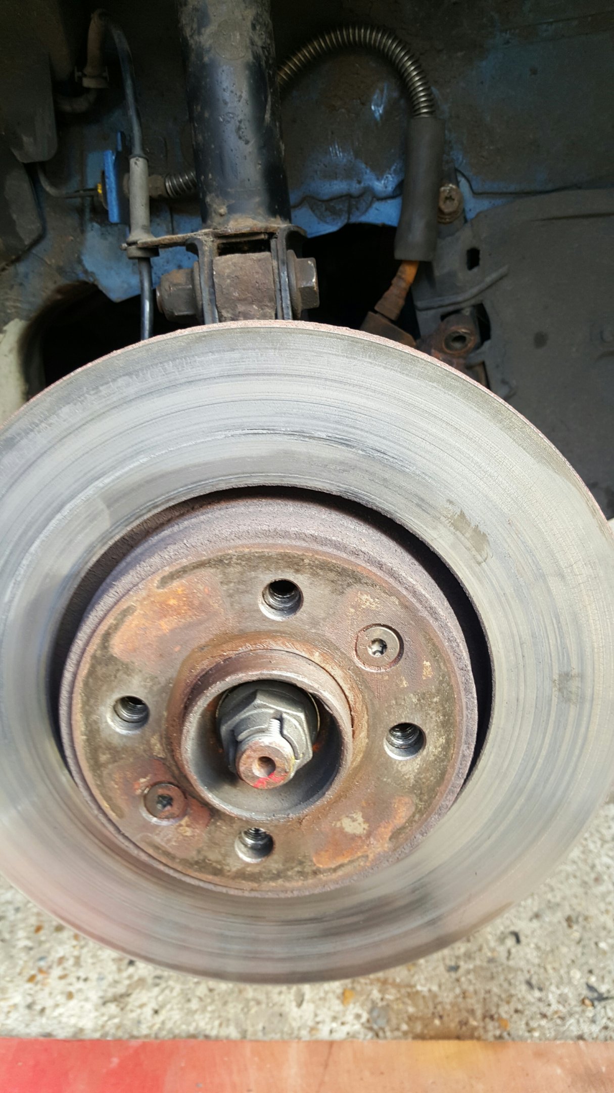

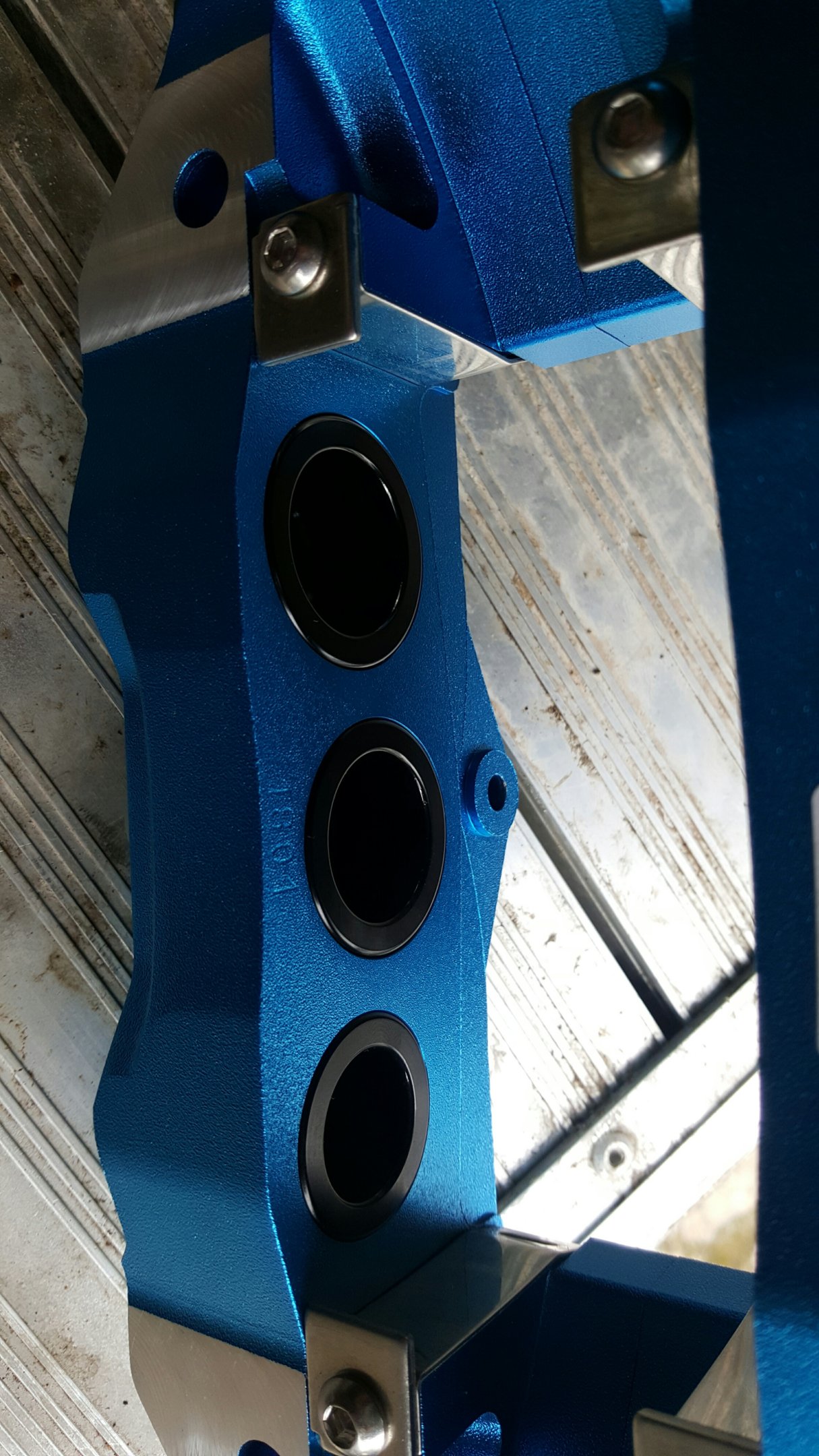

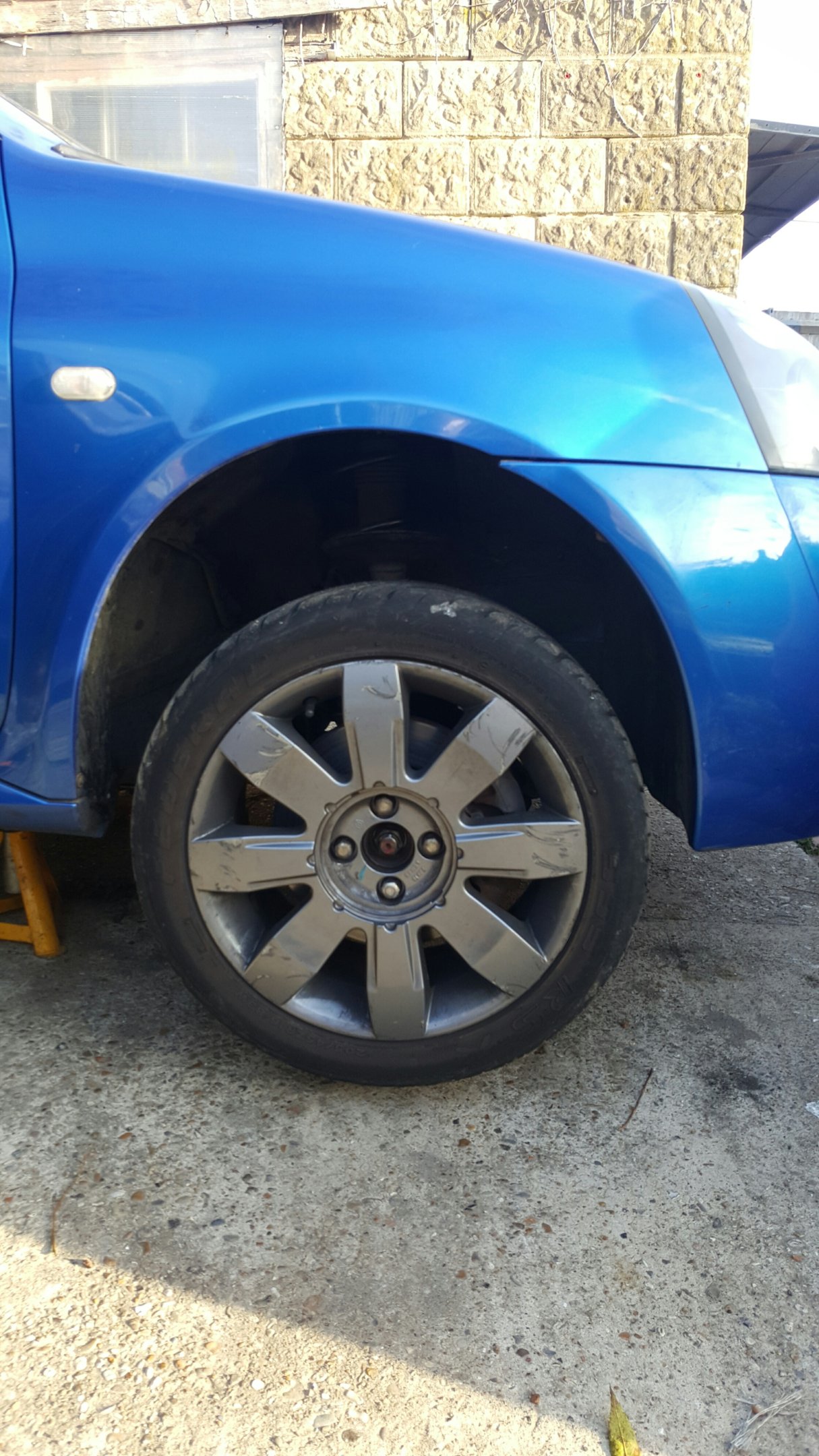

Finally had a chance to fit the brake kit. Trying to push things on a bit as I've entered an Allcomers race at Lydden Hill on 3rd November and still got loads to do!
I am very impressed with the quality of the product. It was a really straightforward fitment, and it actually took me less time to change the brakes than it did to flush through and bleed the system with fresh Castrol React.
Everything you need is included in the kit, right down to a little pot of thread-lock, and various shims to centralise the caliper if necessary.
Some pics:

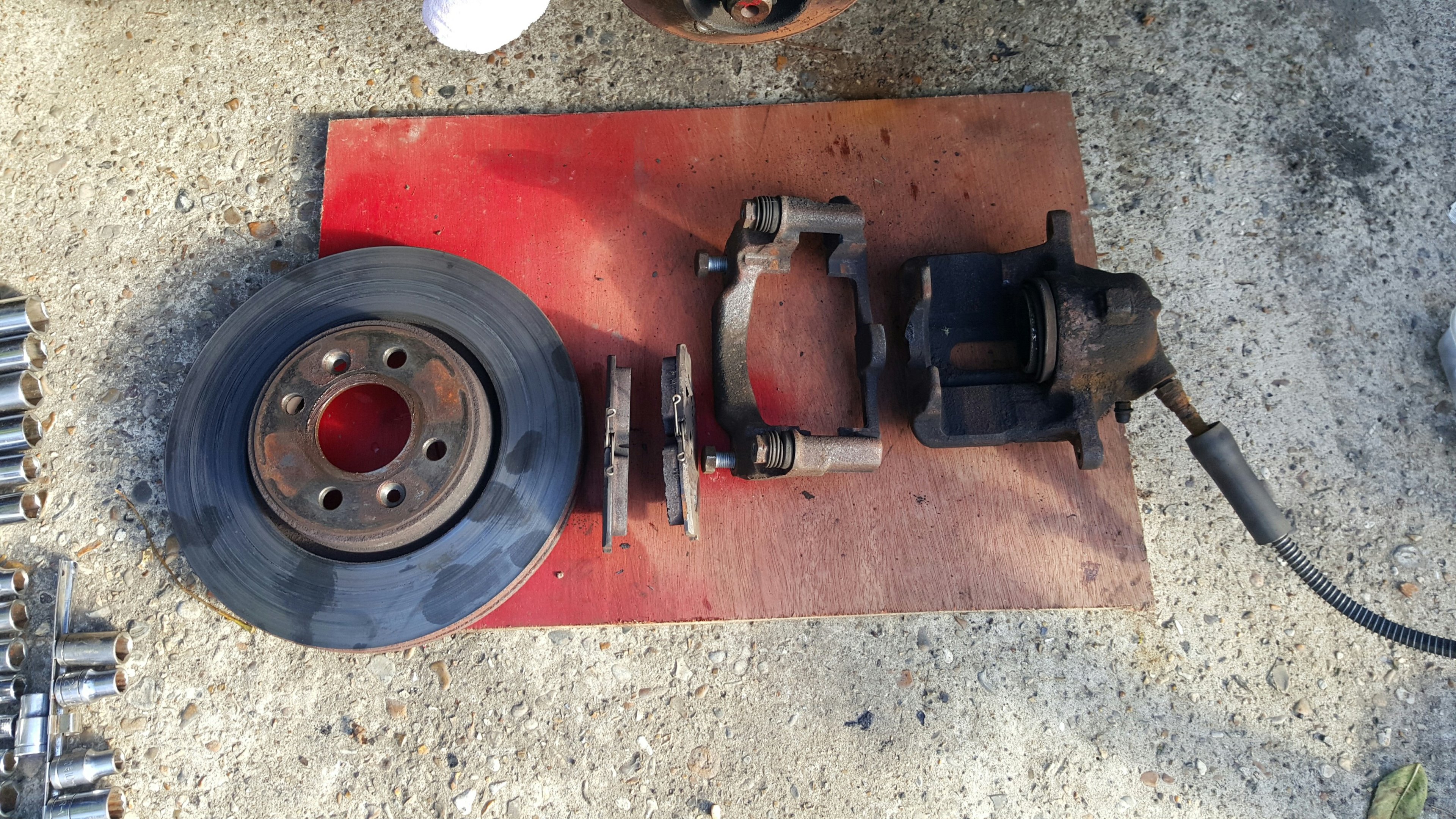

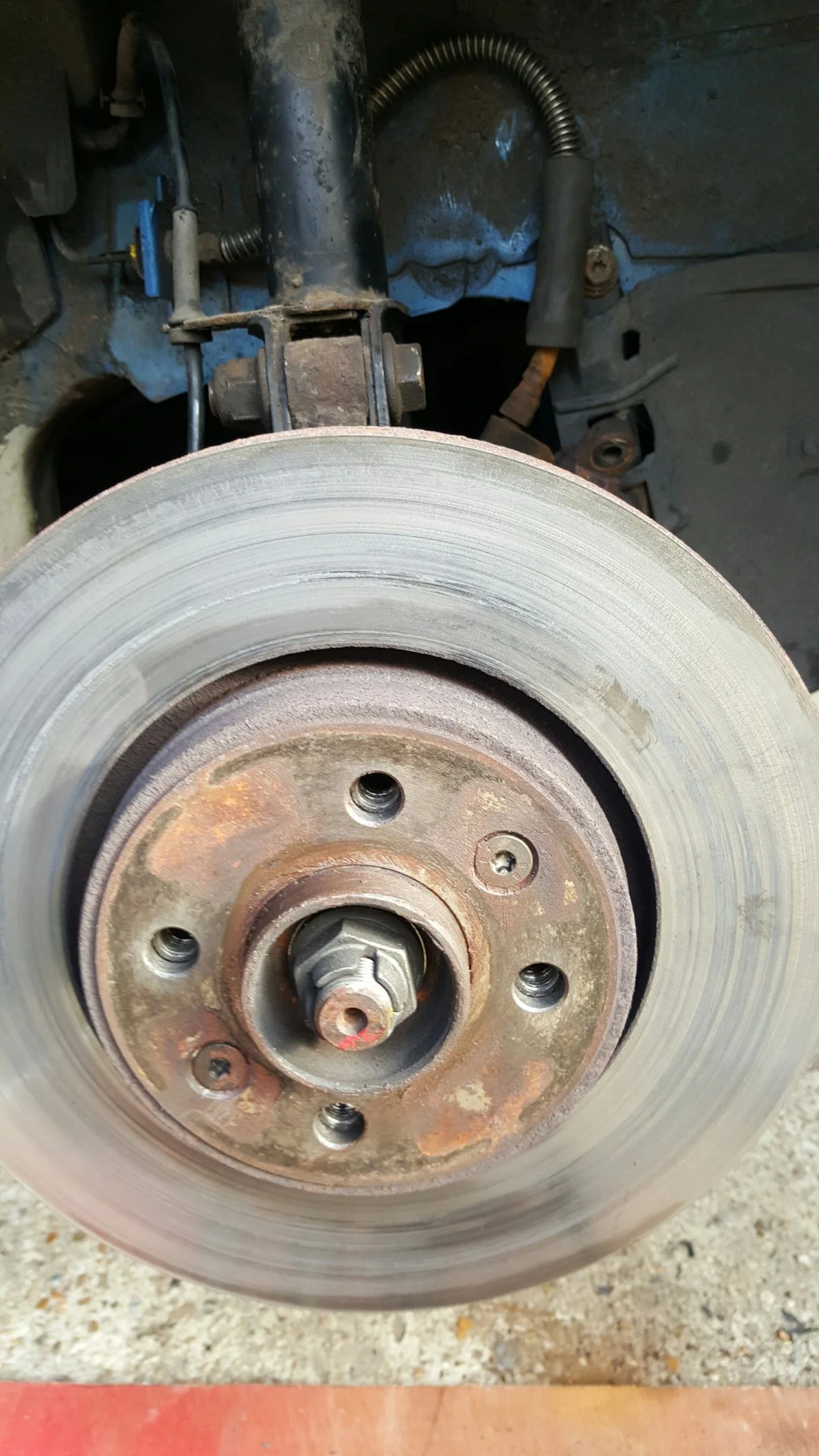

OEM Kit removed and in good condition with plenty of wear left on £200 worth of Ferrodo pads!
Will be for sale if anyone's interested:

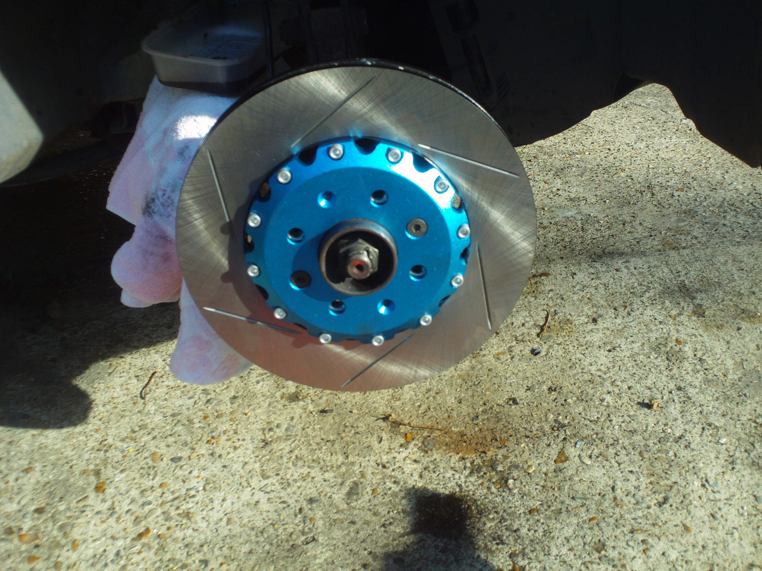

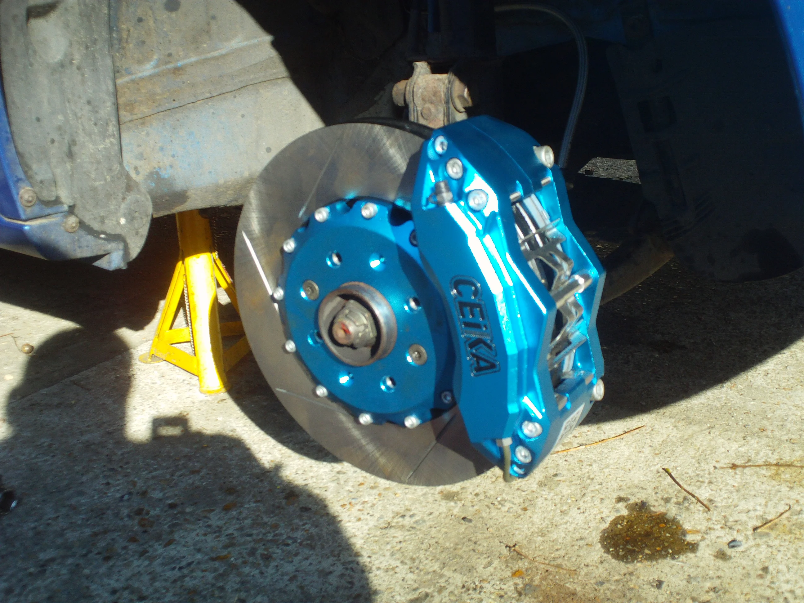

Caliper mounting brackets fitted
New 2-piece disc fitted, note the slots go 'against' the rotation, as per Brembo spec. I think the idea is that it improves the cleaning of the pad surface.

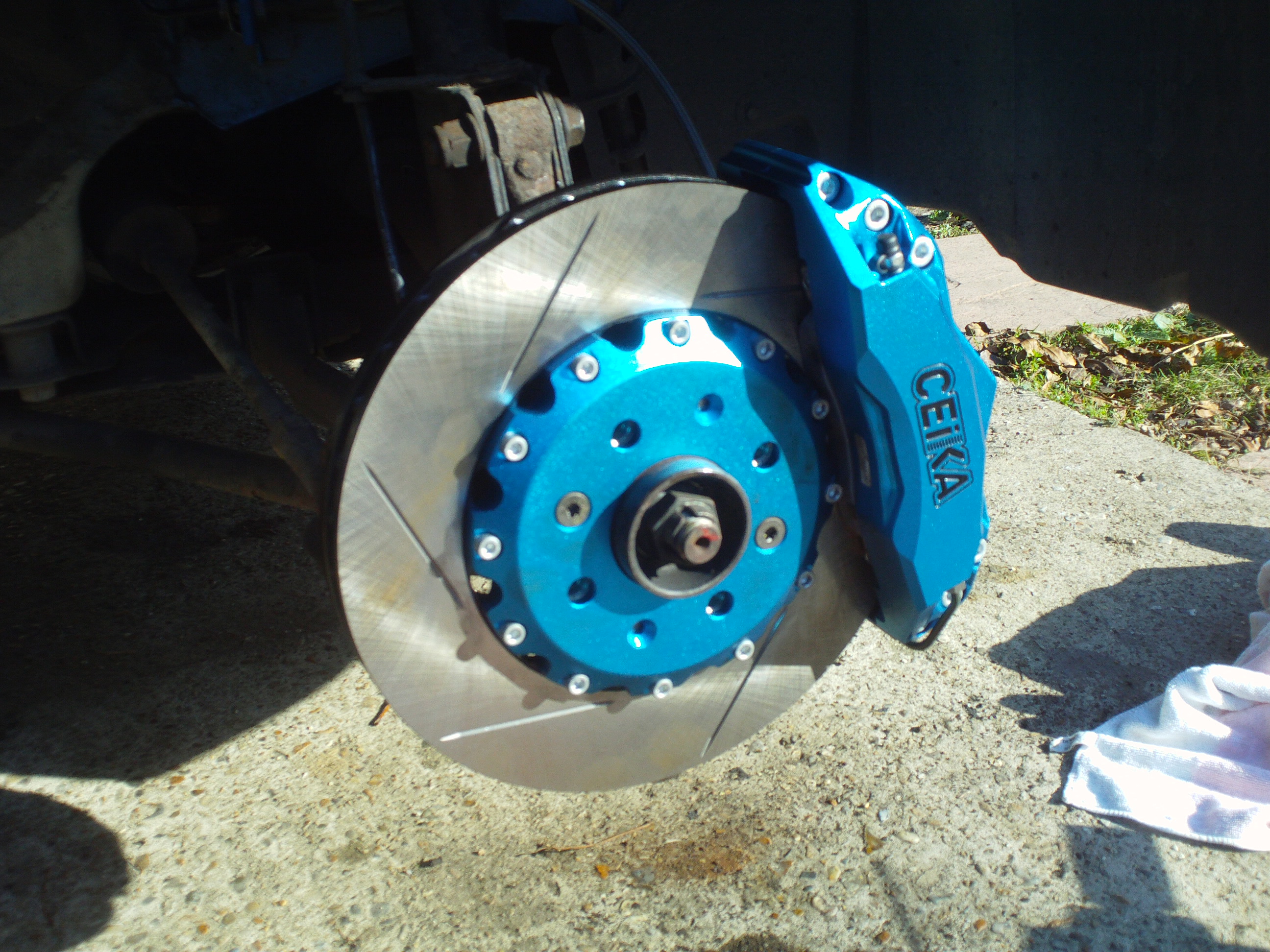

Calipers fitted, and new stainless braided hoses were a perfect fit to the OEM hard pipe, but also came with various adaptors if needed.
Another side benefit is the weight saving. I wish I'd weighed the complete new kit before fitting, but I put all the OEM stuff back in the same box and it was a damn sight harder to pick up!
Anyway the proof of the braking is in the driving, so looking forward to bedding in and road test tomorrow.

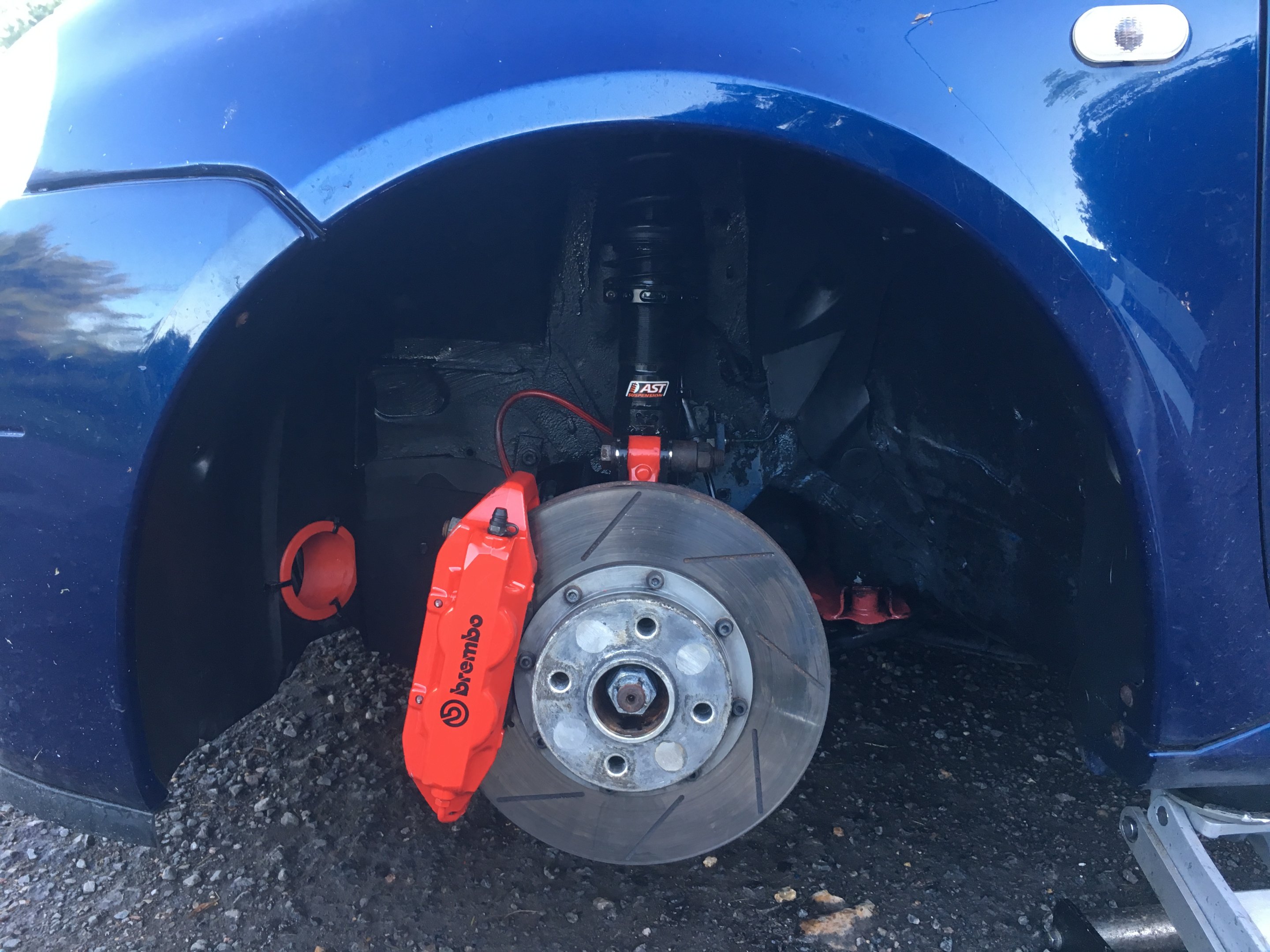

I went with the brembo conversion on the mk2. They are good round track and never have any brake fade...it’s the tyres giving up now!
I have found that having a decent race pad in the rear calipers does make a difference to running standard pads.
I went from CL rc5 rear pads to standard as everyone says the rear pads do nothing and it felt like the Clio wasn’t scrubbing speed off as well as the Cl rc5’s... new ones are back in the calipers.
My front set up
I’ve got a ducting kit off eBay. They just let fresh air into the wheel well. BYC make a kit that fits directly onto the front caliper..looks a real decent bit of kit
My brake peddle seems a bit longer now. The braking is fine but I’m going to try the master cylinder off of the mk3 Clio and see if that helps.
