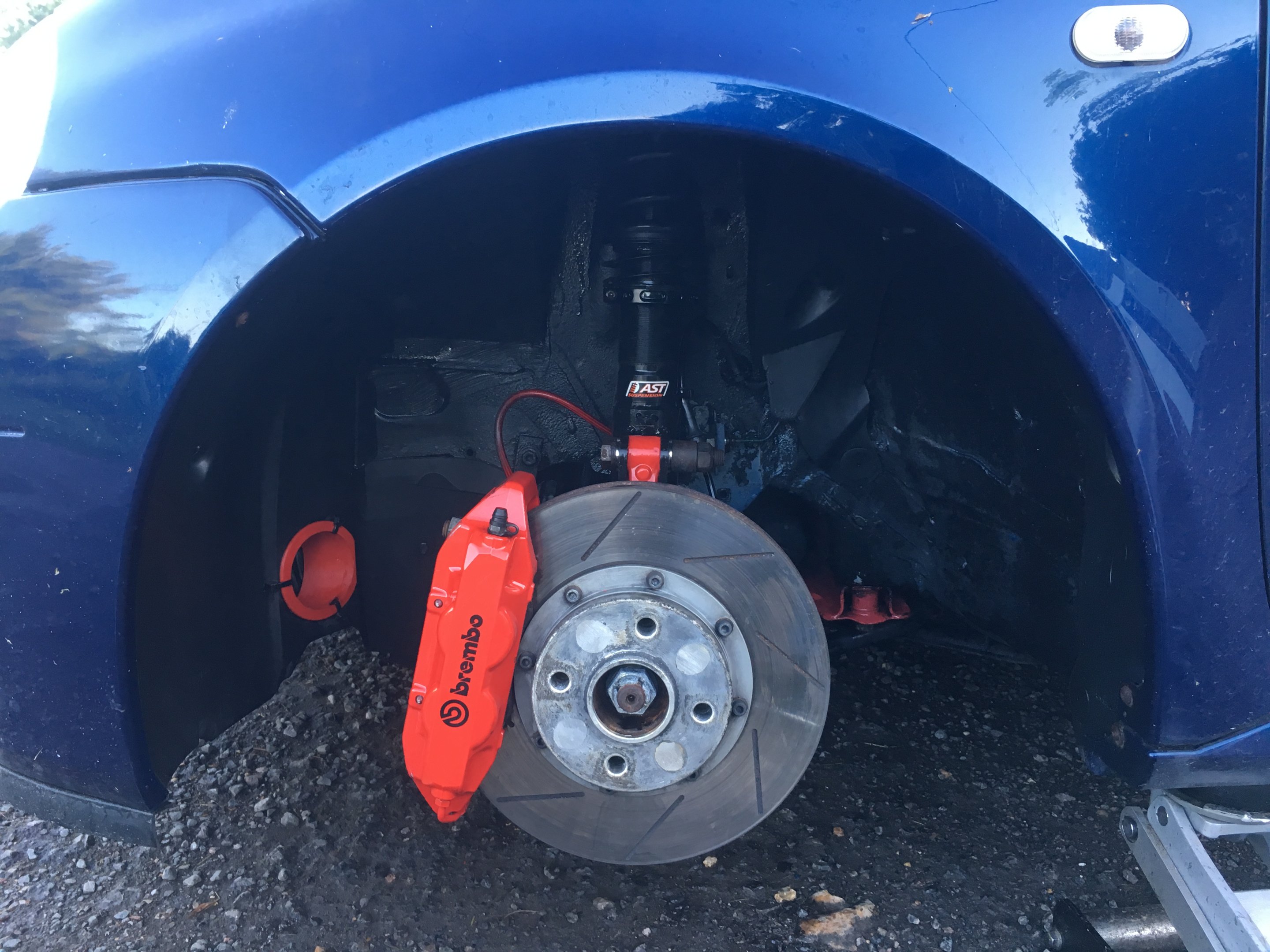

My front set up
I’ve got a ducting kit off eBay. They just let fresh air into the wheel well. BYC make a kit that fits directly onto the front caliper..looks a real decent bit of kit

Nice brake kit you have there ?
I was looking at the BYC cooling but my concern is where to run the ducting. I can't see anything but issues with that set up with the tyres fouling the ducting pipe when turning or on lock...
I think with the larger Brembo's you will be ok for cooling with just having the fog lights and inner arch plastics removed.
I did think this as I found the brembos very good at dissipating heat from them. I think I will just opt for the PMS/eBay setup

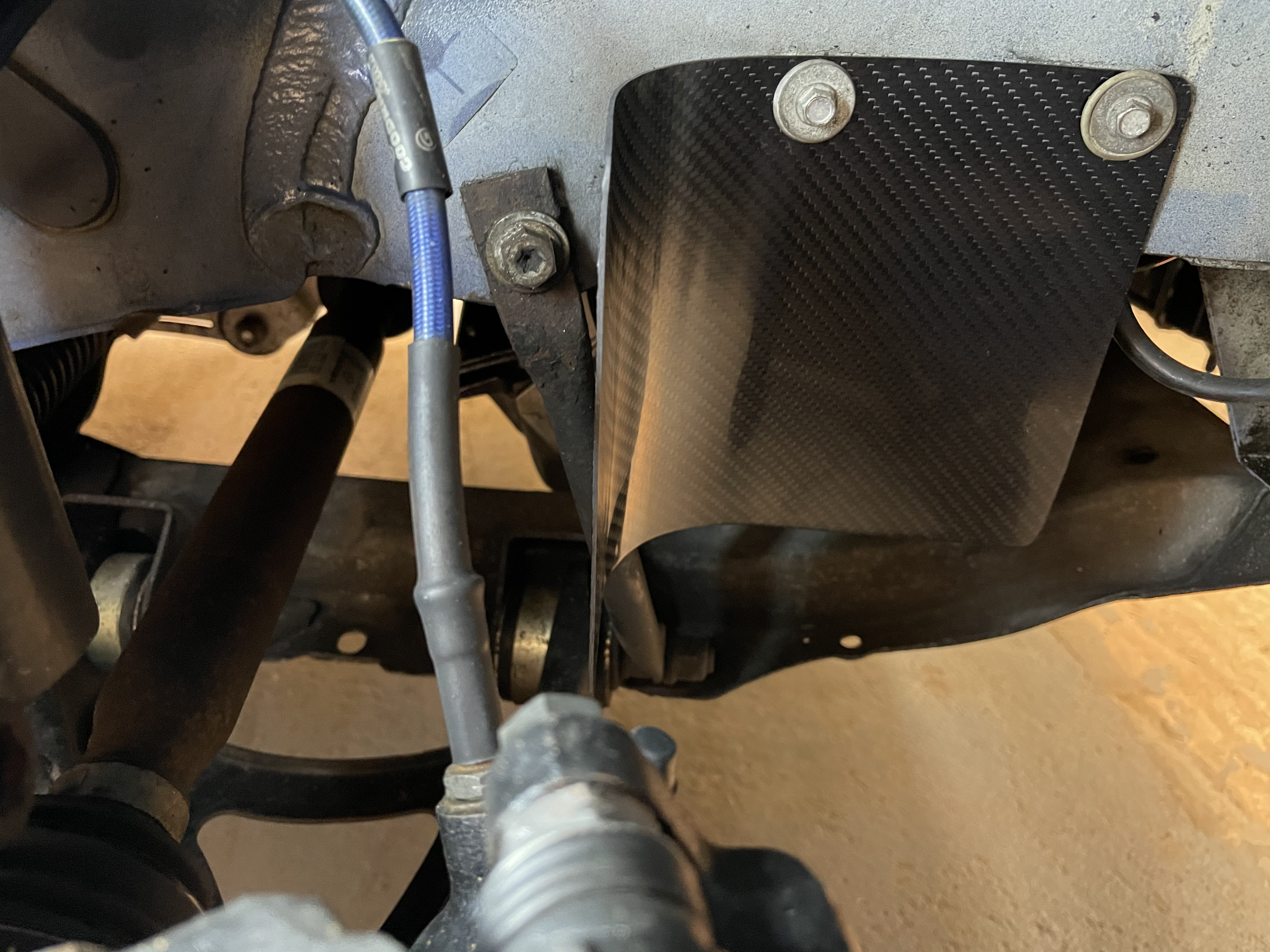

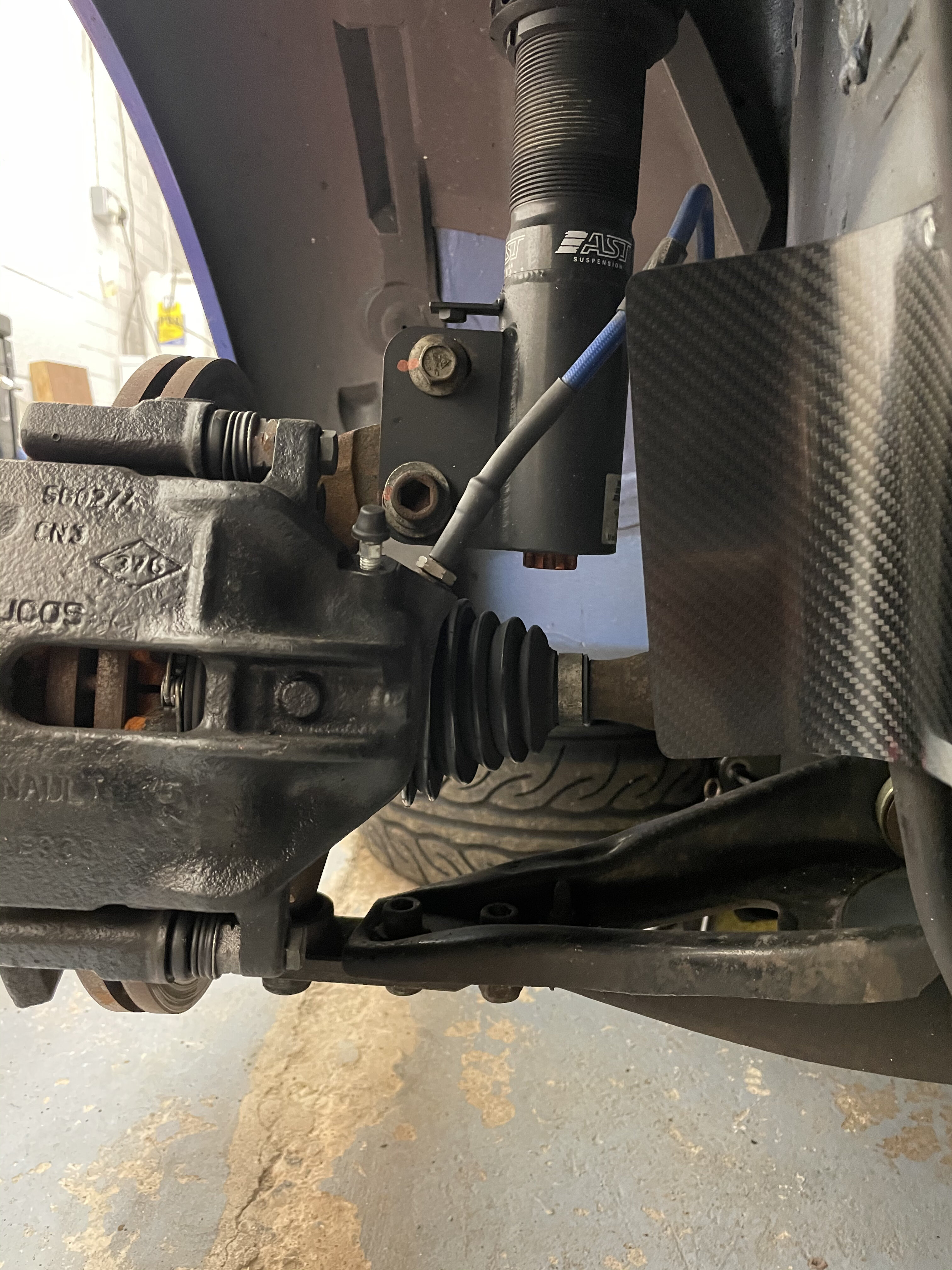

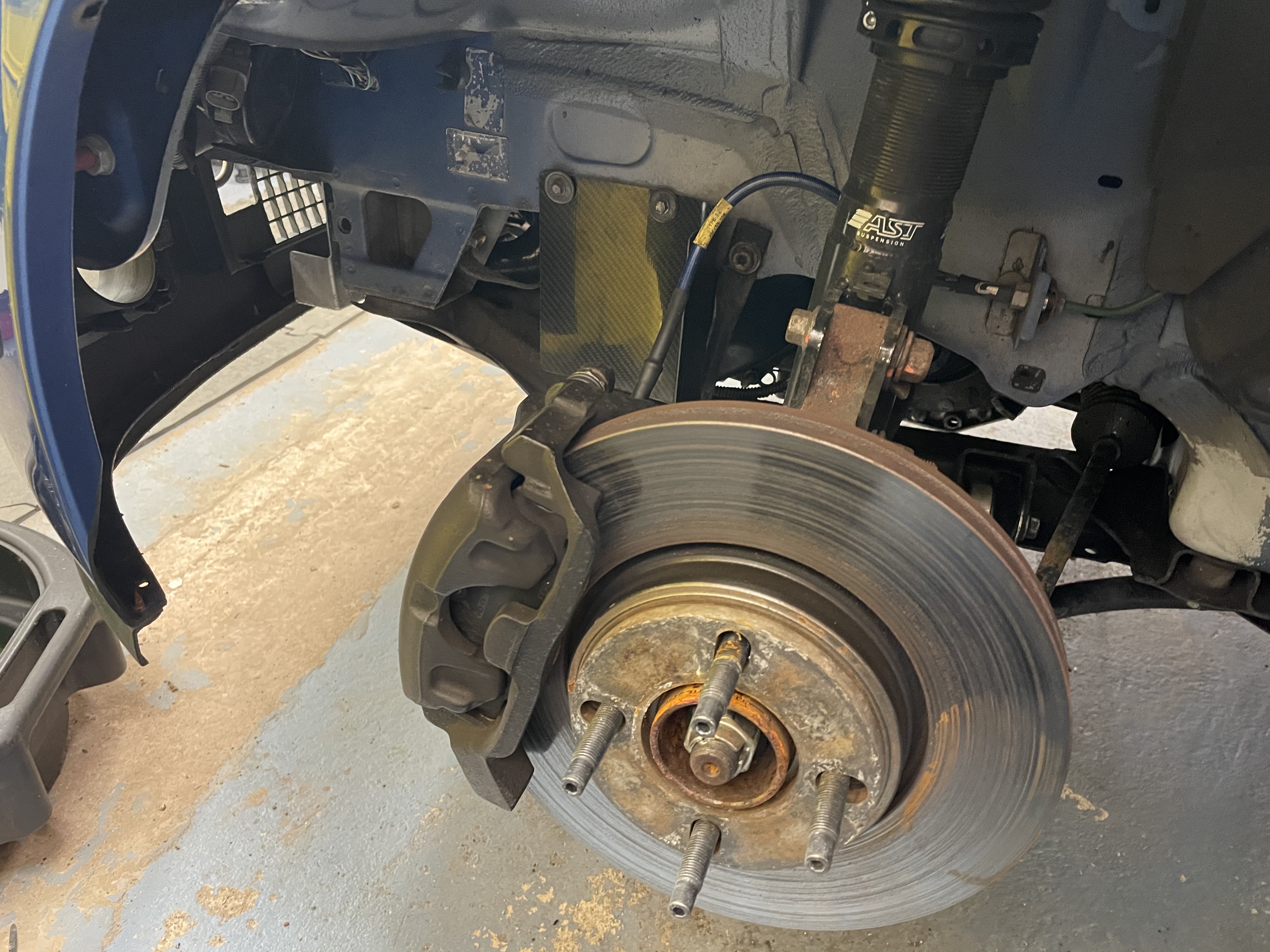

Only other thing I use which isn’t mentioned is some cup racer style air deflectors mounted to the inner arch to divert the air towards the disc.
Wiith larger front brakes (Ceika 6 pot in my case) just removing the fog lights and arch linings has meant that I have had no brake cooling issues, without any ducting.
This includes Lydden Hill in the summer, which has no straights to cool the brakes, just accelerate and brake as hard as possible for 20 minutes straight, so quite a good test.
So I would agree with Kev@KAM just open up the airflow through the fog holes.
Maybe not the most aerodynamic solution, but it's a Clio, not slippery sports car!

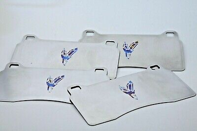

Just having the caliper made out of aluminium is a lot better than cast steel.
Fit some titanium shims as well to keep the heat off the piston seals and transferring heat into the fluid.
Where can you get these from?

In my experience yes.
Definitely keeps the pedal feeling firmer, which means less heat is being transferred into the fluid.
And it saves your piston seals from melting.
Very interesting, wouldn’t have thought it would be that noticeable.
JamesBryan
It delays the heat long enough for it to be cooled.
I can't remember the figures, but i think they can stop upto 60°c. So if you're borderline boiling your fluid 60°c would make the difference.
