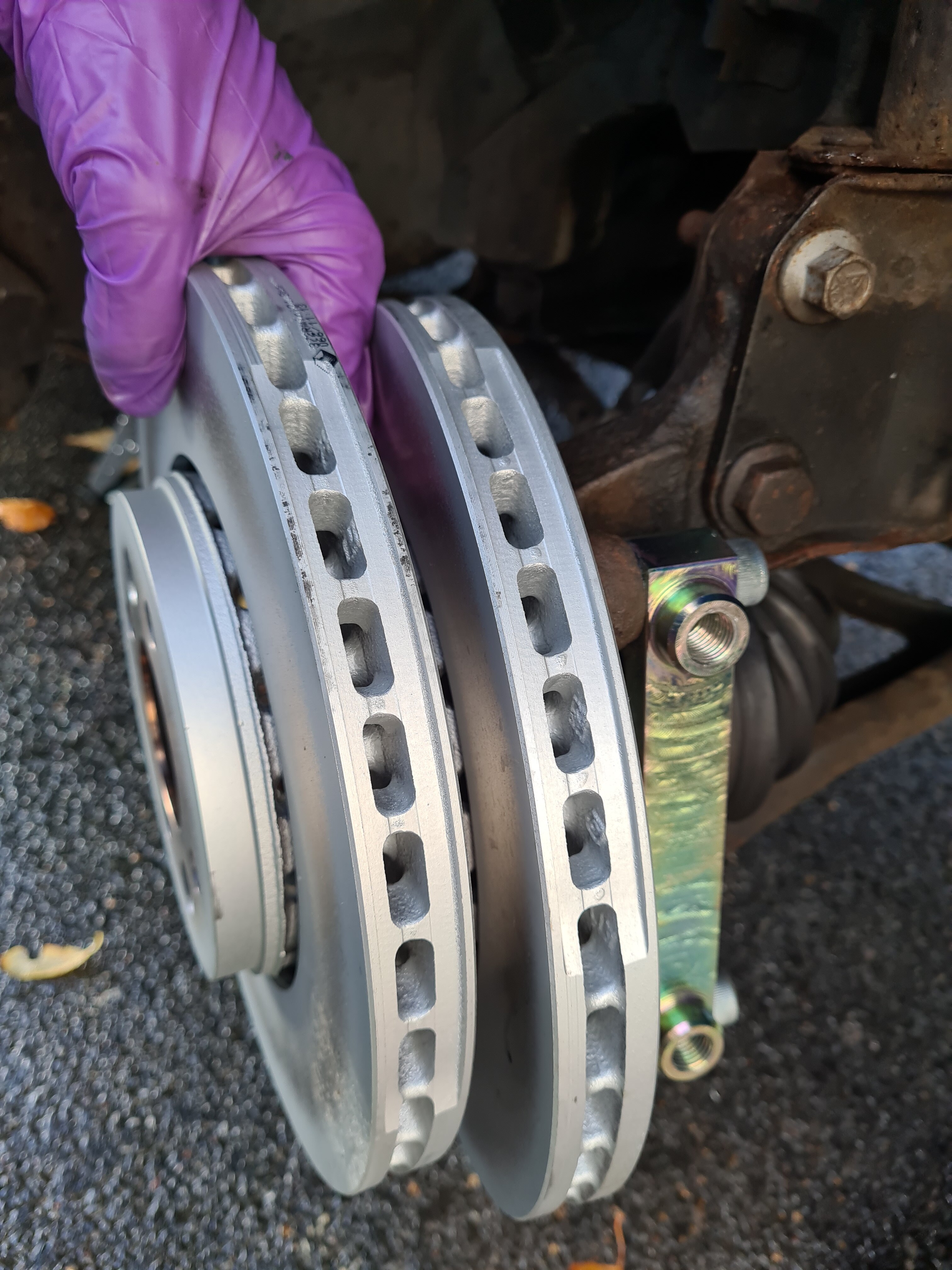

MLB ClioSport Club Member Nov 22, 2022 #1 Just fitting my new discs I noticed a grooved bit on the side of both discs, one slightly longer than the other. Does it mean anything? Not seen this on Brembo discs I've used before.
MarkCup ClioSport Club Member Car It's a hatchback Nov 22, 2022 #2 Isn't that where they've machined material away to balance it? Or is it techincally the 'wear' indicator? Or both? Or none?
J JackJack Nov 22, 2022 #3 I bought some discs from godspeed before and they had the same, guess it is a balancing thing.
MLB ClioSport Club Member Nov 22, 2022 #4 Yep I used the wrong terms in Google.. It is to reduce brake disc imbalance. Mill Balancing: Why Is There a Notch in My Brake Rotor? | PowerStop Is there a machined notch in your brake rotor? This is for mill balancing, which can reduce vibration and improve the life of your brake rotor. www.powerstop.com
PhillipM Car 406 V6, Race Buggy Nov 27, 2022 #5 It's both balance, and to break up squeal harmonics (which is why you sometimes see them in 2-3 spots the same depth)
