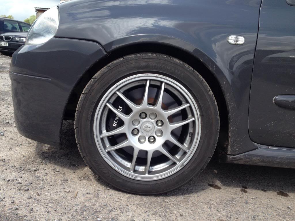

This is Scenic discs behind 15's on wilwood calipers.

My willwoods are on the redrilled 295 5 stud disks and fit under 15s with no spacers.
My tarox 6 pots use scenic 300mm disks but require big spacers, Im probably going to remake the brackets to use the 295 as well.
