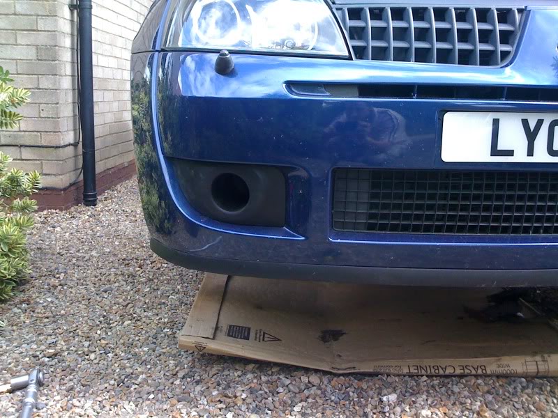

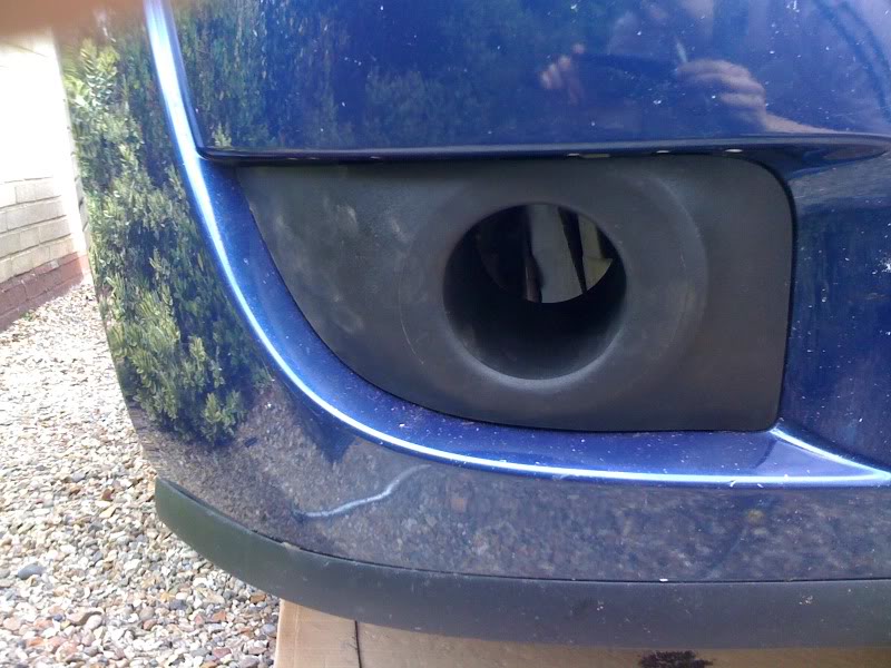

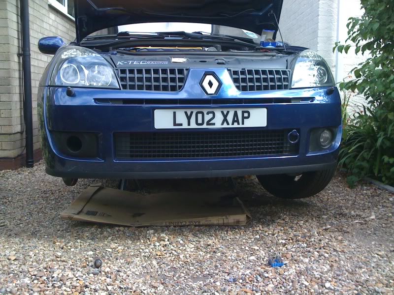

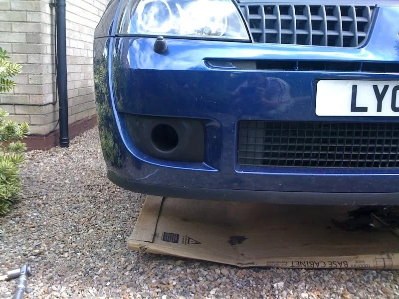

I've been searching for a while, but still can't find what I'm looking for! I'm after some close shots of any car that's had the cup racer brake ducts fitted. Also particularly interested in any pics of the deflector plates fitted inside the wheel arch.

Custom ones FTW ;)
http://www.cliosport.net/forum/showthread.php?t=442735&highlight=cooling
Havent done the deflector plate yet though.
Because I'm a lazy cnut!!!
No I lost the arch liner for that side a few months back and it made it easy to get too. Plus I wanted to see how the p38 held out. It has cracked slightly but I'm going to fill it back in and the respray them

The standard ducts are a bit hit and miss with moulding. I had mine extended to fit the gaps better. Bit of sealant around the outside makes them fit flush too.
Be careful with the deflector plates if you run much camber, as they'll hit the inside of the tyres on lock. I ran without the deflectors after a while to enable more sus adjustment.
