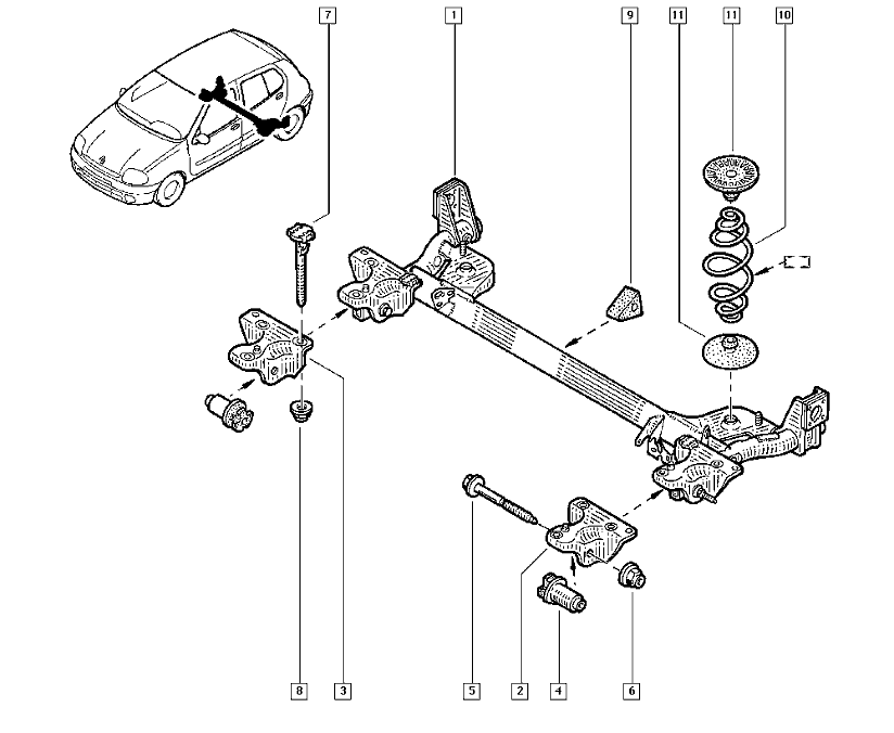

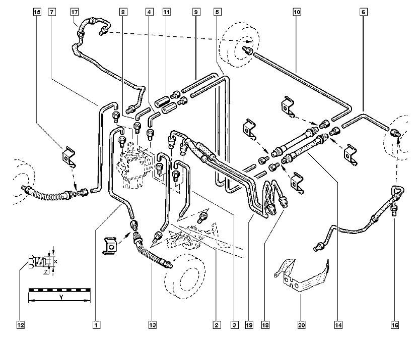

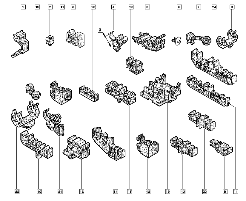

Before I strip the rear beam I want to get all the parts I'll need to replace ready, one part I cant seem to find is the metal clips that the flexi brake hoses attach into where they meet the beam bracket. What are they called and can they still be got from Renault?
@David James - I know was building up a rear beam so might be able to help?
I know I had trouble finding the rear beam bolts and nuts, so feel the clips might also be hard to source. Also good luck, the rear beam is a t**t!!!
8200646065 is the part number for the steel spring clips if that's what you're looking for?
