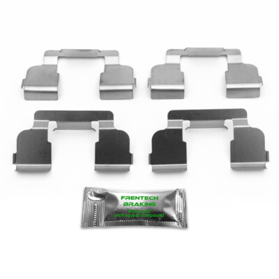

They're not usually listed as retaining clips so that's probably why you're struggling to find them
unfortunately that link doesnt ship to the US. Which is the most annoying problem. But, these look the same despite being for Clio II? I know they can share the same brakes as Mk1
Clio II Rattle Shims
