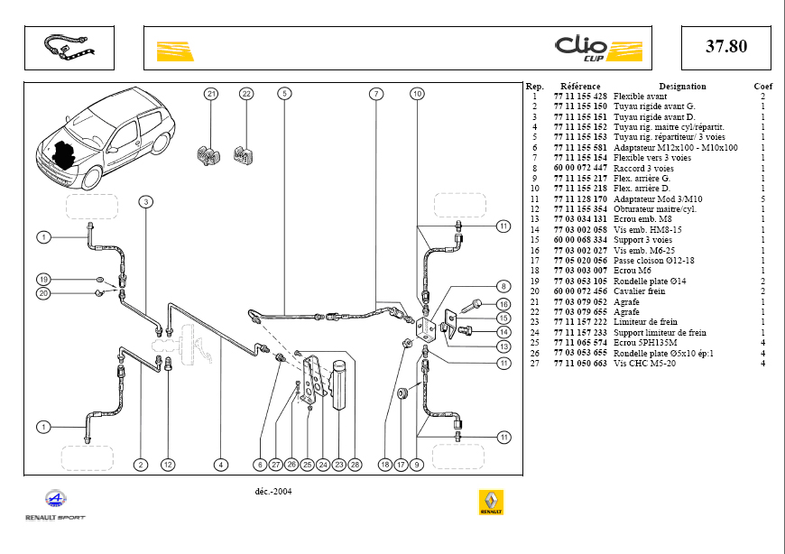

How do the ports work? You'e not accidentally got one front to the front brake, a rear to the other front and a rear to the two rears? Or are they split 25% each?
Standard cup master cylinder so split evenly between the 4 ports. Its all as per this diagram

Never heard of blocking one of the ports off, most just tee it instead. Saying that I had the same issue for ages with my track 182, after rebuilding the callipers, countless flushes and alignments I gave up and put it down to bad weight distribution (lighter on the NSF).

could it be due to the blanking off of one port ? Is it putting 50% through your front left and then 25% to front right and 25% to the rears pipe. I would have plumbed both rear ports into a T-peice and then run a single line through the car
No need for a T peice. The brakes are plumbed up as per renaultsport themselves do it, diagram below.
