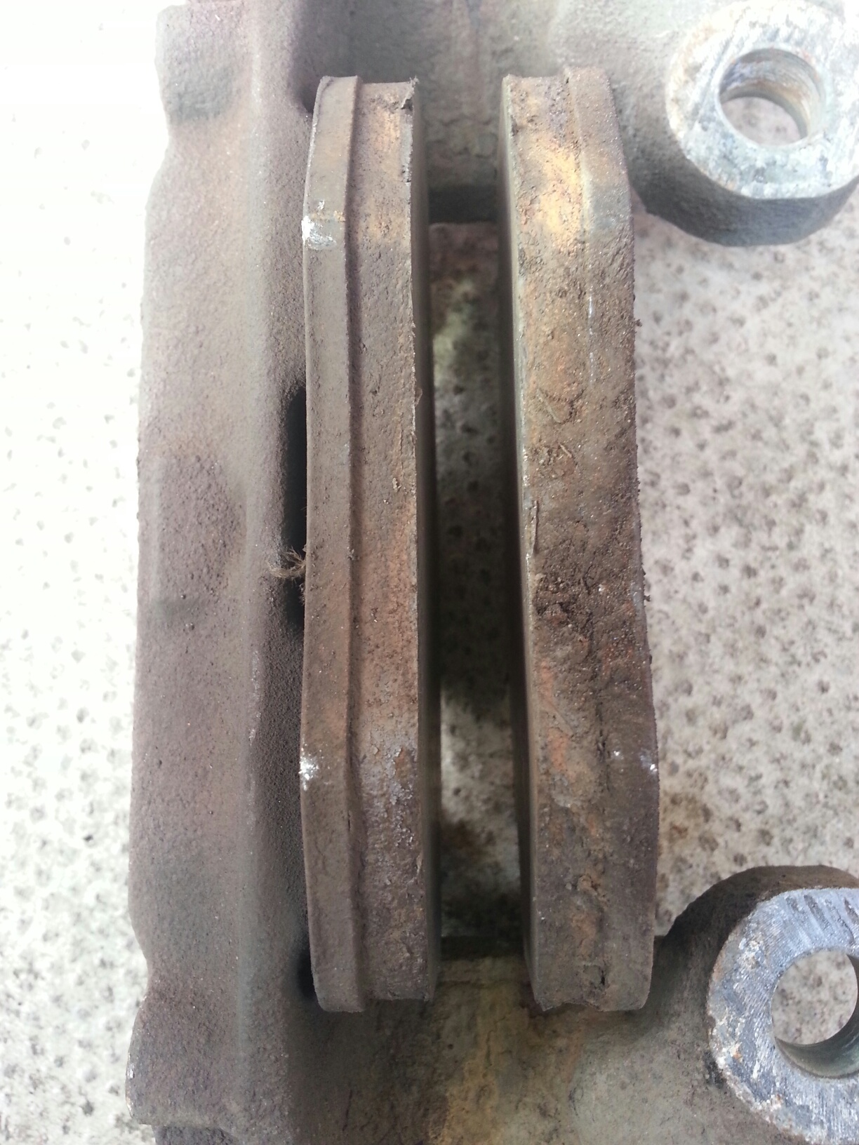

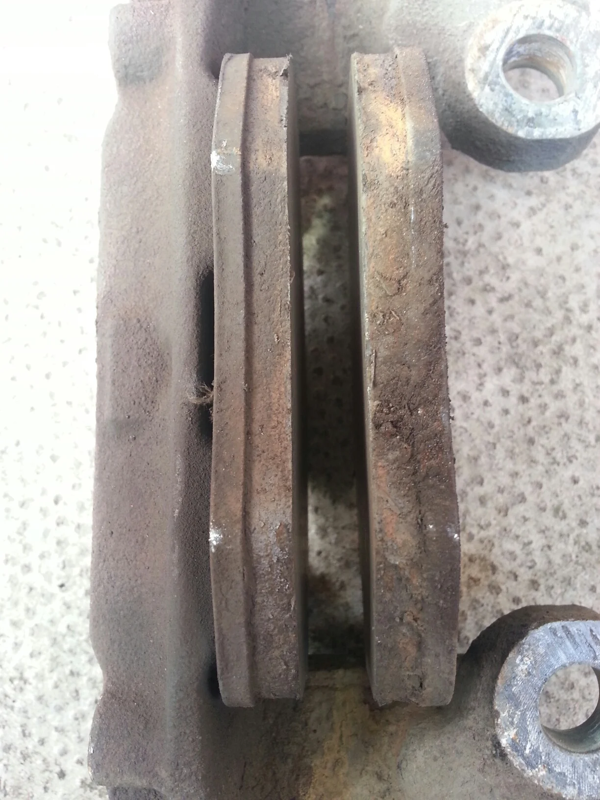

Hi guys. Recently when braking I have noticed a noise from the rear right brakes. Discs are quite new as I replaced both when the wheel bearings went. Do these pads look like there's enough life in them? I can't see anything else that might cause this noise. I wish I had replaced the pads when I did the discs, schoolboy error probably!

Looks to be life still left in them (although I personally always do new pads with new discs).
Have you cleaned up the carriers to ensure the pads are free to move?
Did you torque up the discs correctly?

Yeah the discs were torqued up correctly when I changed them. I'll give the carriers a good clean, probably a good idea while i'm at it eh
