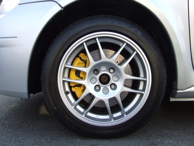

This is what i mean can i have this
  Lots of Alfas
Its calipers, the brake pads are the black bits you can see in the caliper.
Your best bet is spraying or painting them, I did mine at the weekend with heat resistant spray. There's also places like http://www.biggred.co.uk/ that will refurbish them and powdercoat the colour.

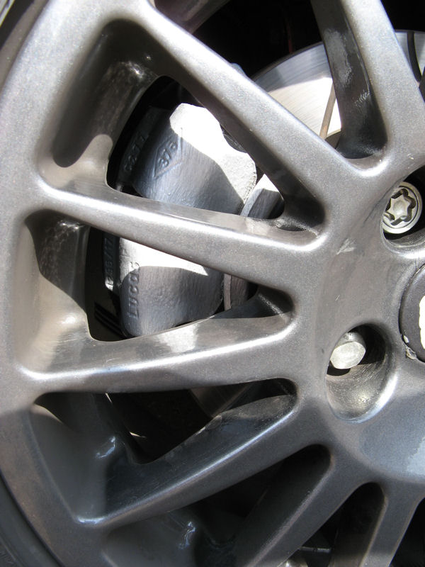

Did mine myself, its a piece of piss hardest part is getting the wheels off. I've used hammerite silver smooth as a lot of people on here have and i've had no problems. You can either take the calipers off and paint them like that or be lazy and be careful and paint them insitue.
