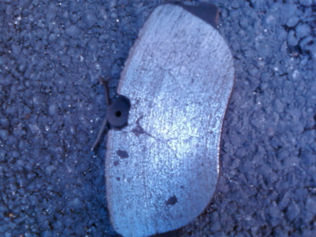

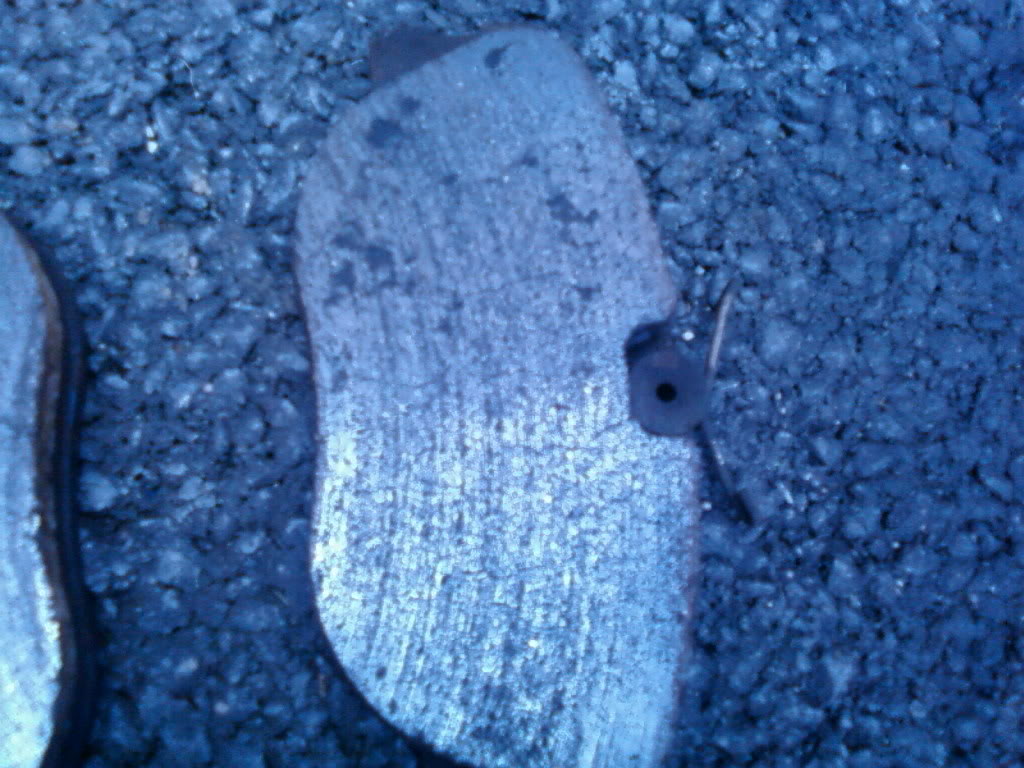

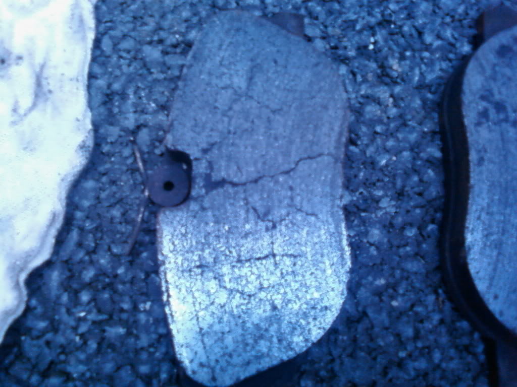

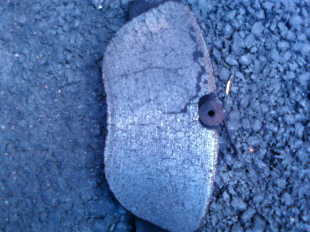

tokk me pads out after some some strange vibrations from the front left of the car and this what they looked like im gus=essing that they are fucked now they are pagid 4-2 the blue ones and have been used with brembos max discs

oh sorry mate my mistake i though you meant the discs not the pads ill go and have a look but the are chucks missing out of the face of the pads.

If the pads have chunks missing and its causng them to be uneven/not flat, then i bet thats the issue. There is really only one of two things that can go wrong and youve already said the discs are fine. :| Unless the brakes are all fine and its another problem all together! :) good luck and keep us/me posted.
am gonna try putting my original pads in and try that see if it goes away
how does a set of pads crack though
