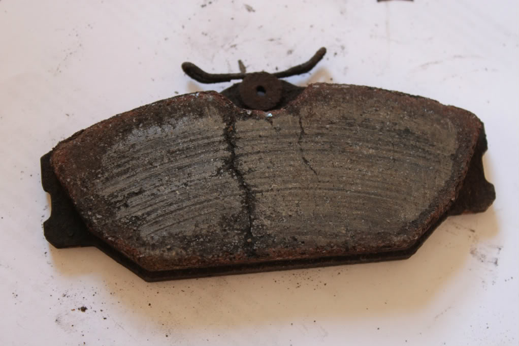

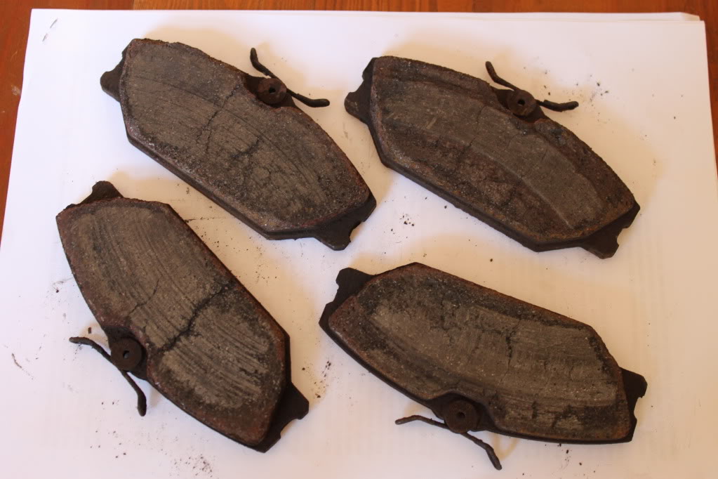

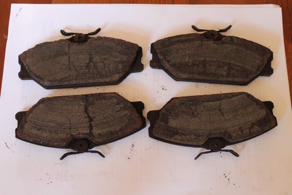

Fitted a new set of pads as my old ones felt like they were not giving their best. I now have a set of Mintex M1144's fitted and they feel great. The old pads that I took out were well past their best after around 4k miles and one track day, when I took them out I didn't expect them to be this bad though ! These are the Bosch pads that I removed, just goes to show that standard material pads aren't up to the abuse they get on circuit, they don't handle heat very well

6/10 i've seen worse!!
1144's aren't a good track pad by the way, they'll last about 5 laps before melting
