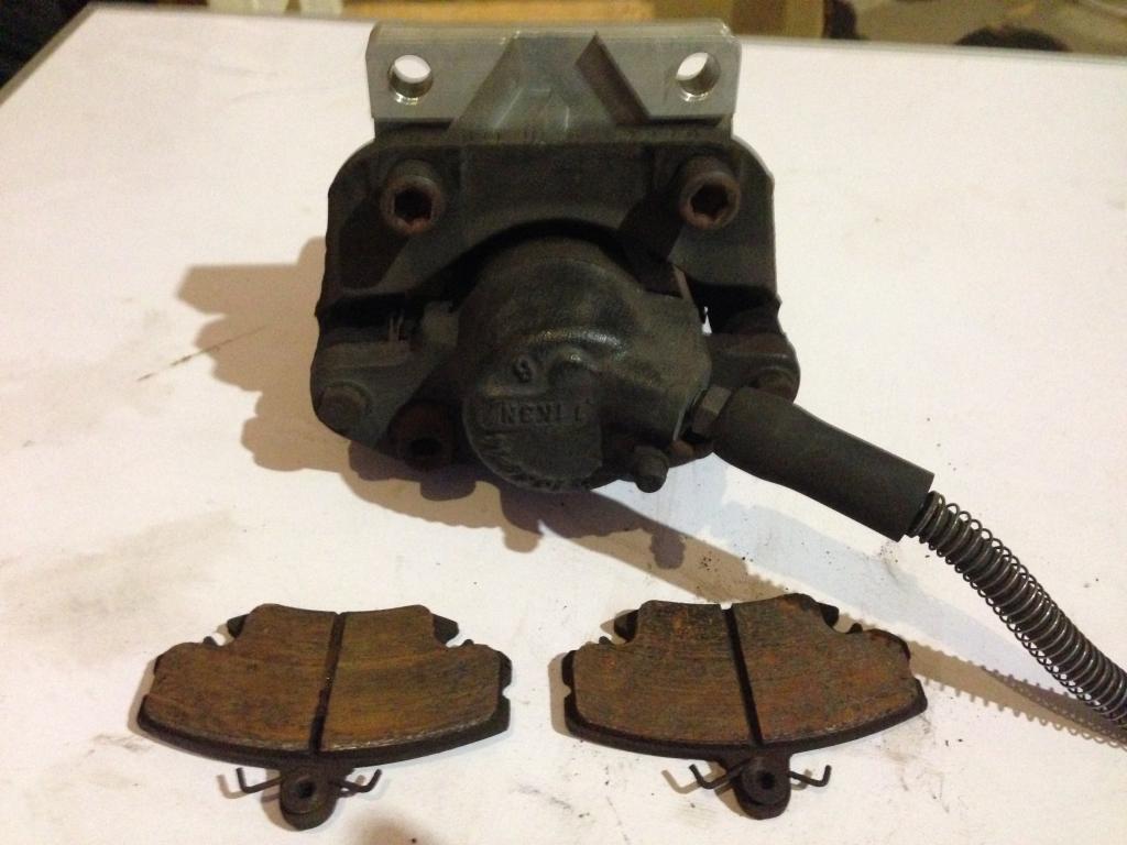

OK here's a few pics of the parts off the car. I bolted up one of my 285mm TXI Caliper Extenders to show that the Hub/Carrier bolt spacing is indeed the same.

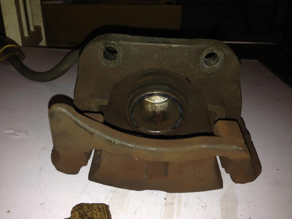

Here's the bit of the Carrier thats a little different, but I think it won't make any difference to fitment.

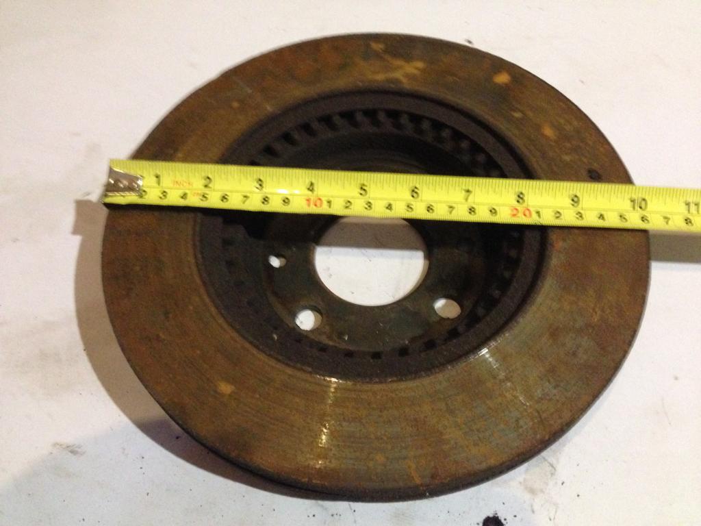

Here's the 259mm Disc complete with ABS timing ribs.
