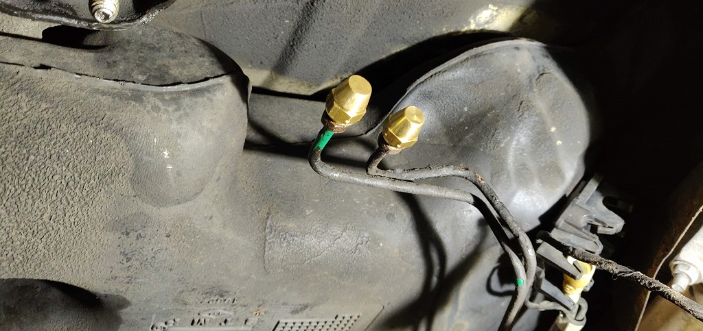

I just used these:
https://www.ebay.co.uk/itm/18262564...1L0K6CgZ9GW04VBi1g8pEEscShpcWxsRoCUTAQAvD_BwE
Left the car without rear calipers on while I messed about for 4 weeks ish. Realistically if your taking the beam out you'll be changing the brake lines :)
I think lines were £60 from caliper back to body (so eliminates the short one between body and beam). After 4 weeks with clamps on the system bled just fine. Those caps should work a treat too.

I just used these:
