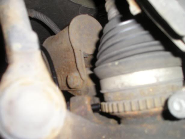

Its a metal ring with teeth that the abs sensor uses to determine if the wheel is moving/how fast. Although by the symptons you describe I dont think it is the rotors. iirc you will have to take the drum off for the rear, on the front it will be on the driveshafts.

The garage said yesterday that they checked these and they were fine.
I dont get why cleaning it in july worked and a new sensor has caused more problems.
Do you think there could be a problem wiith the driveshaft? if the rings are fine??

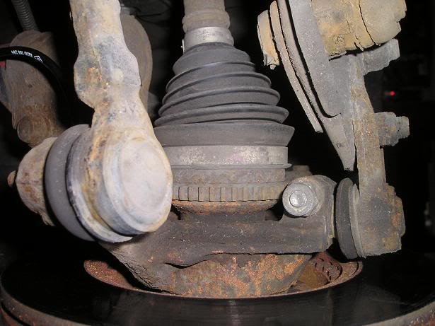

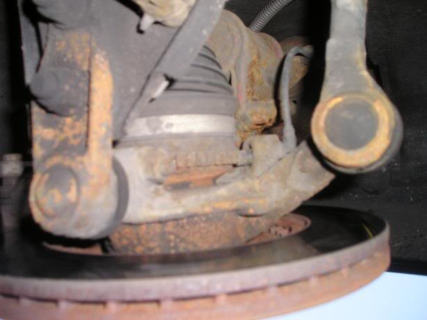

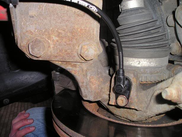

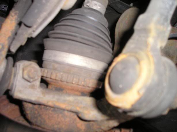

Here are some photos of the two front wheels. The ABS sensor was replaced on the passenger front wheel.
passenger front side
drivers front side
Steve
  Lots of Alfas
It all looks fine to me, I thought if renault stick it on there computer they can diagnose abs faults quite easily?

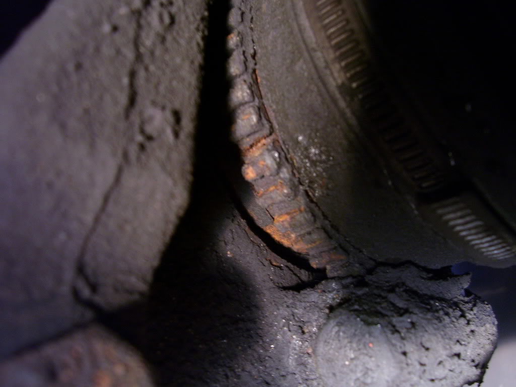

  Iceburg 172FF

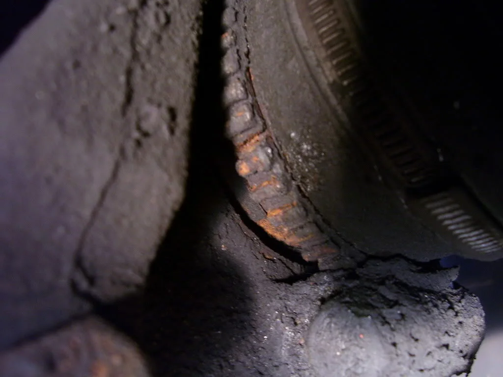

Had the same problem, after numerous visits to the garage they couldnt diagnose the problem. Ended up taking this pic and going in and showing it to them and saying change that you numptys, which sorted it right out.

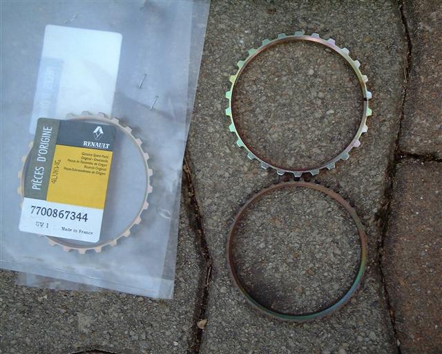

How much are these abs sensor rings?
Also what is the part number for these?
