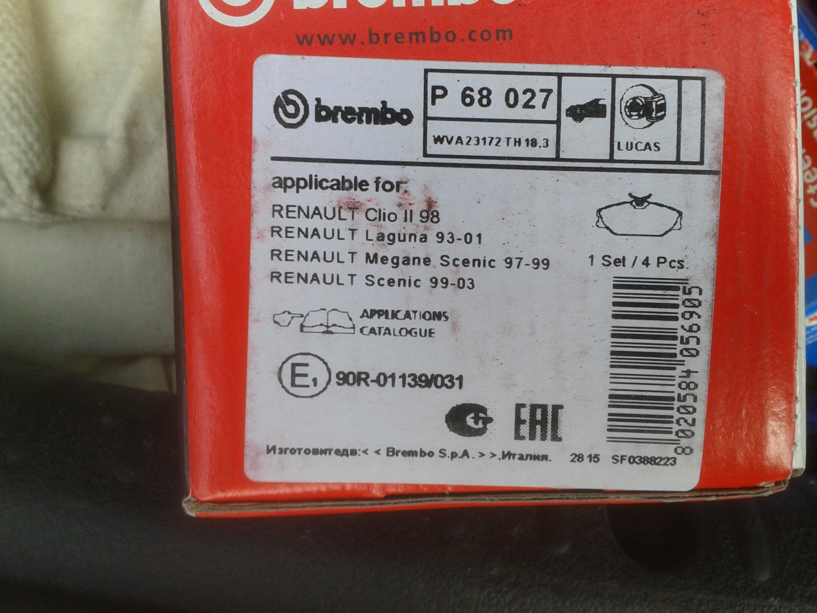

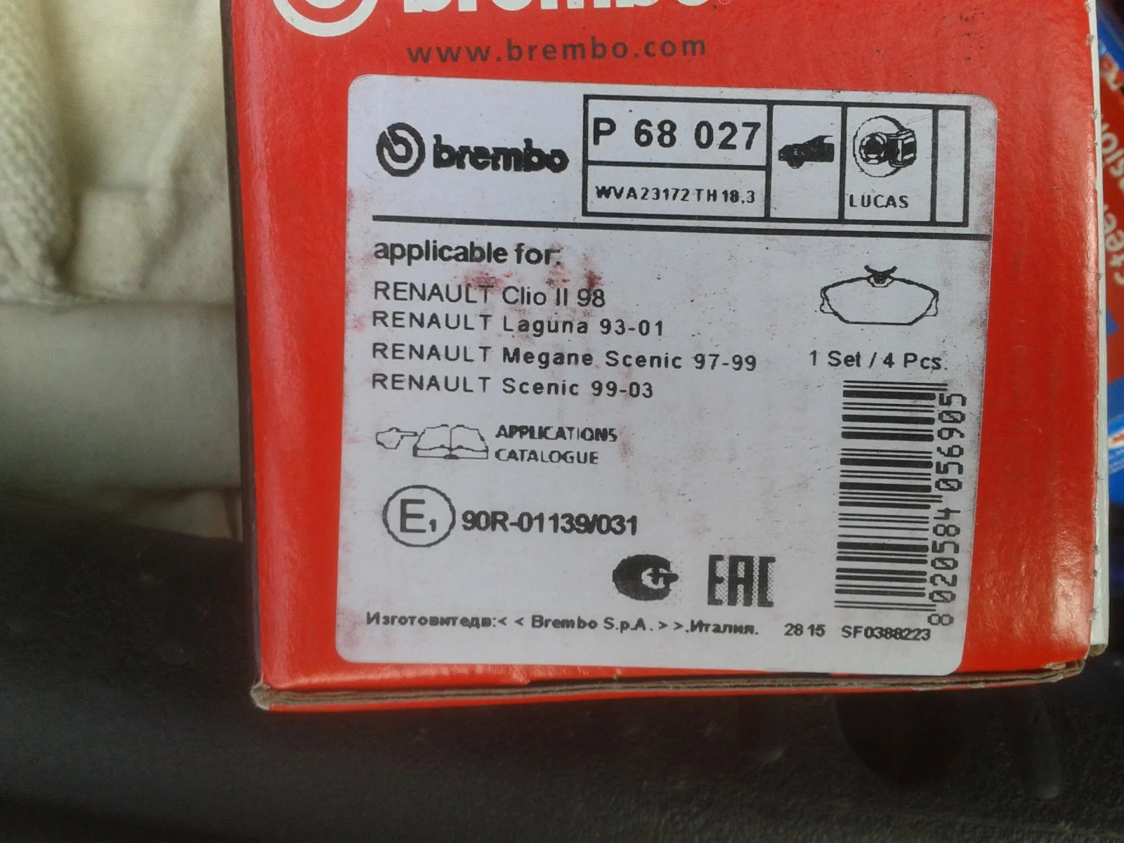

Remove the DS2500`s or whatever track orientated pads that have been fitted, and replace with standard Brembo items.
I'd say lower the tyre pressures first off, should be around 30/30 with PS3s, you only need higher pressures with soft side wall tyres like Rainsports. Maybe just get a set of Mintex M1144 pads coupled to Brembo HC discs if only used on the road, also new fluid, braided lines and maybe a caliper rebuild to get them back to optimum clamping.
