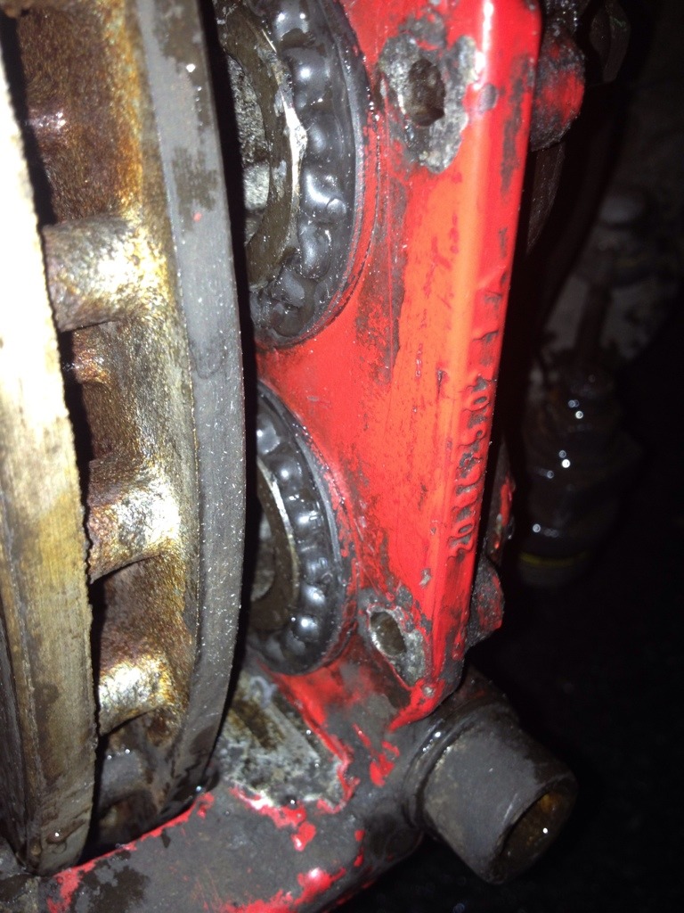

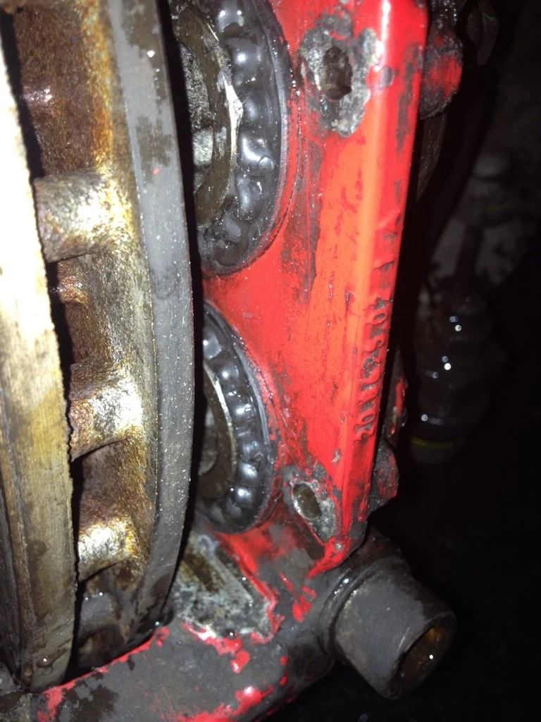

Probably never, however mine look to have reacted to something (maybe brake cleaner?) and have disformed (see below!) It's a good excuse to get them powder coated or painted also (and maybe some hel lines and ATE superblue)
I'd say that's from heat as they have bubbled up
I've seen quite a few like that
