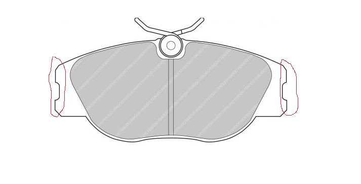

did you file down the back plates and remove the pad shims from the carrier?

you have to grind down the metal back plate of the pad as shown below
also in the existing pad carrier you will find 2 shims (polished metal inserts) these MUST be removed
the pad must be able to move vetrically by 1mm
Managed today to find time and look at the things. The pads were filed, but not enough, they were moving with quite a bit of effort. Took a file and worked a bit on them so that they move easily and also removed the shims and everything looks ok now.
