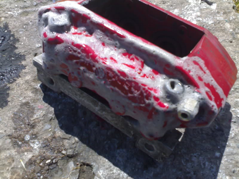

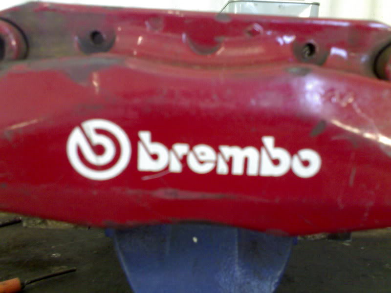

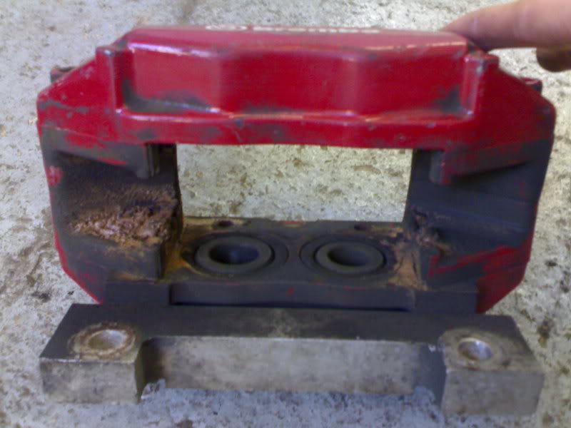

When they arrived, looking a little bit tired and shitted up :

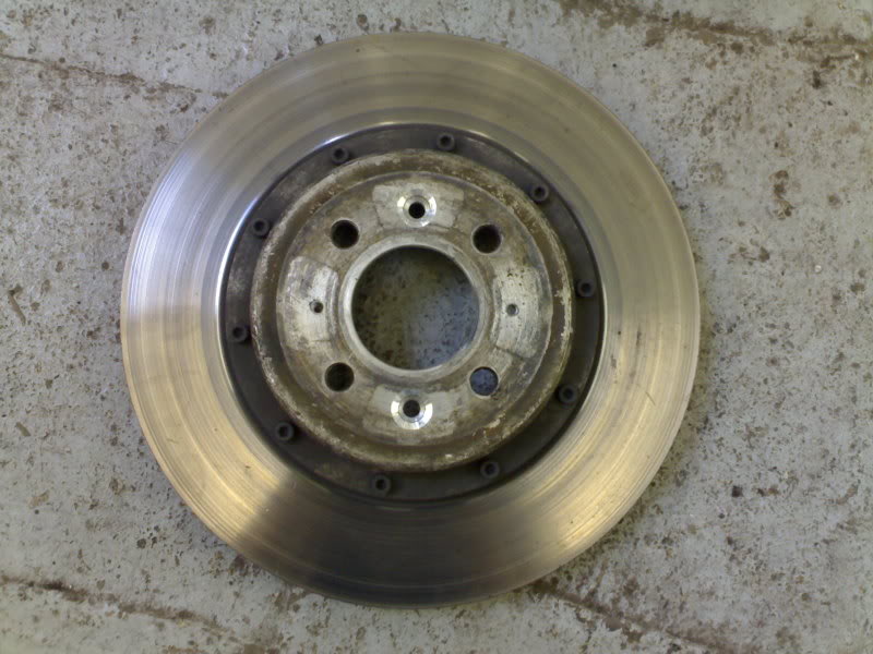

The shall we say well worn discs! ( matt had his moneys worth, these should be grooved!!!)
So, scraped all the s**t out best i could, then got some neat TFR and gave them a bath!

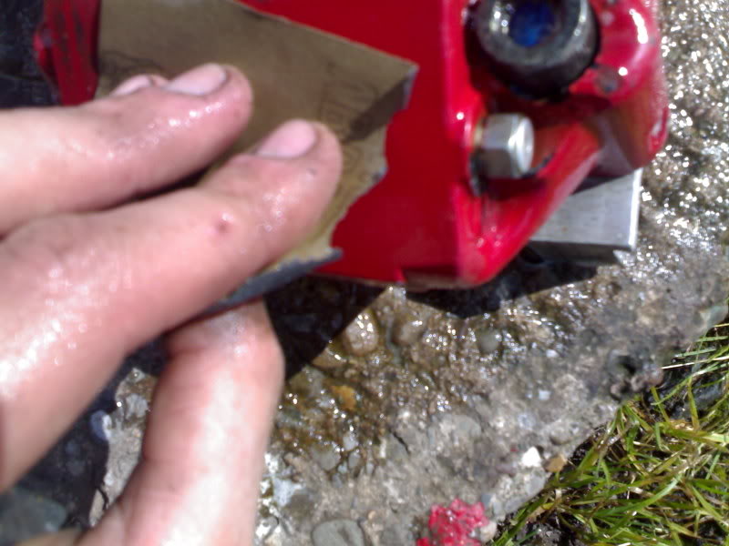

Quick wet & dry, all the holes blanked off accordingly!

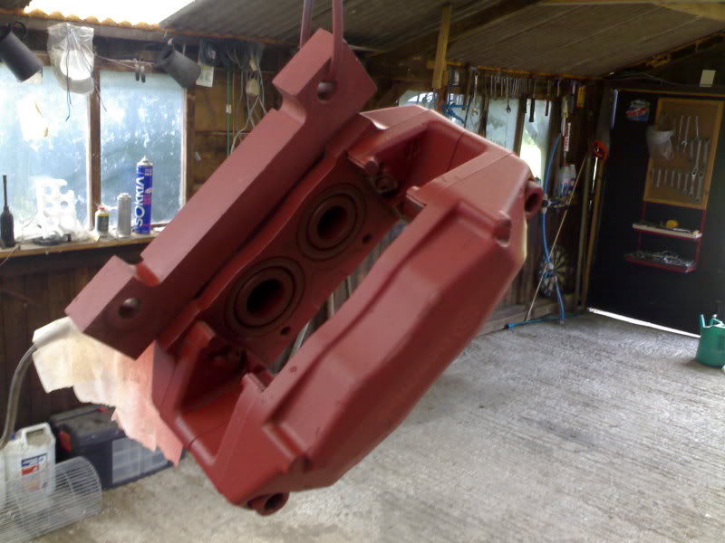

Then gave them a good wipe over with some panel wipe before a good few coats of high build primer :

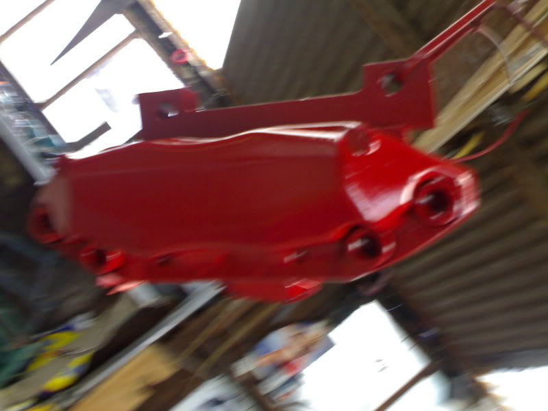

Left to harden for a while, then top coat, hammerite smooth red (bit of a blurry pic) :
Then i had some new stickers made up, £5 the pair, stuck them on, then plenty of coats of lacquer over the stickers!

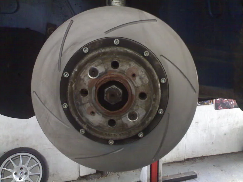

The new discs, £260 had to have them though!! :

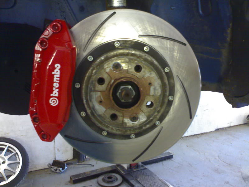

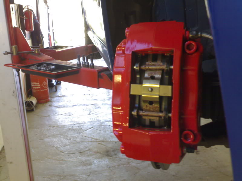

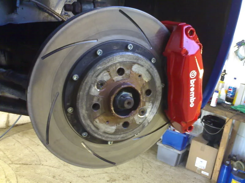

Then final fit time, took a bit of playing about, they came with wheel spacers, which i didnt need on the cup, had to have some 10MM spacers made up at the local smithy, freebie! , also had to get new caliper bolts which was fun, getting the correct thread for the hub, as mine werent long enough with the spacers, courtesy of a friend of a friend in the end! Brake pads are borrowed, didnt want to spend £80 on a set from godspeed, so went to the local motor factors, who sorted me a set from a jaguar! same fitment, £22 much better! will replace them for uprated if everything works ok! :

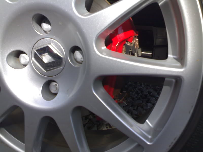

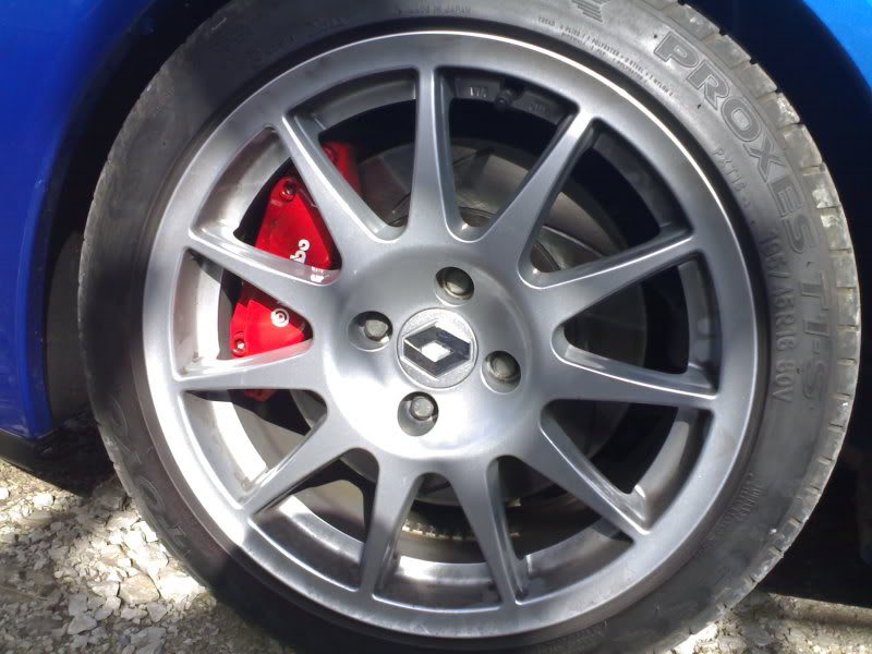

On the car behind the wheel :

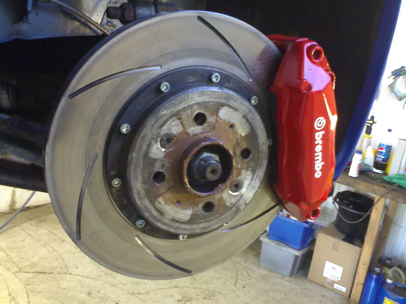

The rears, removed them and painted them with the same paint to match :
Done 15 miles so far, nothings fell off! which is good!!!
