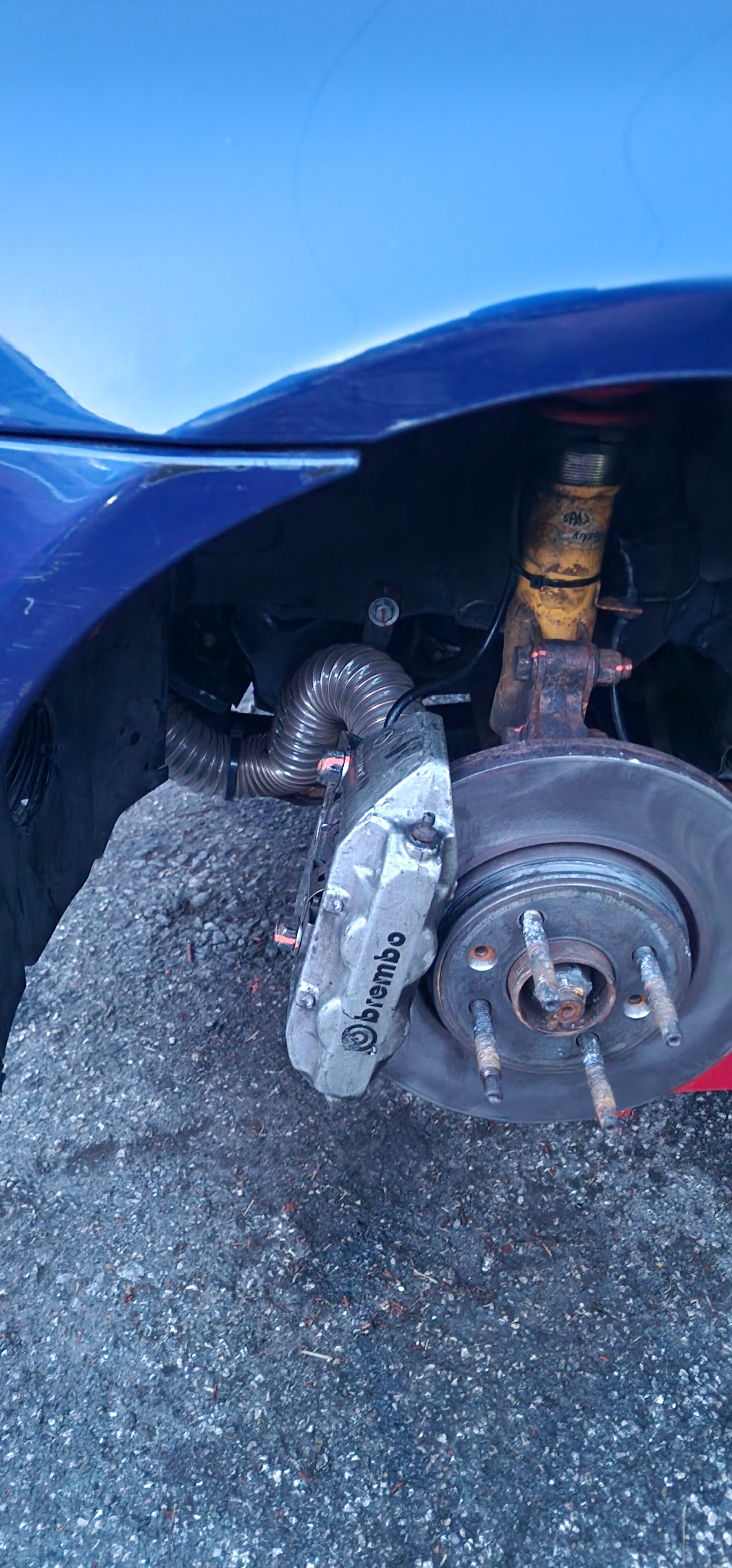

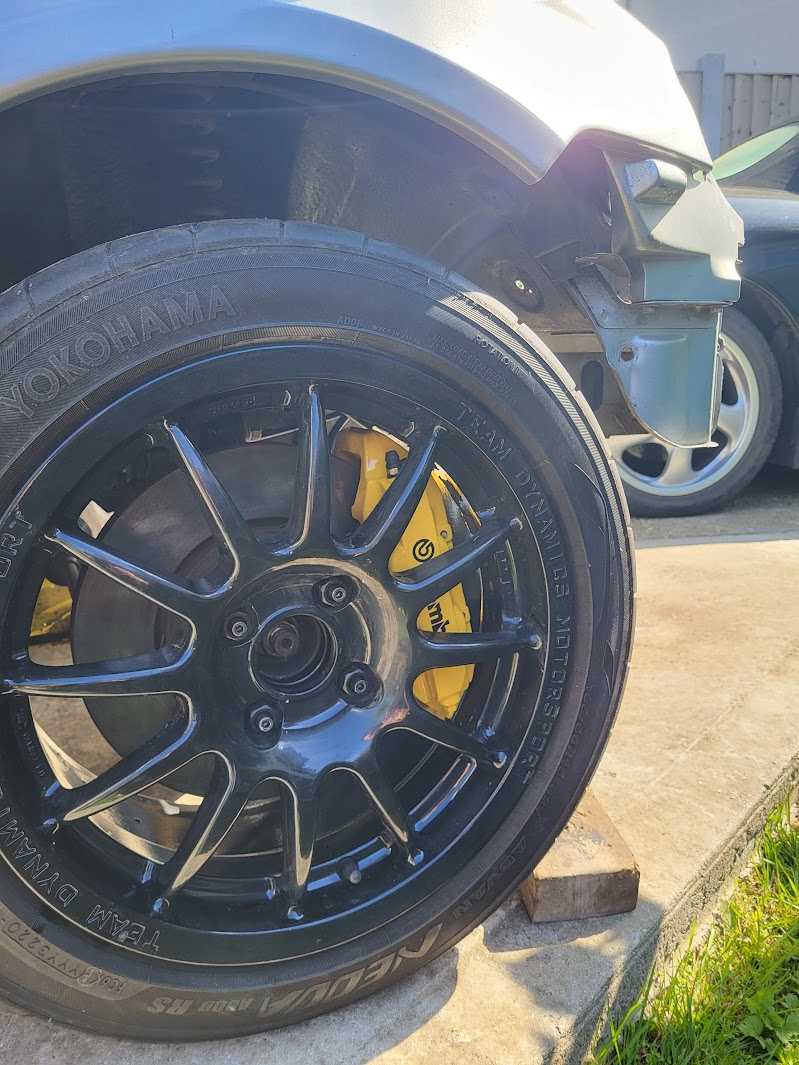

I could never get on with the standard callipers. Brembo all the way with either DS1.11 or RC5+
I opted for Brembo over Wilwood for a larger pad area. But the Wilwood being smaller gives you more wheel clearance.

What spacers did you have to run to clear the wheels? Got 2118’s on mine with et43
I believe im running 20mm spacers with these.
Callipers need to get machined down slightly also.
No idea what is needed for the 2118s though, but i know its possible.
