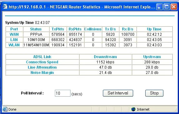

i found the Line Attenuation is downstream 47.0db and upstream is 29.0db, cant find the other settings i have a netgear dg834gt router
Suggests you line length is 2.5km - 3.0km long. Without SNR and your current sync it's impossible to say much more.

heres that page it says to go, this is where i got the Line Attenuation from, cant see any snr setting
You'll be ok for 3meg over IPstream and "should" be ok if for 4meg if there's a LLU supplier in your area.
(SNR is shown as "Noise Margin" on your router)
