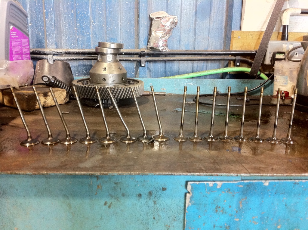

Broken belt idler.
Not quite a clio, but a scenic with a VVT F4R, belt was changed on time by a Renault dealer over in Wales that has since gone bankrupt. My suspicions are that they didn't change the idlers as the tensioner is like a roller skate bearing.
Could also be a non genuine one, I stupidly used one on my Williams engine as I wanted one in a hurry and renault were saying days till they could get it.
It lasted sub 2K miles :(
