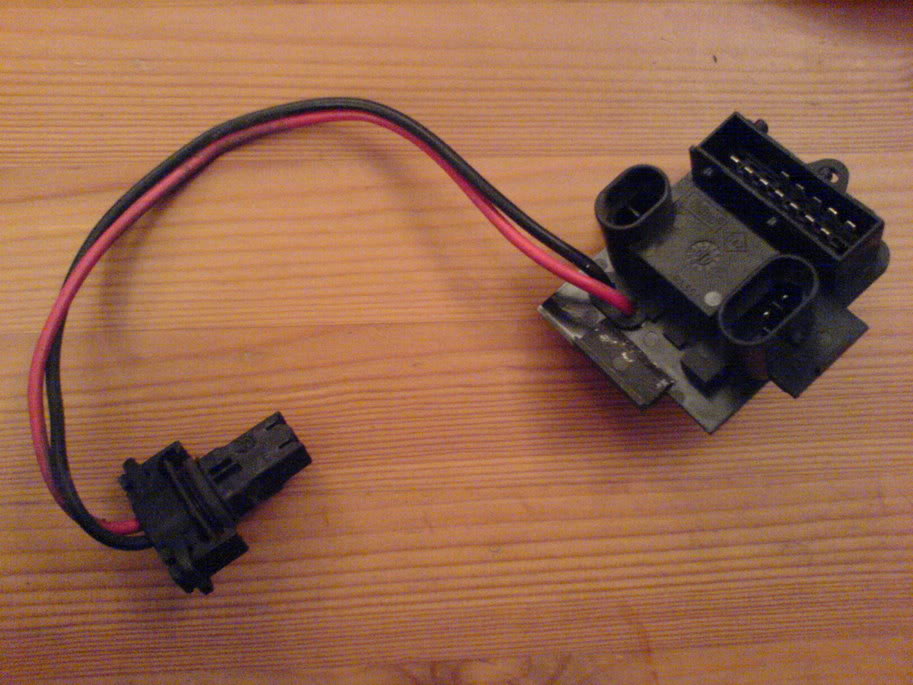

just taken the car apart!
this thing??
mine's as rusty as hell LOL
  1.6 focus zetec....
Alrite fred maybe somthing i can help You on for a change instead of you helping me lol. I had this problem a few weeks ago...checked all fuses and that lil plug thing that youve got a picture up of so i went to a garage...they took the plastic bit off below my window and underneath is a medium size black box in like a round shape, they gave that a smack with the mallet and hey presto on come the heaters...just the fan got jammed!

i think thats what happened, my fan has jammed and then burn't out the resistor (its been knackered since last winter lol, but i've only recently been bothered to fix it!!)

thats the part fred - also common for motor to knock the resistor out --- give me you vehicle details etc + type of heating and will get u a price on the parts as im at work!!

apparently the part number is 7701050736, and none of the dealers round here have one!! c**t
  2.0 175dci rs meggy
well i have come up with a part # for the resistor of 7701050900 - 55.00 all in
and motor 7701050899 - 103.83 all in
they have given you the wrong part number as the 7701050736 is for a clio with normal heating not recycled heating!!

i have had this problem before due to the normal heat and recycled heat - but see what he supplys!!!! always go for the same make ie valeo 4 valeo etc - u will prob find a denso will not fit any way - but im positive that if you have recycled heat (the button on panel) u will want the 77 01 05 900

The resistor is 68+vat, but check the connections to the fan, you can get your hand down the gap.
There is a choice on them, so best check with your local dealer, if it a BEHR resistor then they are approx 25 from GSF.
