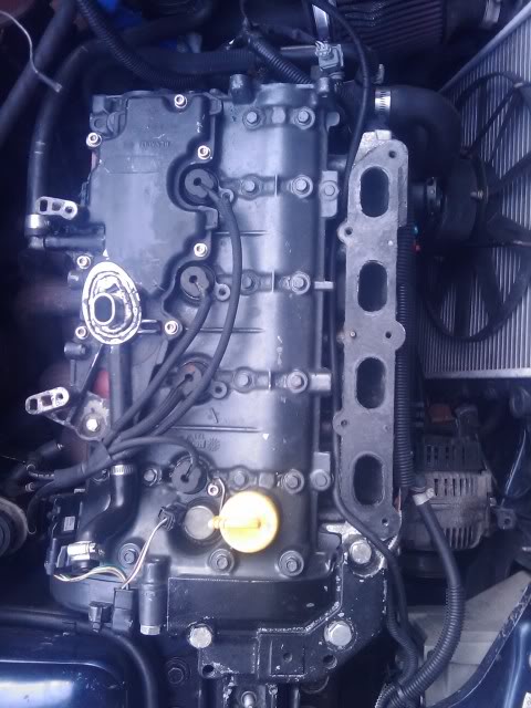

Right, had a quick look today, didnt have too much time. Took the inlet manifold off to see whats there basically.
Took a pic:
What ever i saw that could have got wet, i tried to dry. Is there anything else i can check?
