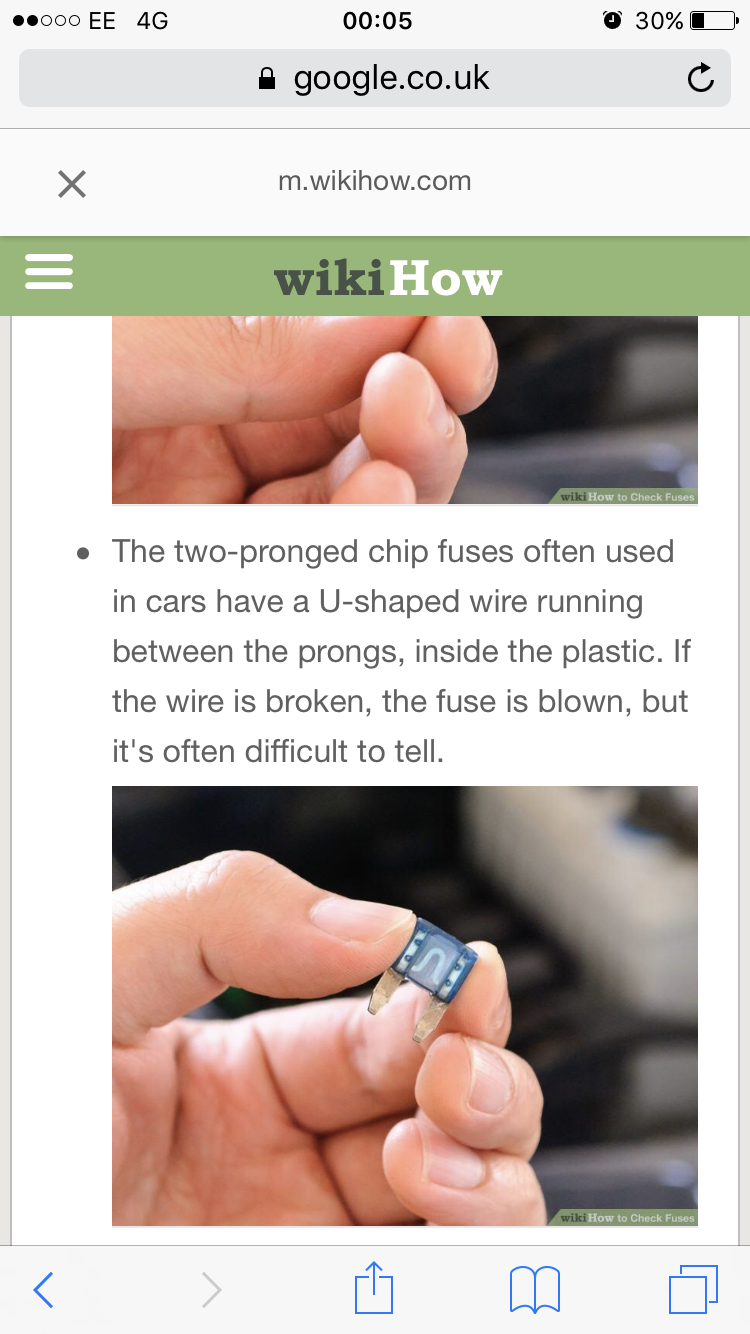

I'll have a look mate. Sorry to be stupid. When you say check the fuses, what am I looking for to recognise a broken one?
imprezaworks
  Mk5 Golf GTI :)
Multimeter is the easiest way. A device that will test each fuse in situ. Or removing the fuse and seeing if the internal wire is broke or visible signs it looks blown. And your not being daft mate, I struggled at sixth form, your in uni :)
Stay Puft
  Clio 172
I just have no mechanical knowledge at all, ive always just chucked my car to my mechanic friend and bought him a few beers after. My mum has bought me a tool set for xmas I think so im gonna try and learn a bit more. Just google'd how to check a fuse too, thanks mate.

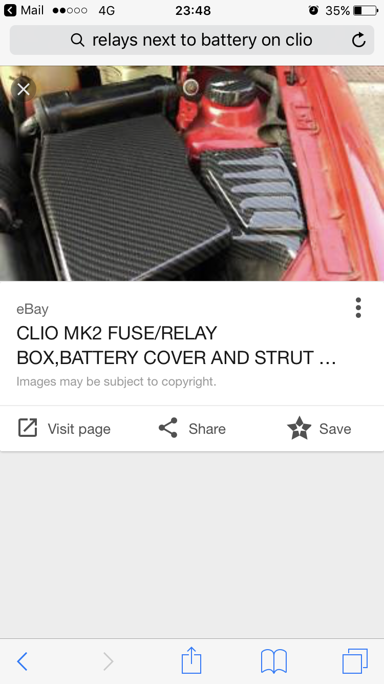

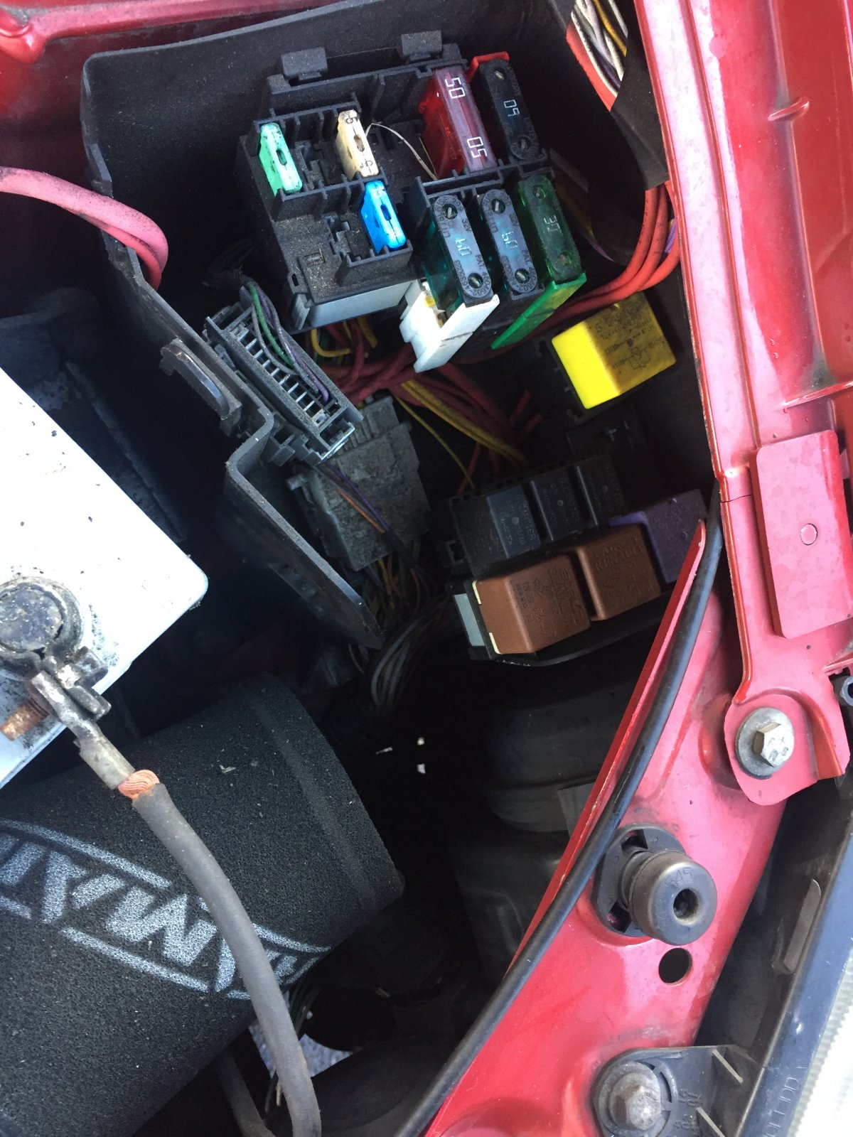

Just gone out, car started perfectly on the button about 10 times in a row, no issue. I still
cleaned up the battery terminals and pushed the positive down a bit. Negative wire seems to look okay and connected etc with no obvious corrosion. Opened the fuse box, but ive got no idea which one to look at. Are there any which directly link to the immoboliser?

It sounds very much like a poor earth issue.
Ideally you'll need a multimeter to check/prove each earths "condition" but as you've already said you have little mechanical knowledge, it may be worth sending it to Mike @ Rentech.
My guess is either the rear gearbox or behind the passenger headlamp is about ready to fall off.
