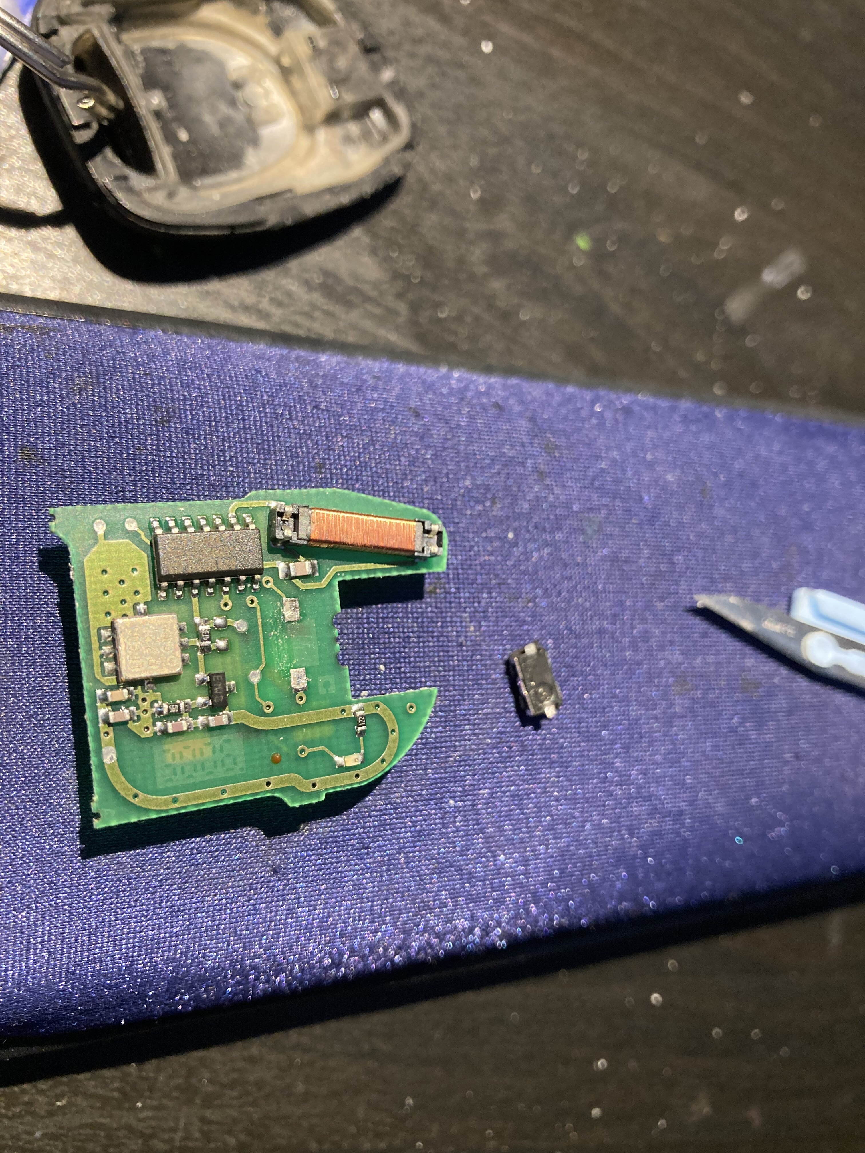

I can see that there are some glue(?) marks on the circuit board but they seem to be on the switch contact points as well. But when it was still hanging on it was on a dried up gel, similar to the seal on the switch side of the fob.
Am I right in believing the micro switch should be glued on the circuit board? I don’t have a soldering iron small enough to work on the switches contacts

Some conductive epoxy will work, you'd want the board fully reflowing in an ideal world
Can you not put some solder on the switch first and then try connecting it?
I’ve got a selection of tips for my soldering iron but even the smallest was a pain to use when I replaced the switch on mine.
If the board is knackered, you could buy a second hand fob, and just swap the transponder over and it will work like new.
Just desolder the transponder chip
Thanks guys I ended up cowboying it with some hobby grade green stuff to fix it onto the board. Not a pro job but I’m just happy to not be paying £200 for a key reprogram.
Out of interest Louis, did you mean electrical conductive epoxy or thermally. I’ve never used either but from what I learned from Google silver or zinc based epoxy conducts electricity but could feed a family for a week. Thermally conductive stuff looks like it would be good for fixing the switch back to the board but not by the contact points?
