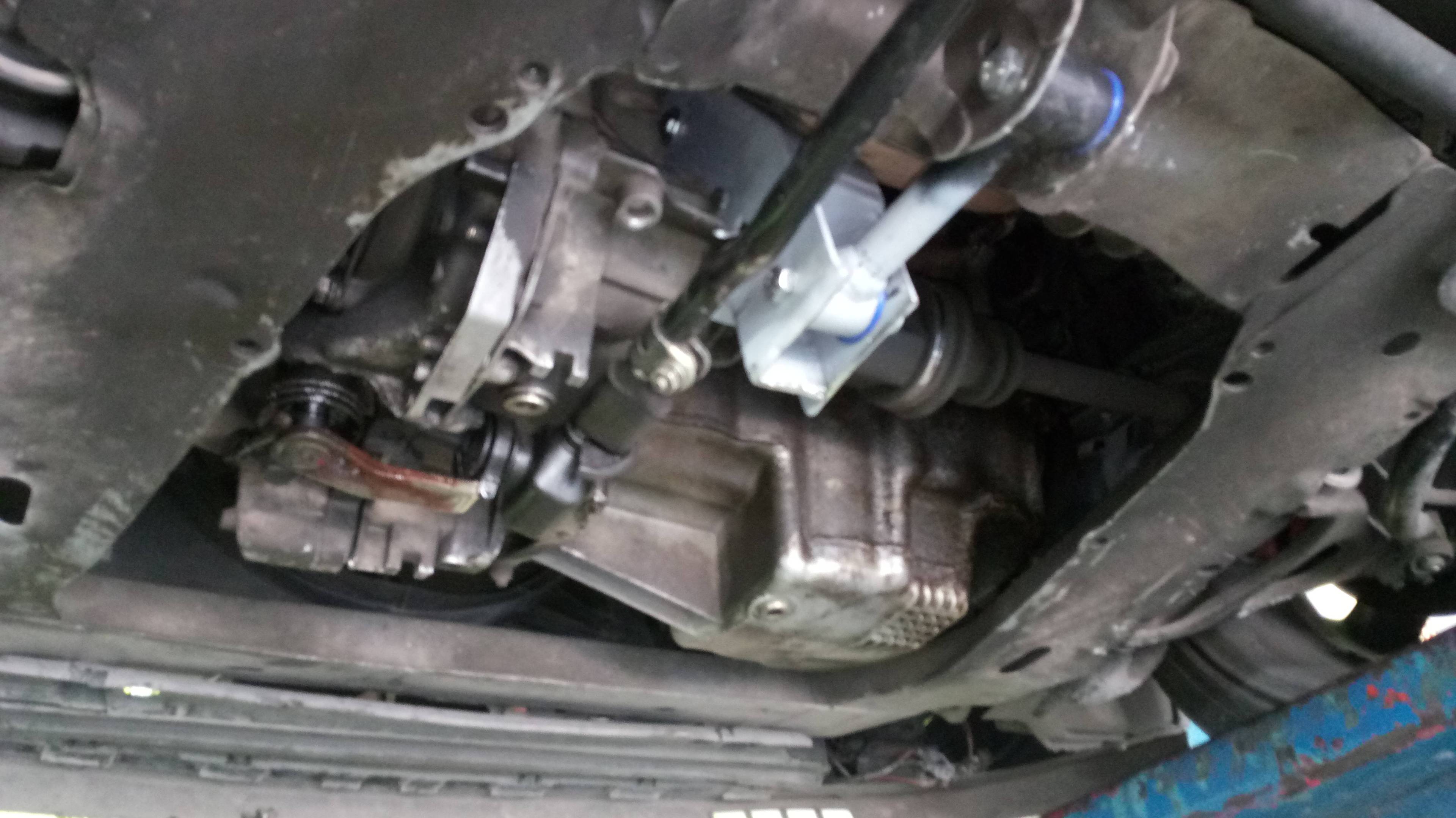

i have tryed a lot of dogbone on the clio in order to make the engine and the sifter not moving
tried the twisted one the oem one and every one lasted me a month or two max ! and started to wobble again
then i got the solid one from ebay and the car was better than ever BUT :p
i started to shatter the gearbox side bolts im counting two now
have anyone the same issue ? and is there any solution to that or do i have to go back on the oem ones ? and have my shifter wobble
the second bolt i used was 8.8 hard bit softer than the original that was on the car but im afraid that going 12.9 high tensile will brake my gearbox and end up with bigger problems :/

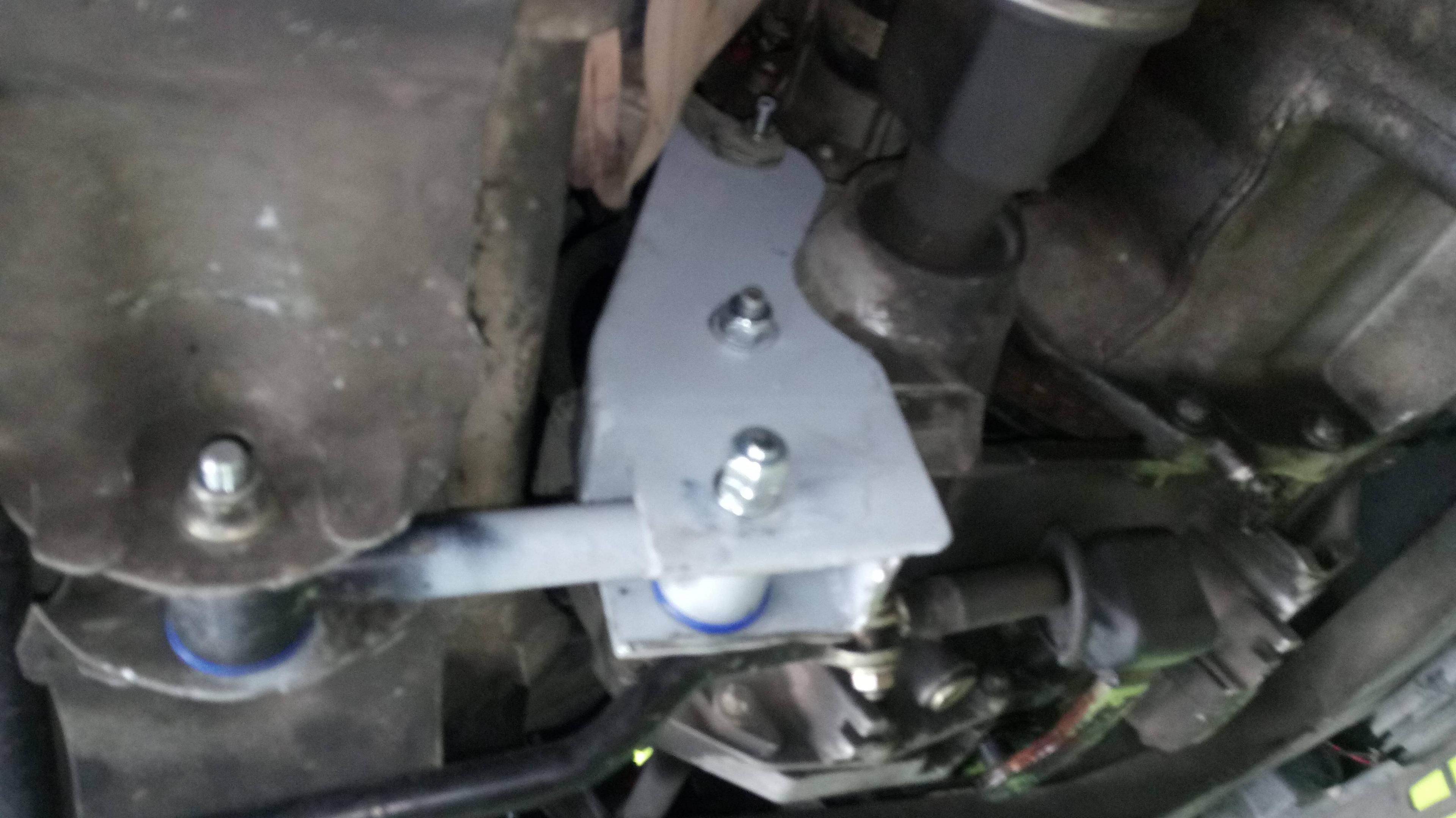

nope both bolts were torqued at 62nm
i thing that the dogbone i have is to hard on the bolts and brakes them but !
im in the process of copying the pure motorsports rear lower mount that hooks on the gearbox with the two bolts that the are a bit far up of the bolt im braking so have to see it this is going to work ( like the kangoo 2.0 rear mount ) this one ( since i cant find it )

i could find the bracket for the mount i posted so i made my own
it seems ok for now still haven't broke any bolts
