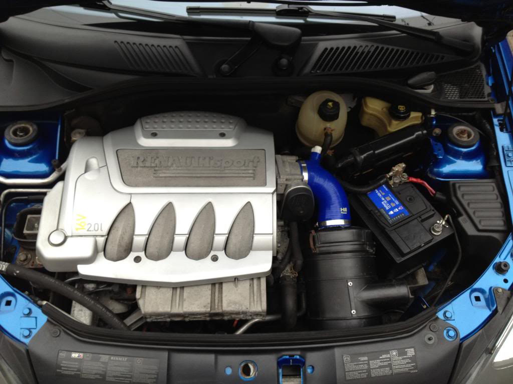

Finally got round to doing this, the engine bay looked realy dull and boring before and just needed to broought back to life some how.

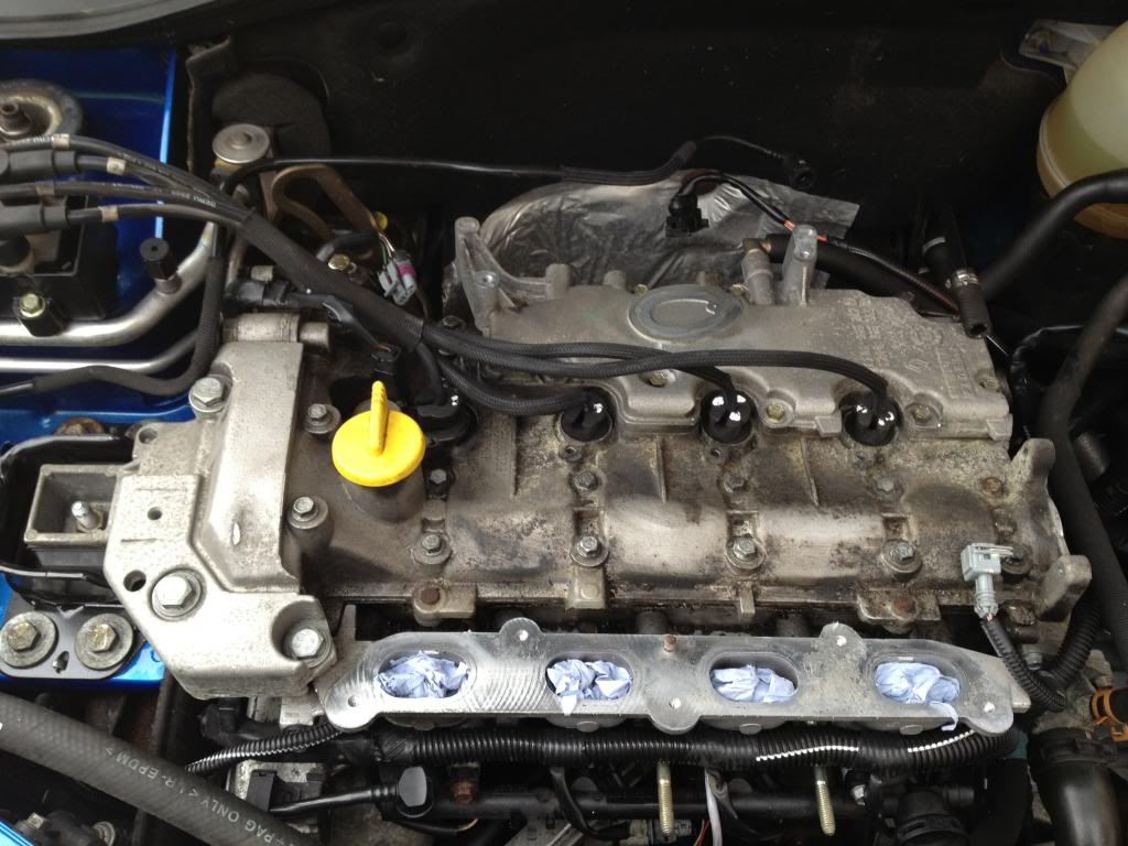

Heres how it was 3 weeks ago
and approx 20 mins after it looking like that...

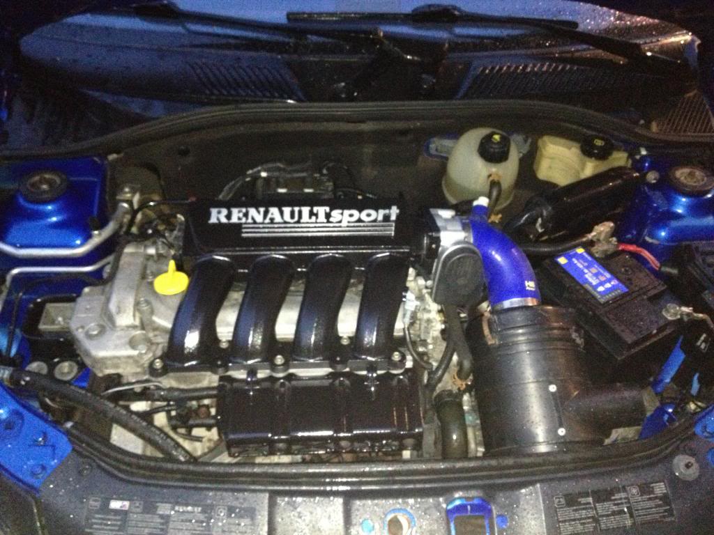

2 weeks ago i had made a little progress....

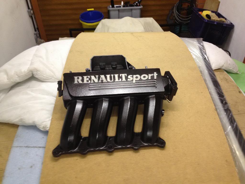

Not long after that pic i got it fitted, along with the sprayed throttle body and fuel rail gaurd, also gave the cam cover a good clean up too as it was filthy, you could see i had already started in the pic with no inlet on.
(please excuse the poor light was late and had to use flash)

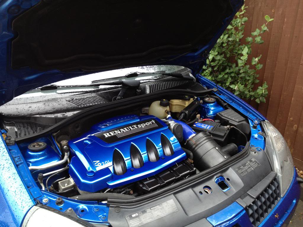

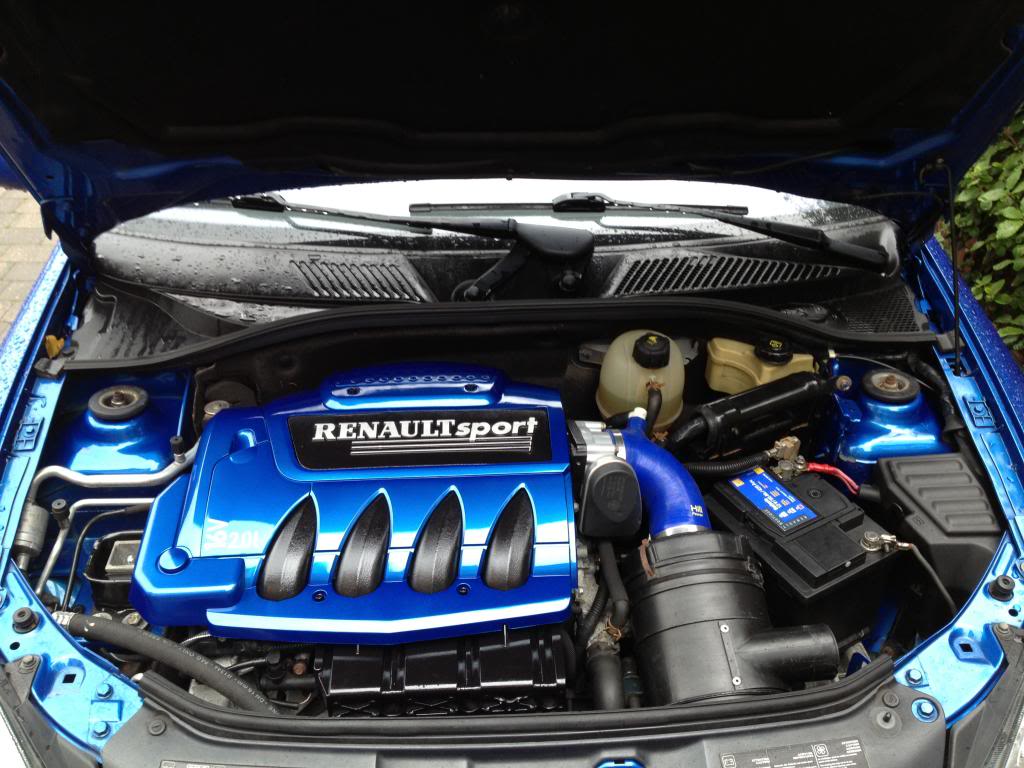

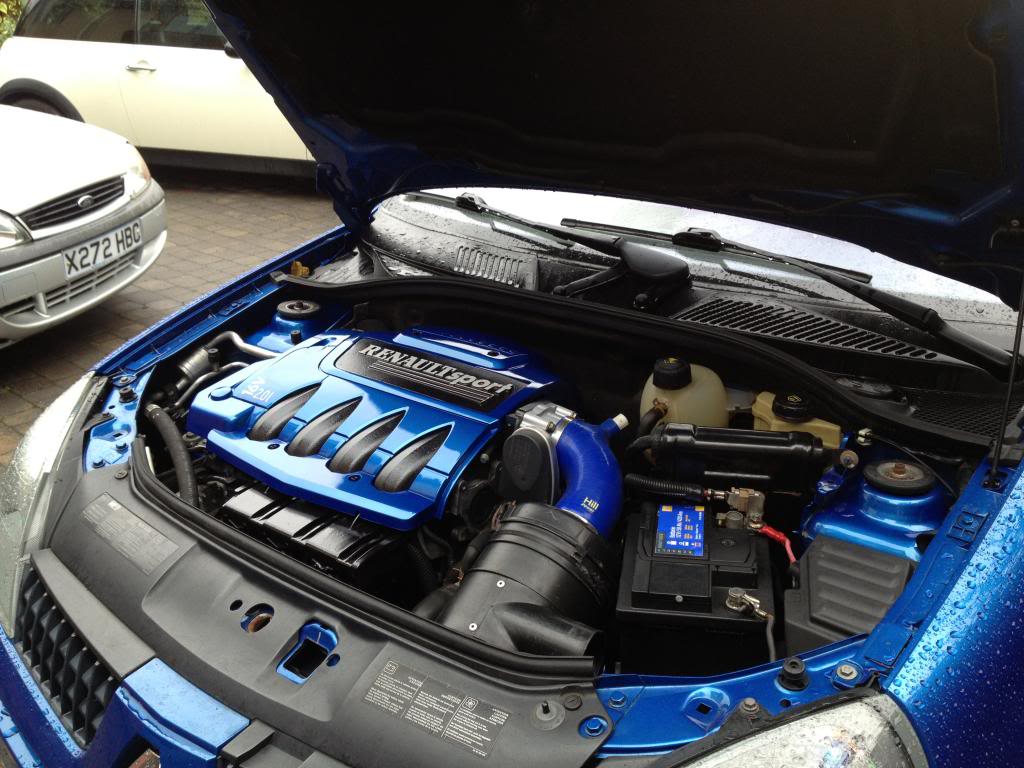

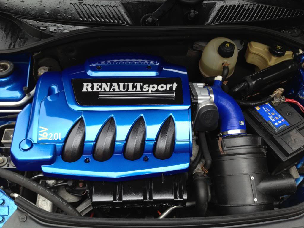

Finally after 3 weeks of it being apart, i managed to finish the cover and got it all back together and got some pics at weekend....
Overall im very chuffed with the turn out, considering the cold weather.... I thought the laquer was going to be a pain in the arse and not set properly.
I just used black VHT paint for the inlet and fuel rail gaurd and silver VHT paint for the throttle body, but the paint shop i got it from did a VHT clear coat too so thought id get some of that and im glad i did because the black went very matt a bit more matt than i was hoping for, i wanted more of a satin black look but it turned out very nice doing it like this, i also used the VHT clear cote on the throttle body which now looks new :)
but i had to leave the renault sport bit with the polished alloy look, couldnt resist had seen it on a few other peoples cars and really liked it so i did that before i applied the VHT clear coat so it will stay like that

Looks great. This is what I was planning to do, except paint the cover orange. What paint did you use for the inlet? High temp?
I used 3 different tins, they were an orange can, the make was Autotek professional VHT, it was VHT black for the inlet and fuel rail gaurd, and VHT silver-grey for the throttle body. Then i used the VHT clear over the inlet, throttle body and fuel rail gaurd. The guy in the body shop said that with the silver or any colour, over time and with enough heat the silver will just turn black so will need the clear coat to prevent that. Now i dont know if this was just to get me to buy the clear coat or not, because i dont think the throttlebody will heat up enough for it to change colour at all. But id have bought it anyway and im glad i did because the finish of the black was so much nicer with the clear coat
Then for the renault sport, i just used a orbital sander with a grade of 600 or 800 i cant remember, and then just went over lightly with the 1000 gritt and brillo pad so it still had that brushed ally look.
Then when you spray the inlet once its dried before i applied the clear coat i just went over very carefully with a small block of wood and the 1000gritt again to take the paint off the renault sport bit and then sprayed with clear coat
hope that helps for when you do yours :)
