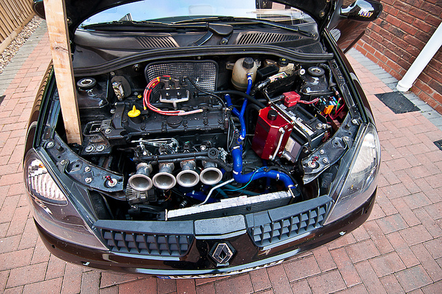

Power wise it's at 231bhp and 185ft/lb with a 7.5k rev limit, but it's still climbing hard at that point, once it's got some of Matt's special one piece valves in and the limit raised it ought to make a bit more yet. I've got a nice ph1 head with the larger exhaust ports at TDF at the moment, it'll be having some mild headwork, one piece valves and uprated springs.
The current engine specs are-
Jenvey bodies.
Cat Cams 422's.
Iappel forged high comp pistons.
Forged rods with ARP bolts.
Ported and polished head (badly, but that's changing soon).
Balanced and lightened bottom end.
330cc injectors.
Helix clutch and cover plate.
EC1 ecu and wiring loom.
Mocal 2l catch tank.
Mocal oil coler.
Forge silicone hoses.
Cup aternator setup with aircon removed.
The radiator is something from the VAG group, same as the Burpspeed boys I think.

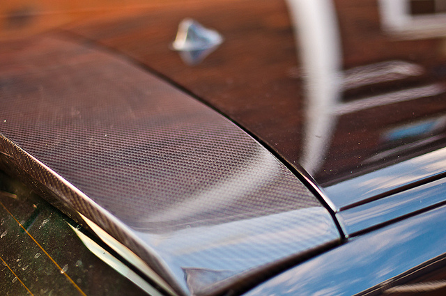

Plenty of lovely Streamline carbon bits.

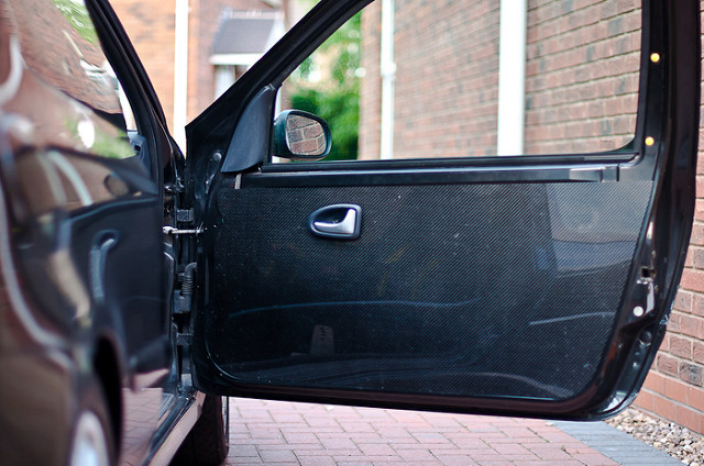

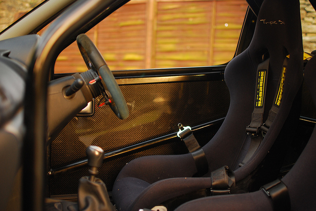

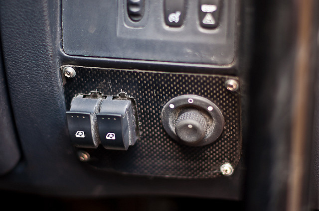

The plan is for a trackday car rather than a full blown race car, so it's still got things like electric windows and mirrors. The controls have been moved here as there's nowhere to put them on the doorcards.

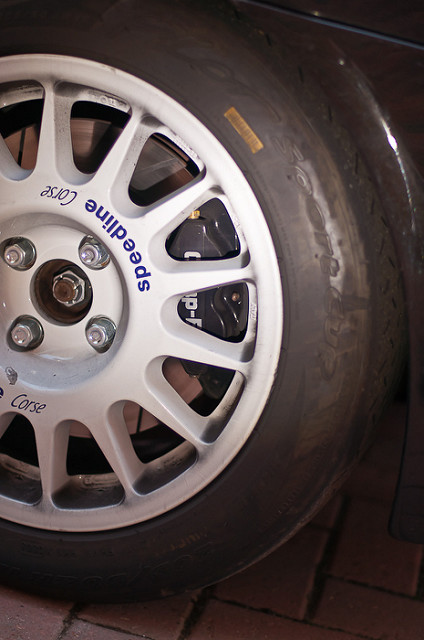

Brakes wise it's running compbrake four pots with cryo treated rotors. These are completely amazing! Still on the original Hawk pads at the moment, but soon to be replaced with either Performance Friction or Carbotech. The lines are custom made by Merlin Motorsport at Castle Combe from Goodrich hoses.

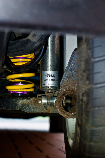

For suspension it's on two way adjustable KW competition. I was running these while it was still being used as a daily!

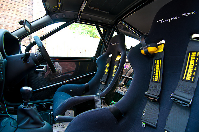

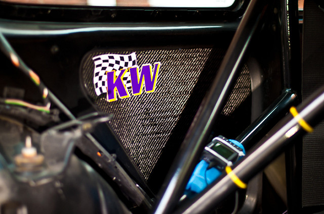

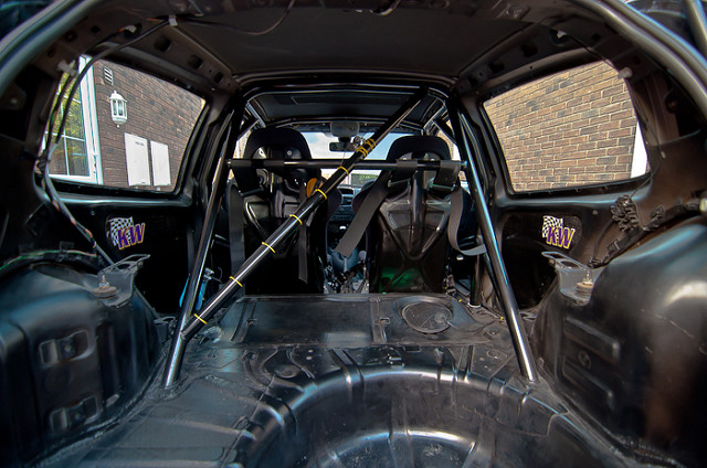

The cage is an OMP six point with a harness bar added and some extra triangulation. I'm waiting for some padding to arrive in the next couple of days for this too.
Fixed back seats from Magnum Motorsports, four point Schroth asm harnesses and a sabelt wheel pretty much finishes off the interior.

The work's perfect as you'd expect, even the details. The heat shield that Sam made looks like an original part.
i had to look at the bay pic then to see if any of my leftover/forgotten bits of the meg had gone in! lol

excuse the slam pannel bodging and the wiring bodge on the fan, still needs a few bits doing to finish it

The ecu ought to be fine (I hope so anyway I've sold it to iceman for his 24hr car, but I've told him any problems and I'll sort it out) The reason for going EC1 was to keep the dash working properly, it worked out cheaper than a digi dash. The loom's a different story.. All I'll say is bullet connectors..

I wish my Compbrakes looked that good still.
Ha, they're a bit less clean already ;)
