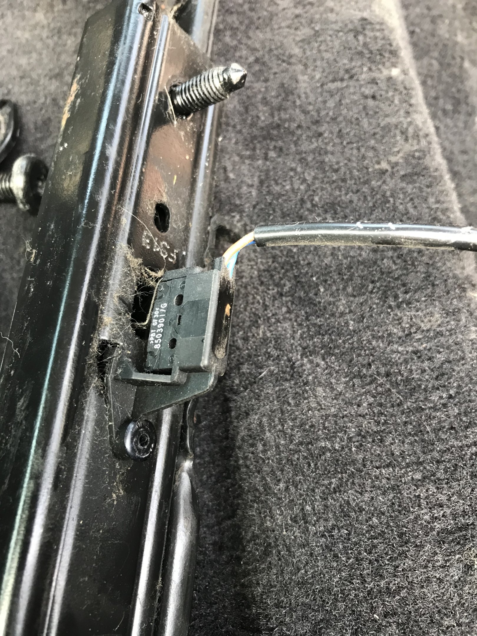

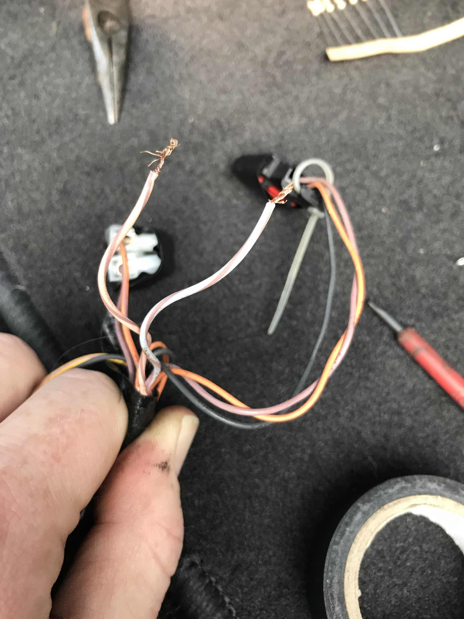

Currently trying to fit my Corbeau club sport buckets and have run into an issue whereby despite using the correct resistors across the correct wires, the airbag light stays on unless the seat position sensor is connected up. Even if i bridge across the 2 wires (grey/brown and pink and brown) with a 3.3ohm resistor, the light stays on.
Other treads seem to suggest you only require 2 resistors per side, but I’ve tried bridging the above with resistors, I’ve even tried connecting the wires together but no joy, the light will only go off when i connect the wires back up to the seat position switch itself.
Any ideas/advice/pointing out the obvious would be great as i currently have the car in bits and can’t think why it’s behaving as it is.
