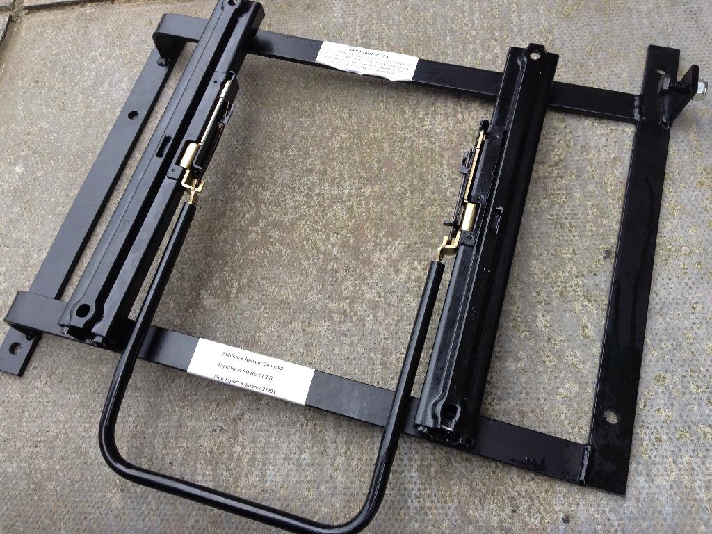

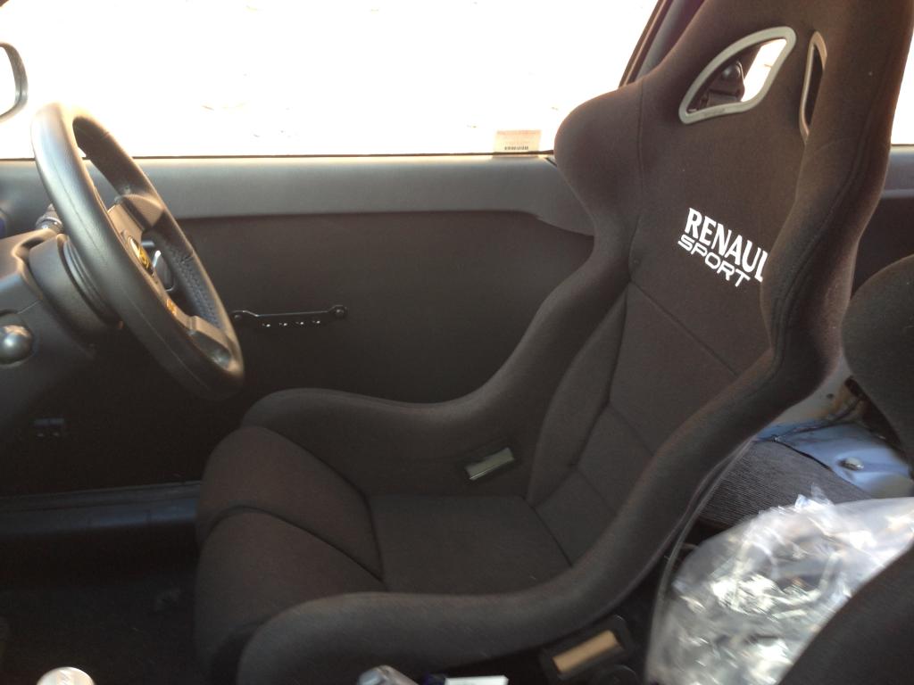

I know it's difficult to judge but here are my futuras on carbontec side mounts, cobra sliders and sub frames. I can take a measurement from the roof or floor if it helps. They're lower than the standard cup seats, not sure how much though.
What subframes are they? and where did you get them?

This post is exactly what I was about to post about also. I have the bimarco seats ready to go into my ph1 V6 but was unsure about the exact things you mention i.e. subframes /sliders etc
I was under the impression that you could use the sliders from the standard seats(Renault sport)?

Cobra X- low?
if so they stopped making them a while back.
They now make a new low frame, I bought 2 the other day. Much better quality than the X-Lows but not quite as low, but still lower than anything else I could find on the market.
Only place I know of selling them is R-Tec. http://www.rtecshop.com/ Its a 3 - 6 week wait as made to order.

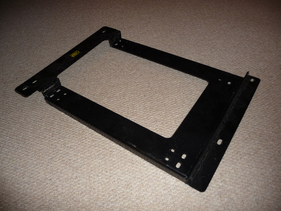

I found the OMP pointless as it wasn't low enough and as said you need to pack them out. If you leave the standard spacers in on the tunnel side they sit level.

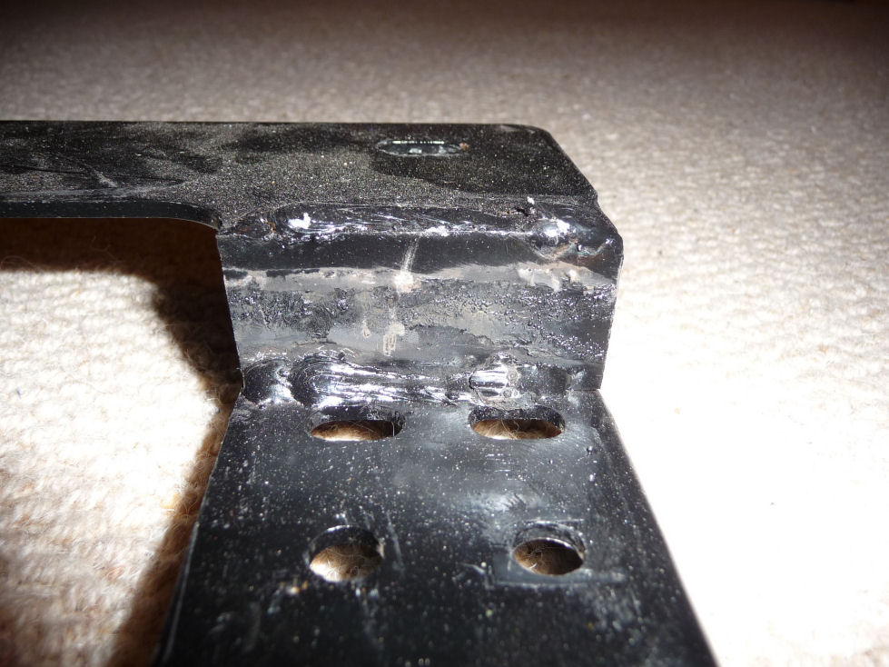

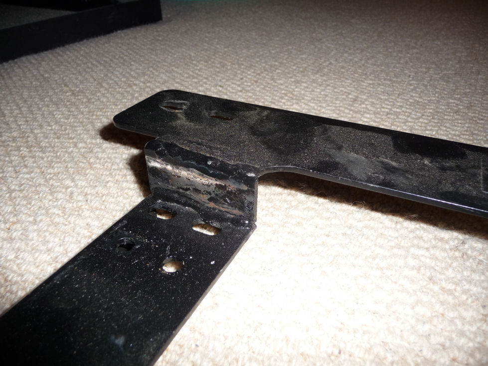

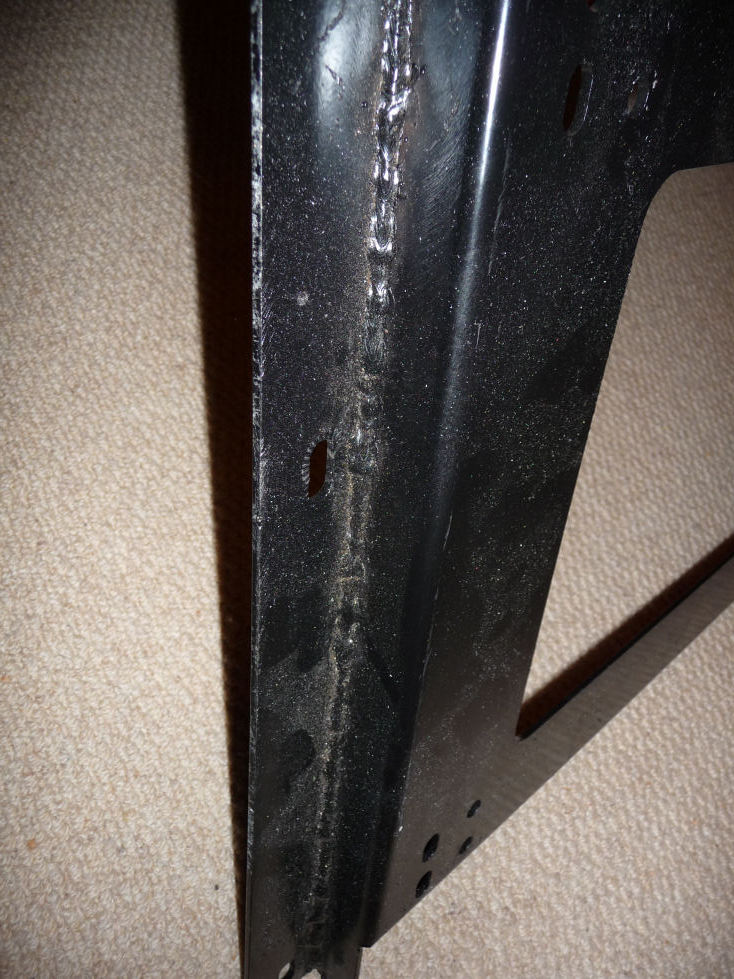

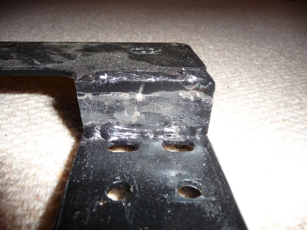

Mine were just Cobra, not x low. I bought them from a local Motorsport shop who ordered them in for a customer some years ago and got stuck with them, got them both for £80! They needed some fettling as per pics, sidemounts are low style from carbontec in the traders area, very good quality and lower mounting points than others I'd considered.

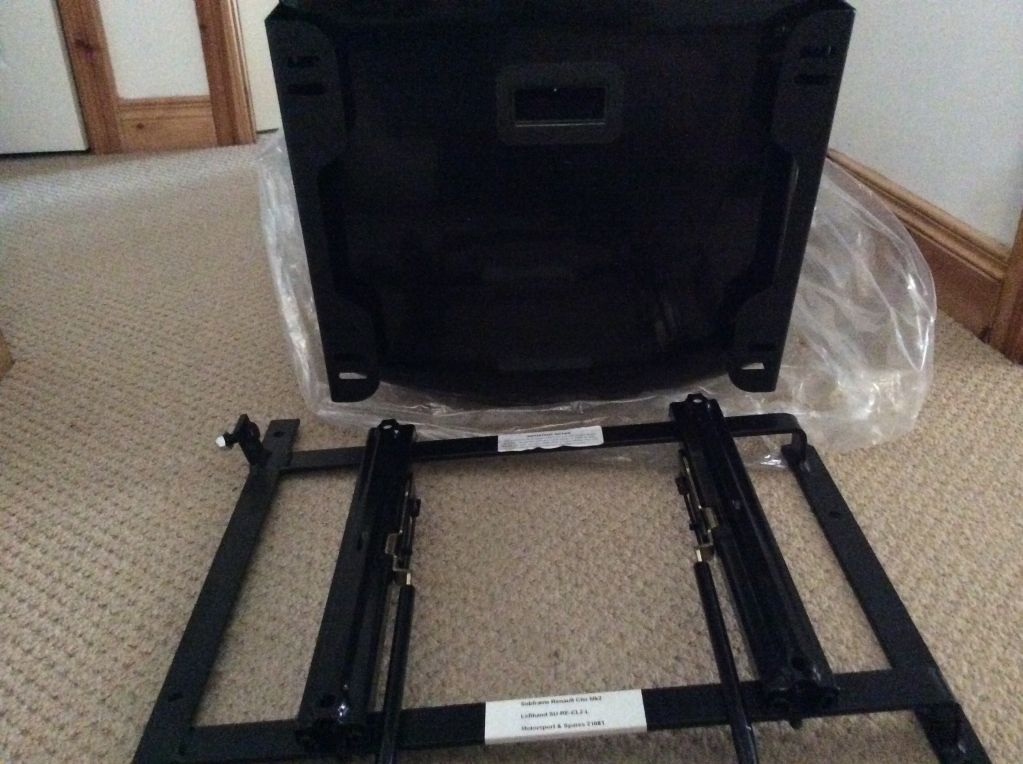

Called RTEC as WILL had kindly suggested that they do a cobra subframe and slider kit. They refused to sell me the kit as I did not have cobra seats and said cobra will only supply this custom kit if you show a picture of your car with the seats next to it to prove you are fitting cobra seats only!!
Sounded nuts but that's what they said.

Buy the OMP subframes. Cut some metal out from one side, weld it to the other side. Or get a local firm to do it :)
when you say cut some metal out is that to even up the height difference?

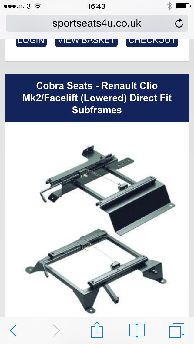

Thats insane! however as somebody else mentioned i think GSM Seats stock the lowered Cobra frames and runners so worth giving them a try?
I called them and they do not do the cobra subframes/sliders etc they said use OMP and aside mounts, rumour has it you can use the oe slider off your Renault seats on the omp subframes. You will need to fabricate a "u" bracket to level them though.
Another chap said you can just cut a piece of metal off one side and weld it onto the other to do without the "u" bracket(tubing)

That's the ones though surely? And on there website to order ? Cobra lowered frames with sliders?

I personally do not rate the OMP sub frames as I don't like paying that much money for an ill fitting part.
