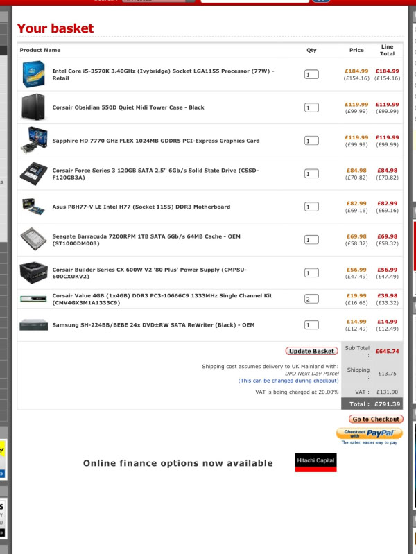

Here you go:
I'll buy the cheaper/faster memory from scan (eBay) as Gareth suggested.

If you can stretch to a i5 3570K processor then do that. And make sure it is retail otherwise it won't come with a cpu coller.
apart from that it looks good to me.
Another thing to consider perhaps is that HD7770 outperforms the 550Ti in most tests and is a similar price.
Uses less power too.
But yeah, I like the look of that.

Looks good to me, now just to find the cheapest as OC usually are quite dear.
Yes it will be very fast, our work machines cost half that and are very quick !
I would still get the arctic cooler for the sake of 15 quid, even if you get it a month or two after, maybe start with the retail heatsink and see what you think.
Sometimes the stock coolers are noisey, sometimes there not.
Cool cheers mate...
Which one of the following 7770 cards (I can't tell if they're the same lol)?
What's every one mean when they say 'retail' (from a CPU perspective)? Are they not all retail if bought from overclockers, scan, aria etc...
Retail means it will come with the standard Intel CPU cooler, OEM is just the chip on it's own. With a Sandybridge i would buy an aftermarket cooler, Intel used a rubbish method to dissipate heat through the IHS, and the stock cooler isn't great - if you want to overclock.

Cool well I guess I could go without the one that comes with the CPU and if it's too loud upgrade.
Here's my cart as is :)
Looking good?
  Clio 172 Mk2
yeah pretty decent the spec you've built, you've chose some good stuff there. Personally if anything i'd go for a slightly cheaper case and up the memory to 8gb instead of the 4 you have at present

it is a nice case you've chosen but a case doesn't mean that much to me. It sits under a desk so as long as it has decent cooling and good cable tidy roots and space then i'd much prefer to put the money towards a better graphics card
Nope none to be fair. Plenty of room and wide enough to fit my CoolerMaster 212 cooler. Good value for money, plus you can buy sound deadening kits for it. Comes with loads of thumb screws too. I think it is quiet a popular choice, however if I was spending £100+ on a case (I never would!) then it would be Lian Li.
