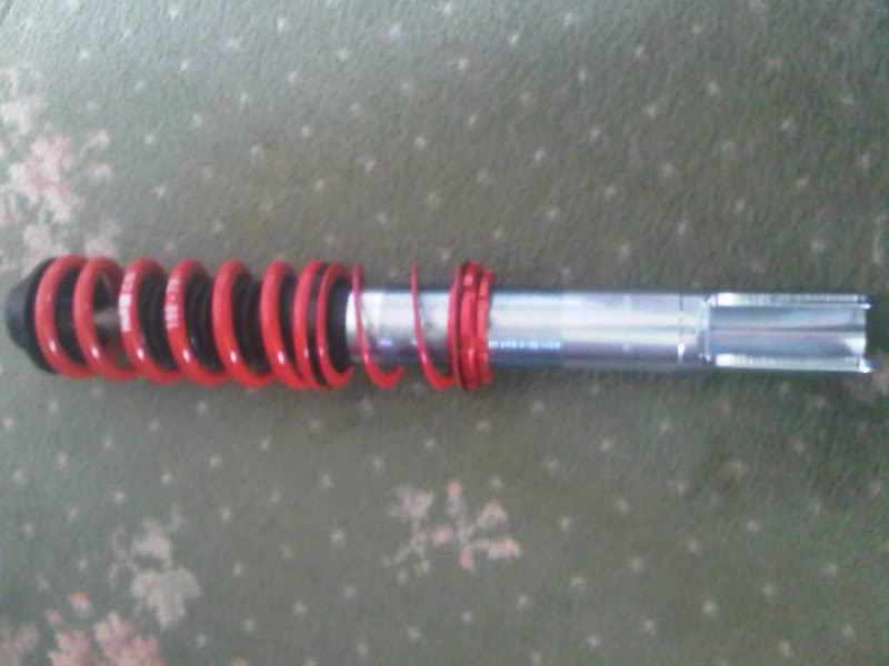

C Chris_786 Car LY R26 230 F1 Team Jun 25, 2011 #2 Pic of a fully built up unit? Bare with me my H&Rs arrived yday ,i'll get you a pic.

Coby. ClioSport Club Member Car XC60-R.......V40-R Jun 25, 2011 #5 Not how I thought they'd go at all Both winding collars at the bottom, Helper spring, Metal collar, Main spring, Top Cup. I have 2 thin plastic rings... Where do they go?? Thanks for your help Chris.

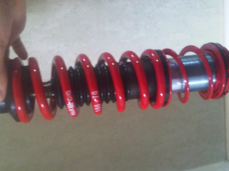

C Chris_786 Car LY R26 230 F1 Team Jun 25, 2011 #6 No worries mate, plastic rings go under the helper spring/above winding collar. you can just about see it in the pics
Coby. ClioSport Club Member Car XC60-R.......V40-R Jun 25, 2011 #7 Ah yes I see....... Another question just so I know I get it 100% The Metal collar has a slightly different sized lip on each size..... Larger lip up or down??
C Chris_786 Car LY R26 230 F1 Team Jun 25, 2011 #8 Lip with the number on it (mines tr52) faces up to locate the helper spring.
