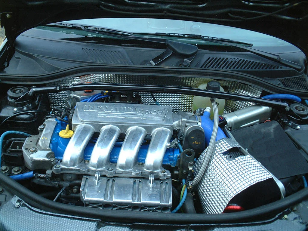

I installed the nimbus sheet on the bulk head as pictured. I used 2 sheets sanwiched between some rockwool. The sheet was £20+ vat and did both sides.
  172 cup'd extreme
From demon tweeks, just ask for a good price. That is the top hose going to the header - my brother made it from braided ptfe, we were going to make a full braided hose kit for coolant and power steering but couldnt be bothered because everyone always goes for silicone.
