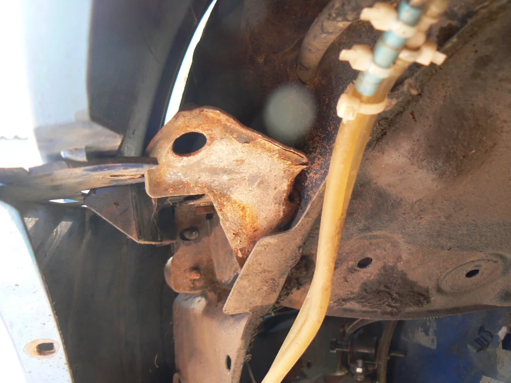

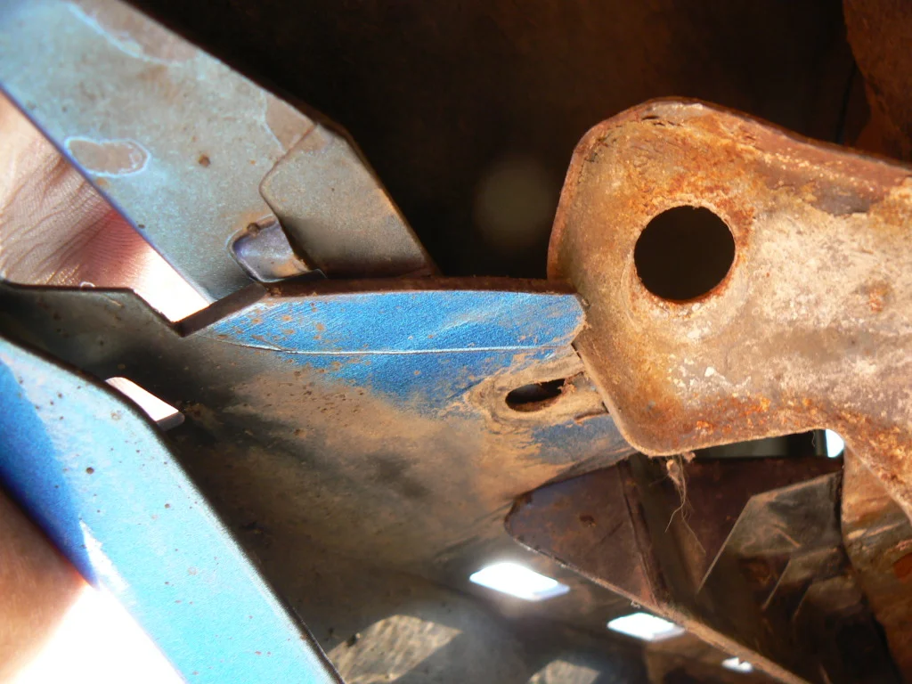

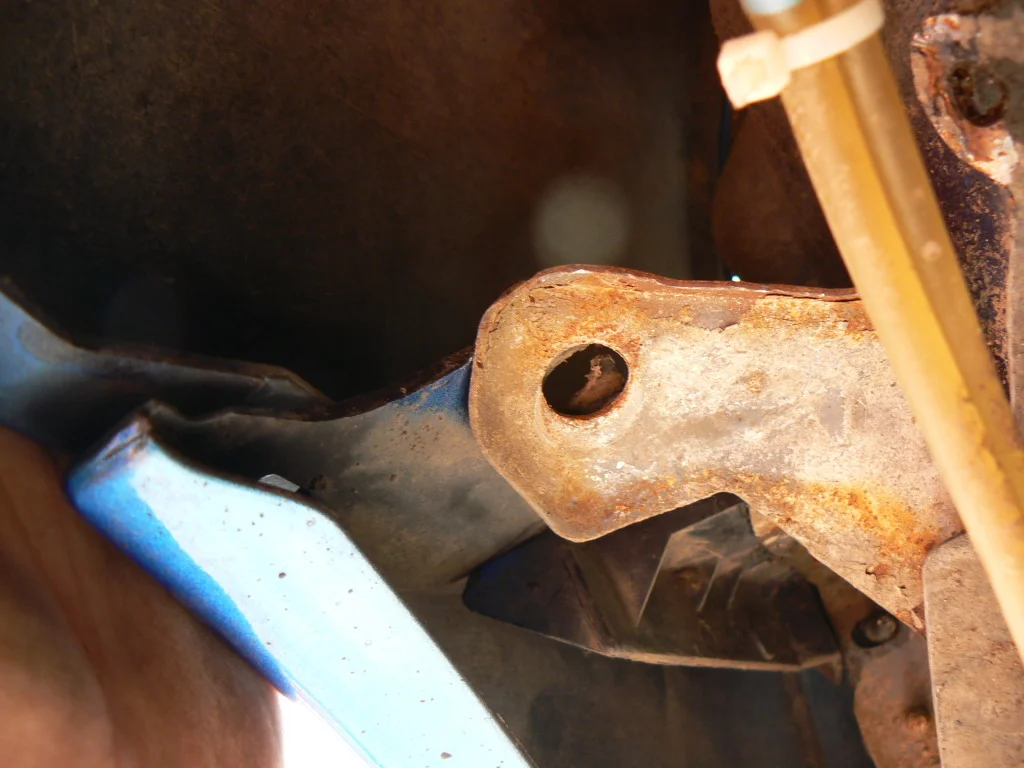

removed the arch liner and twisted the bracket so it is kinda tangent to the wheel
the plastic bit from the bumper had to be cut off a little in order to twist easier aswell
now it fits better over the bracket

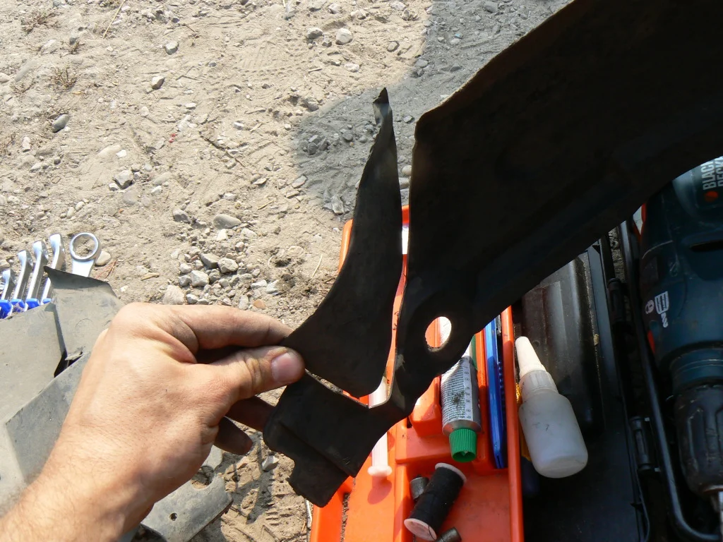

after that the arch liner got the round bit cut off

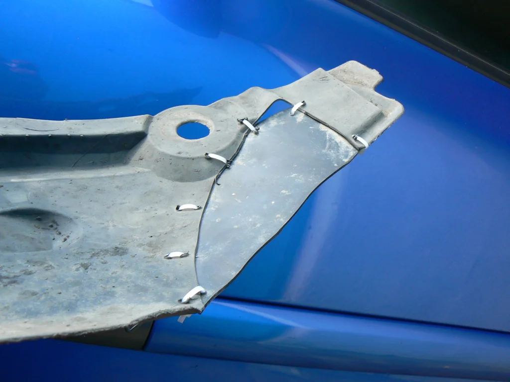

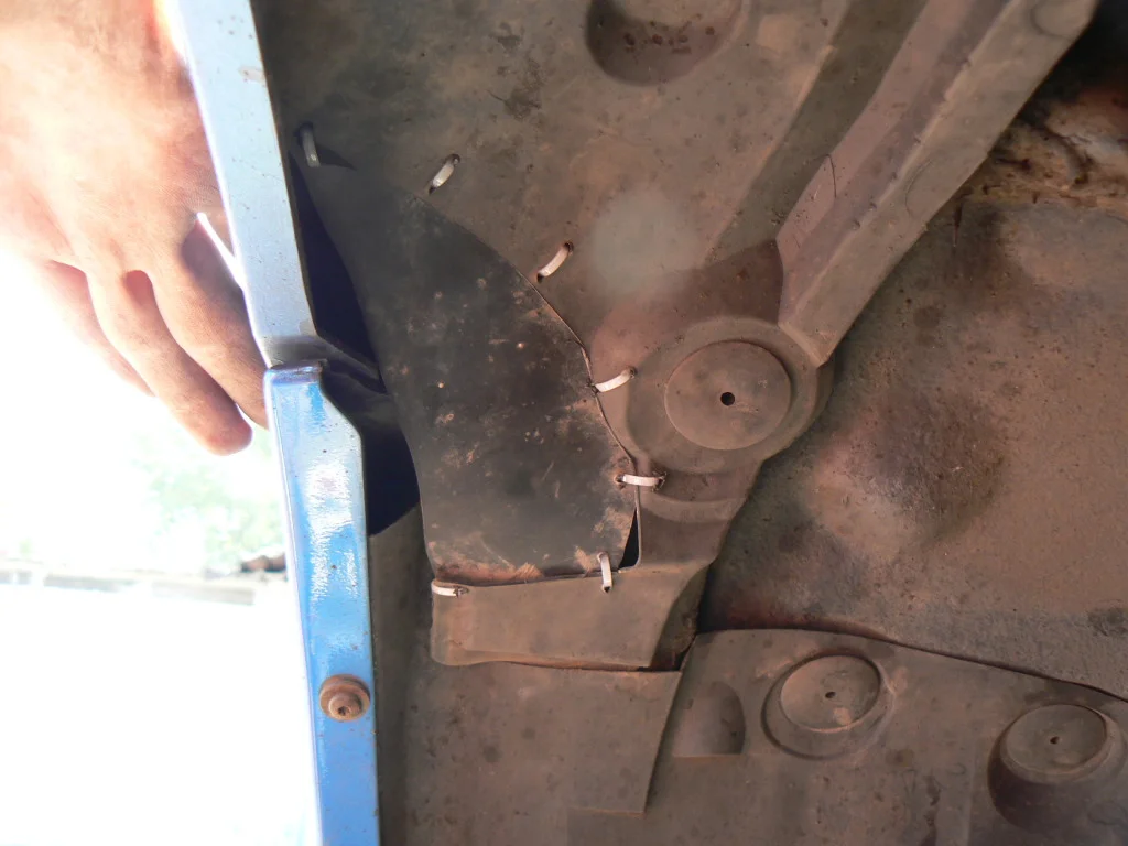

I had some plastic leftovers so I "stitched" a straight piece of plastic over the gap
everything back in place
