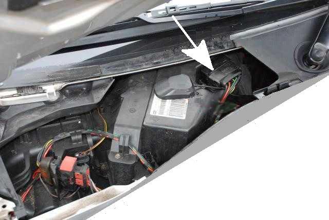

Sounds to me like it could be the heater resistor pack knackered and over heating. It controls the speed of the fan. They can get very hot. Vauxhall had a problem with theirs over heating and the cars setting on fire.
If it's in the same place as a 182 it's under the drivers side scuttle.
If you have a search on here you'll find more info.
If it's not a separate resistor like a 182 it'll be integrated in the blower motor so you'll need to replace it all.

I'd reiterate the above too. Easily checked by disconnecting the resistor pack then reconnecting the fuse. It could also be the wiring or the heater motor itself.
You just need an 8mm socket/spanner to get to the resistor iirc.
Thinking about it now. I'll bet yours has the resistor integrated on the motor.
