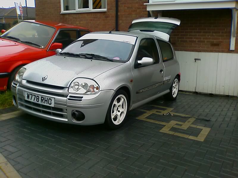

Here is the car as i bought it....

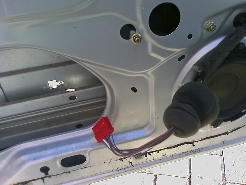

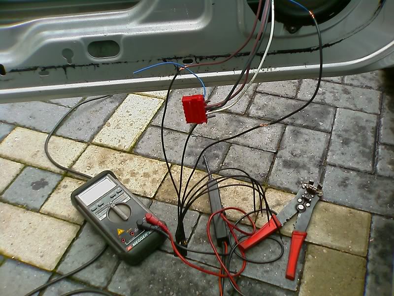

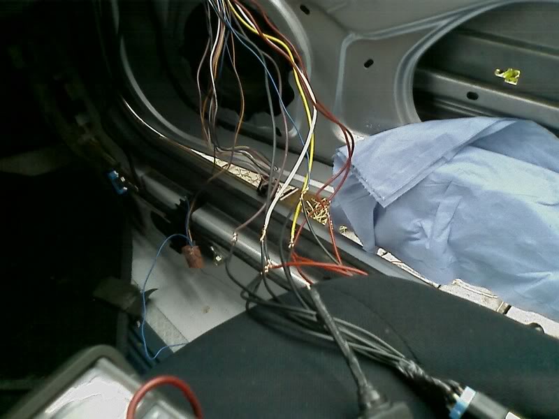

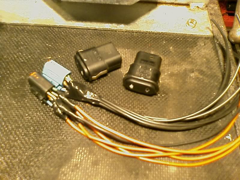

The original interior trim was sold COMPLETE meaning the car had no electric window switches.
after seeing some pics on here of cars that had their door trims removed and had the stock switches stuck/cable tied on i was determined to make a nice job of it. Didnt want to switch to 'keep fit' windows as i like the electrics and from what ive heard they dont save a great deal of weight. Also the solution ive come up with has cost next to nothing.
While driving the van one day i had an idea. The window switches on that are housed in a small pod that sits neatly on the panel As im previously a ford man (Ford college trained and worked in two main dealers for 8 years) i knew exactly what would be involved to get them working on the clio. A visit to the local scrappy and for the sum of £2 i got myself 3 switches and multiplugs and set about extending the looms...
Then set about wiring them up with the help of a diagram i still had from the old days.
Got them working (including the illumination) so soldered them in......

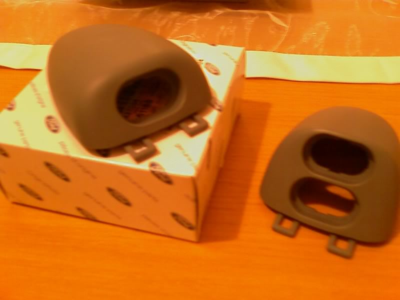

The transit pods from Ford (about a £10 for the pair)
Im gonna be making some flat panels for the doors so these will look quite neat imo.

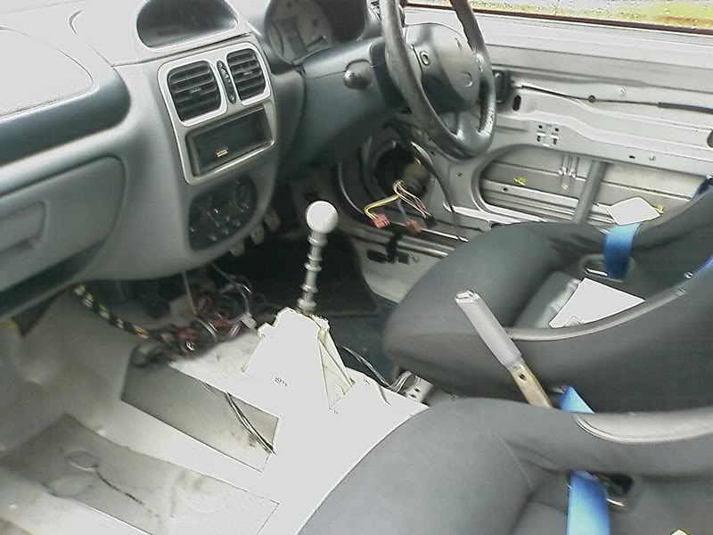

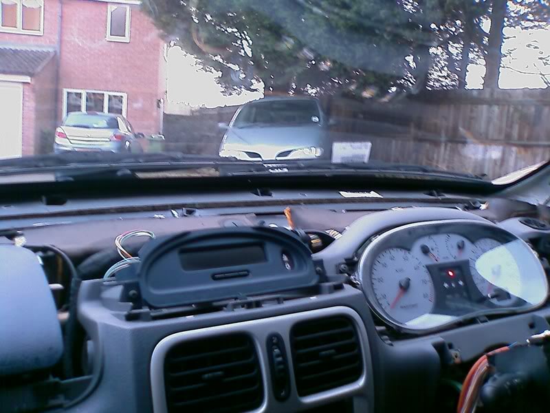

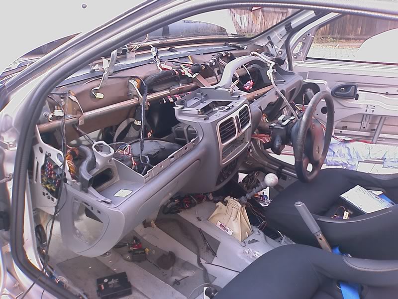

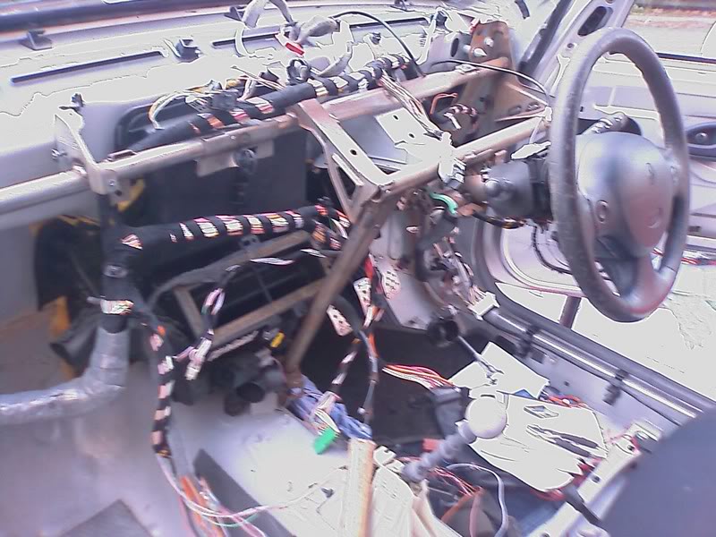

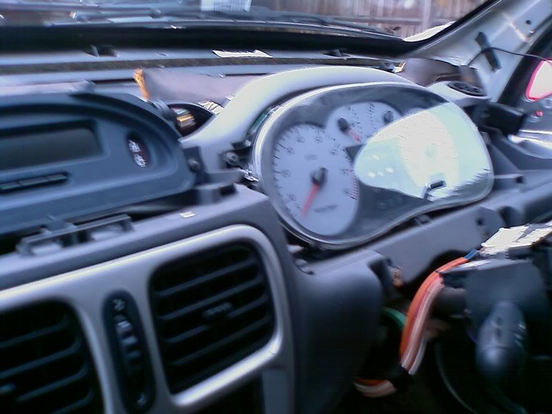

Dash is coming out, not to stay out just to sort out the dash warning lights and remove some un-needed items like soundproofing. Made a start.........

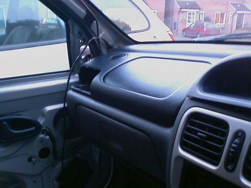

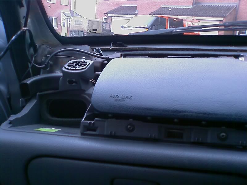

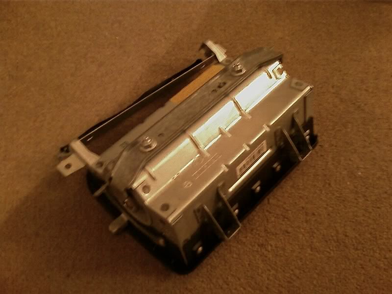

Dont want/need the airbag so it came out....
Very heavy thing that, put it on the scales and its near to 3.5kgs!

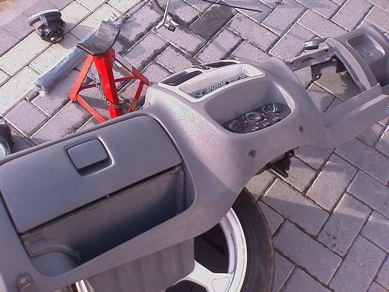

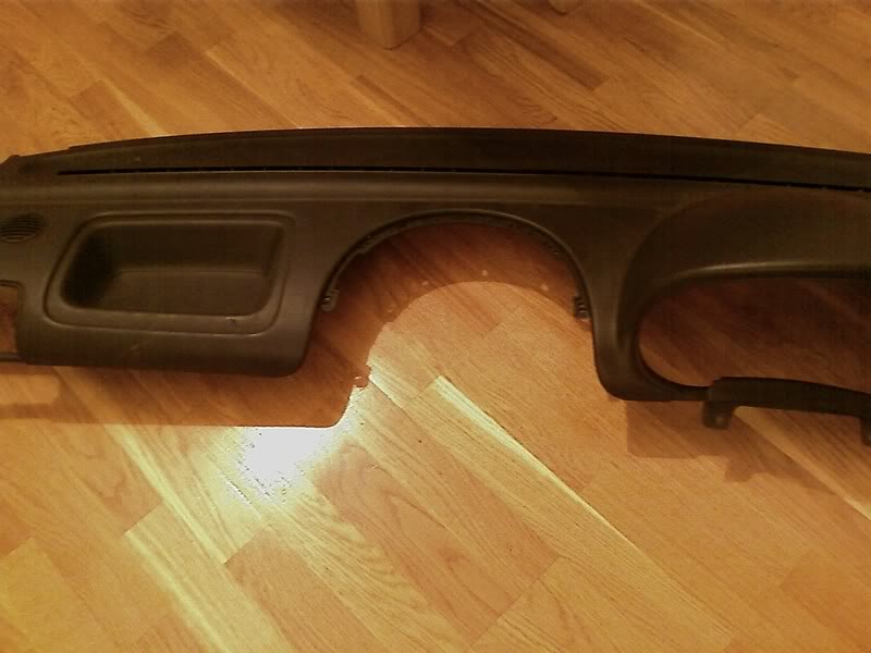

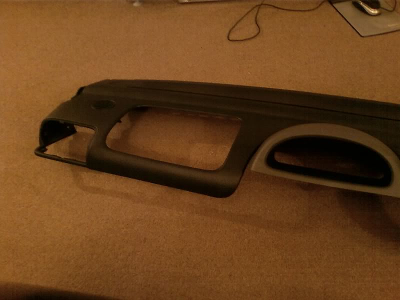

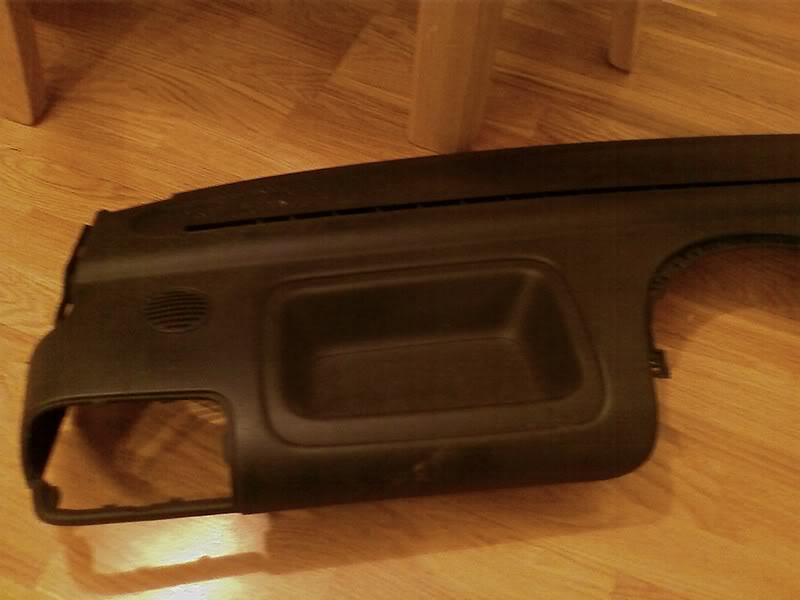

That left a hole in the dash where the bag was, so went to the local breakers and picked up a 1.2 non airbag dash top in black.....

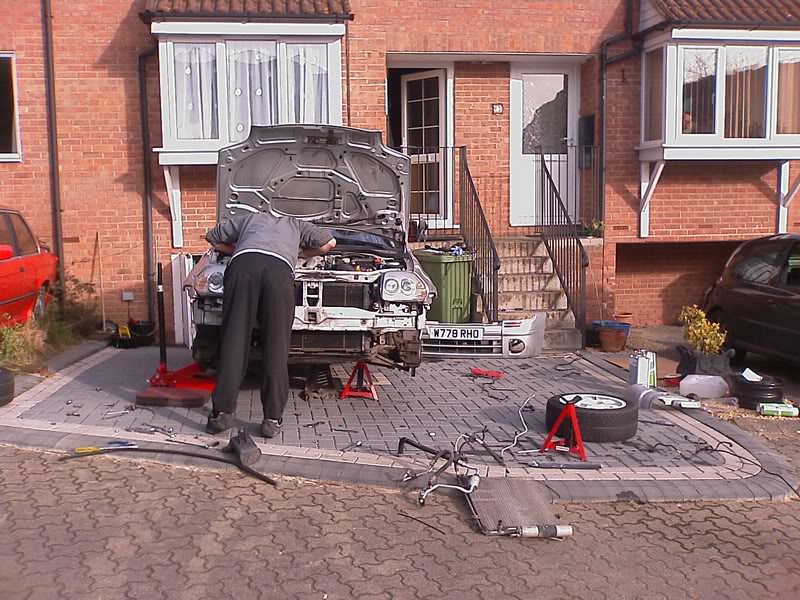

Amazing weather today, sunny without a cloud in the sky, just a little windy. Todays progress was HUGE while i was busy fitting new brakes on Anim@l's 182 he set about taking off all the stickers (not realy my thing stickers)

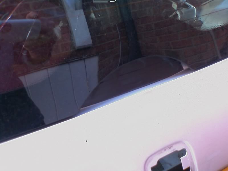

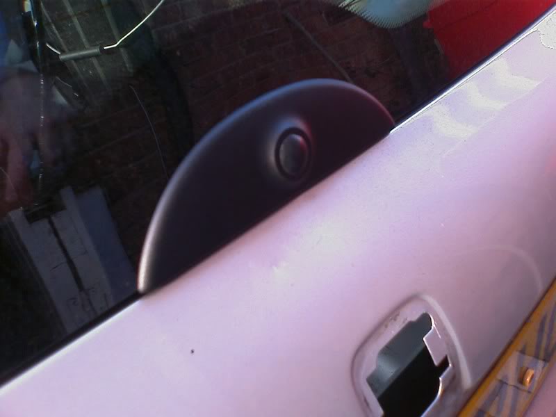

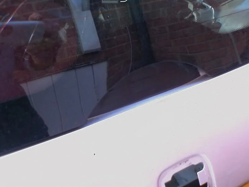

Fitted a wiper bank plate to tidy up the boot lid. tried to get the flat non wiper one (Beleive its off the french cup or Raggnotti or what ever its called) but the local dealer said that even tho its listed on the parts catalog (for £18!) it wasn't available. He even rang France to check. so i went for a standard one (£3!) with a Wallance and Grommet to fill the hole..
From this....
to this....

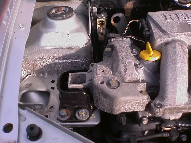

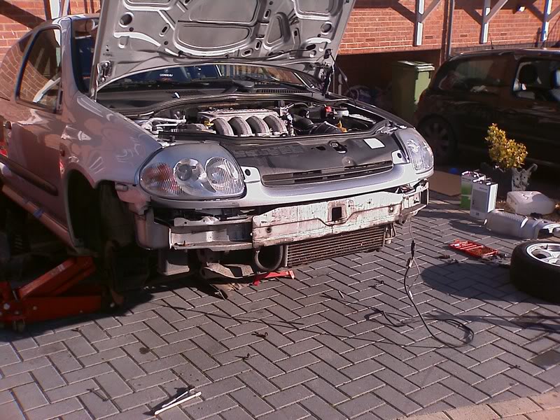

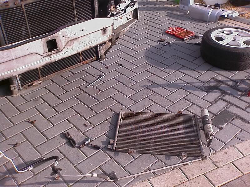

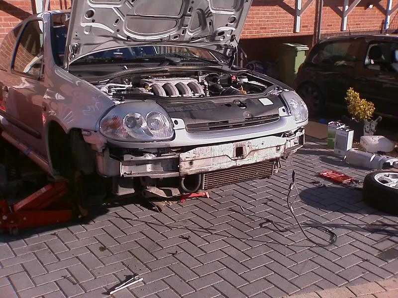

Planned to take the aircon off at some stage in the cars future but another member needs the condenser coz a badger ate it, so off it came today...
All the pipework gone too
The compressor is staying on for now, will be coming off some time tho. While the bumper was off used the oportunity to remove the carbon canister and fog lamp wiring.

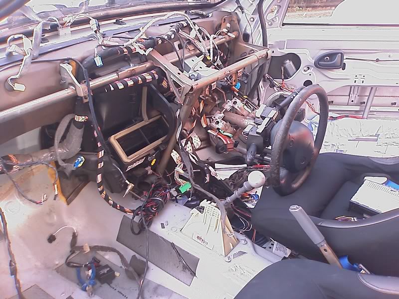

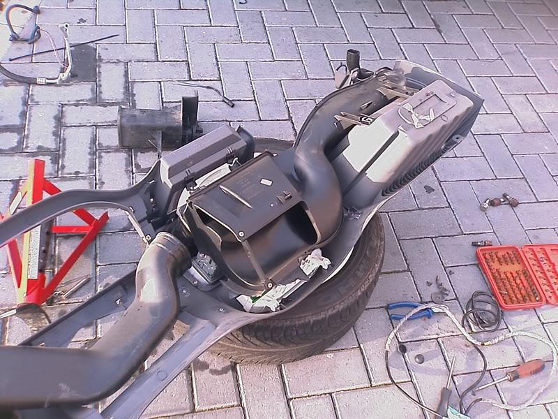

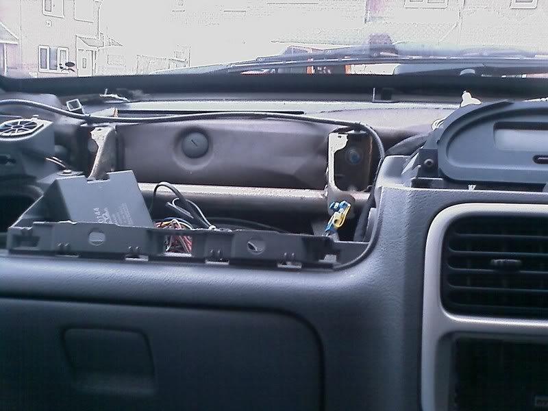

After that we carried on taking the dash out...

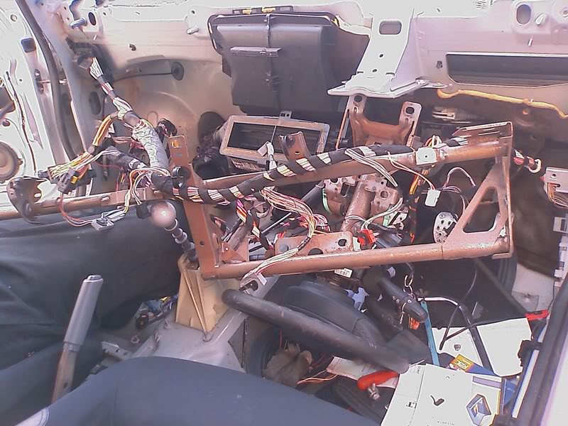

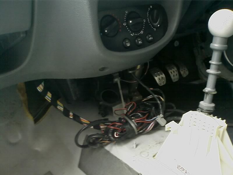

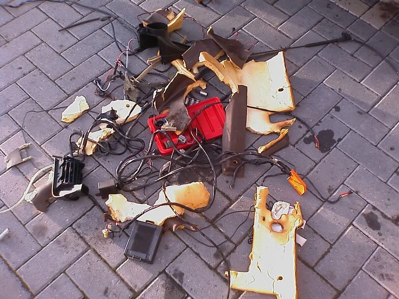

Removed all the un-nessisary wiring loom, airbag, door switches, dash tweeters, interior light etc. took the bulbs out of the clock for seat belt warning and door ajar. Serv light and airbag light went out when chopping the loom off. Later we found that the car wouldn't start and the immobiliser led wasn't flashing. turned out to be a 5 amp fuse blown, Few!

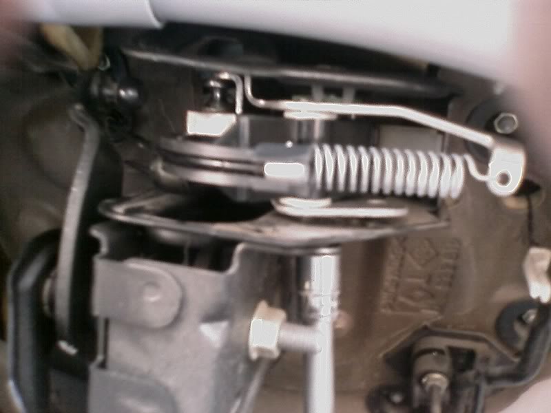

Changed the clutch ratchet, that had been playing up, while the dash was out (easy job in this state) found that the throttle cable is frayed and literaly hanging on one thread. Need to get a new one this week....
Took off all the dash vent ducting for the face vents. Only going to have it working on screen and feet.
Much neater wiring loom now....
Pile of bin fodder, bulkhead insulation and other unwanted shite.....

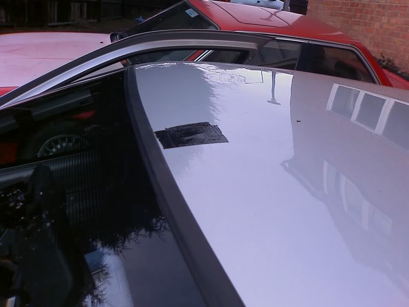

took the roof ariel off....... want to keep the radio but i have a plan for that hole ;)

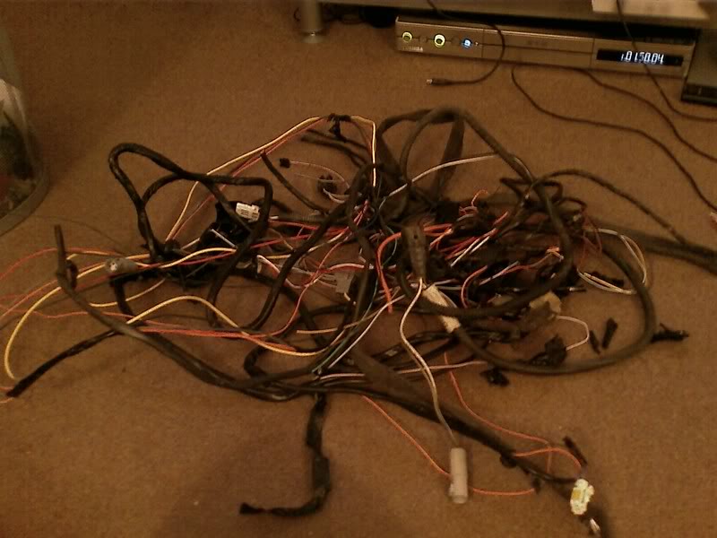

The massive amount of wiring thats been removed. And thats only part of it...

I wana dewiper the rear of mine, what size grommet have you used? How is it fitted, have you just glued it?
Cheers
  Qashcow
Re: My Ph1 172 track sl*g Progress Thread
only just spotted this jay. first thing im doing when im back in the UK is taking the rear wiper off. hadnt thourght about a smooth panel. my 2 previous cars had them removed but with just a gromet into the window.

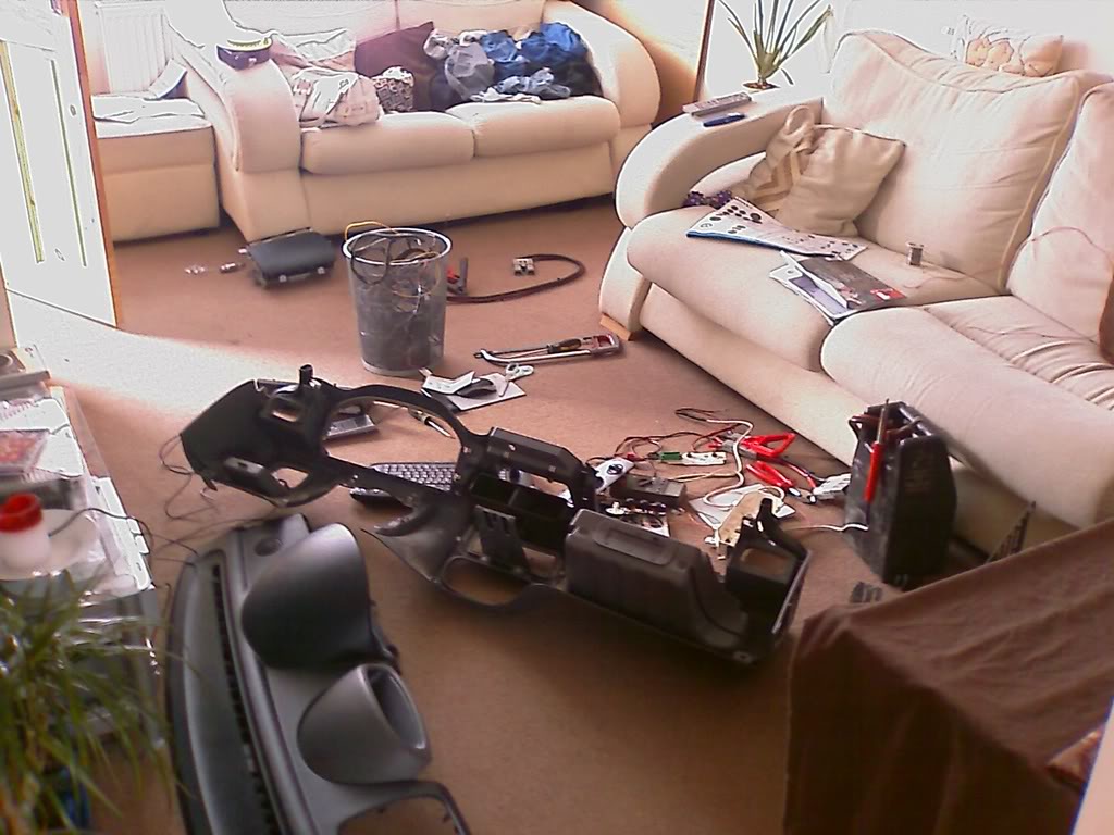

How my living room looked while my Girlfriend was away..

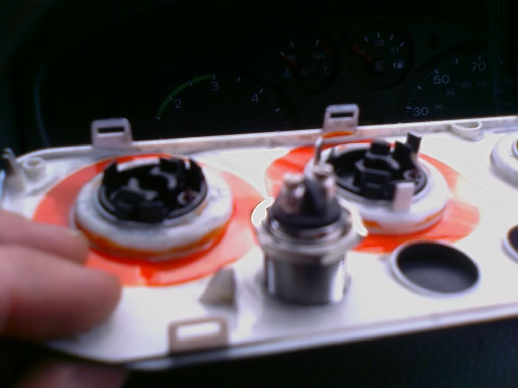

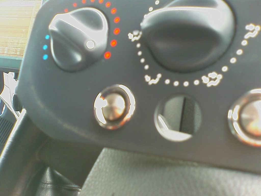

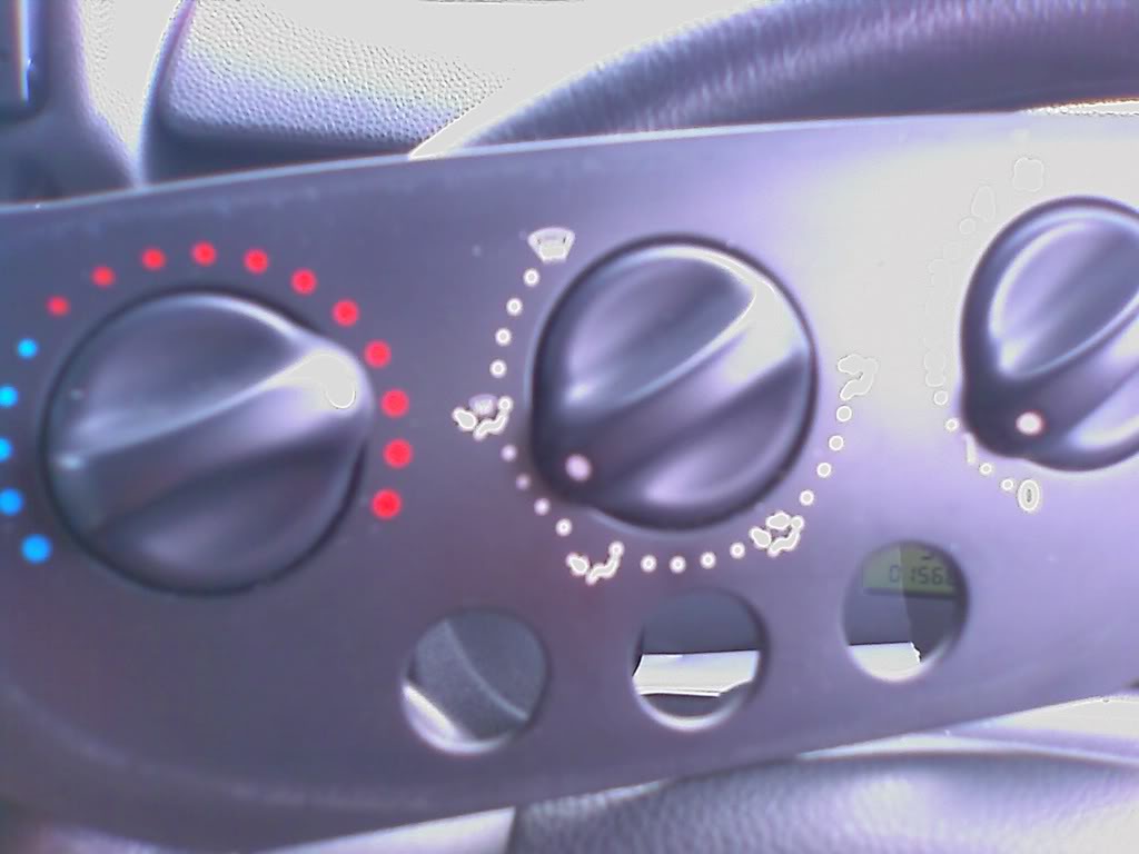

Not much progress as ive been working and its too dark when i get home. Ive been slowly sorting out the wheels. Running stock for road and the white ones re-done in black, for the track. Also had a go at the heater panel, i figured that seeing as two of the three buttons have no funtion anymore id rip them all out and do somthing different.....
Need to sort out the hazard switch problem yet. Maybe squeeze a switch in the midle of these two.......

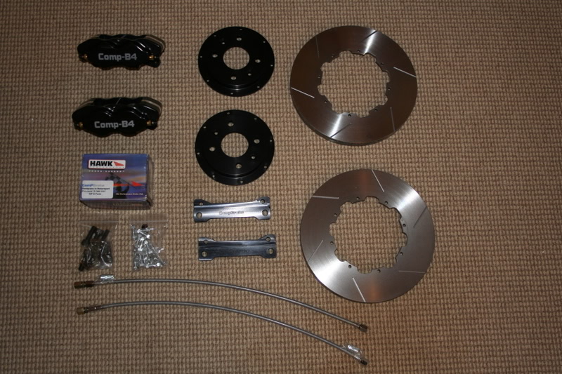

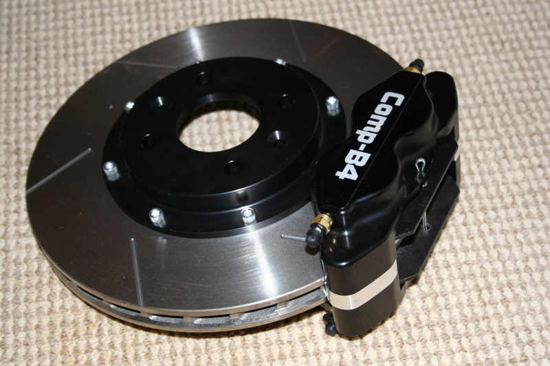

Some more bits have arrived, battery cutout switch, renault 182 headunit and a black sunstrip. the pile is growing. Got some disc's coming on the weekend so i can get the rear brakes sorted......
