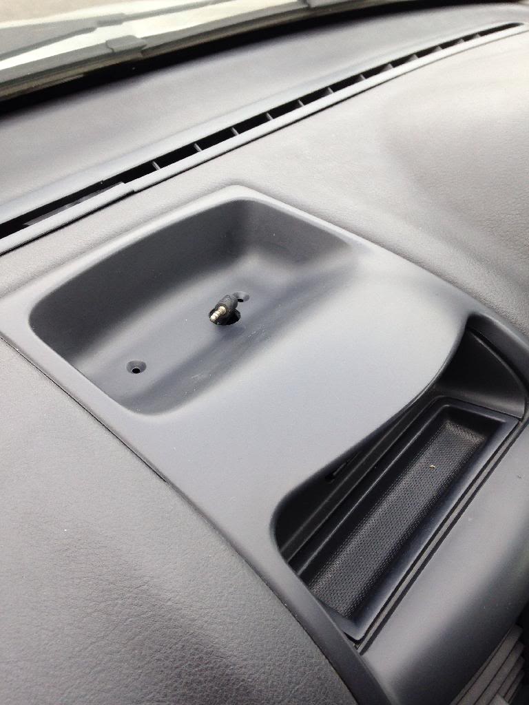

Connects2 aux. Plugs in where the multichanger would in the back of the head unit. Drill a hole in the top dash in that cubby bit above the clock and have it come out there.
