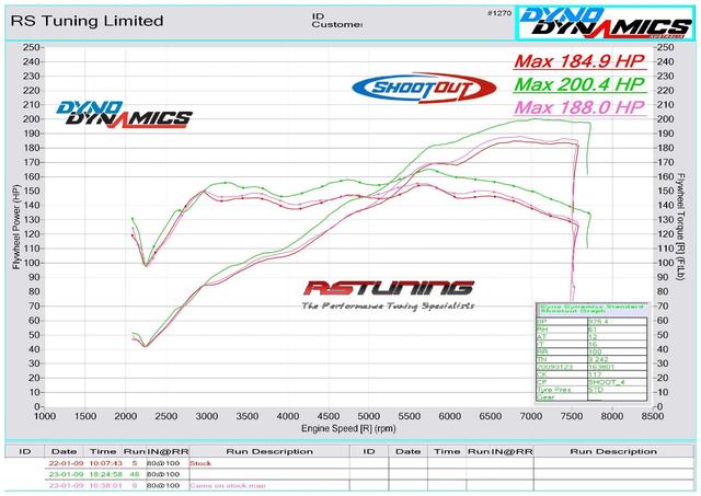

I'm not sure about the Yozza ones but the CatCams 402's give these gains
  • Pre cams and map: 184.9bhp and 156lb.ft of torque
  • With Cat Cams: 188bhp and 158lb.ft of torque
  • With Cat Cams and remap: 200.4bhp and 165lb.ft of torque
I haven't got any details of the gains on other 197 CatCams camshaft profiles unfortunately as there are more aggressive ones
surely more aggressive ones with the map with produce 20+bhp!?
i assume these are simluler gains for the 1*2..?
