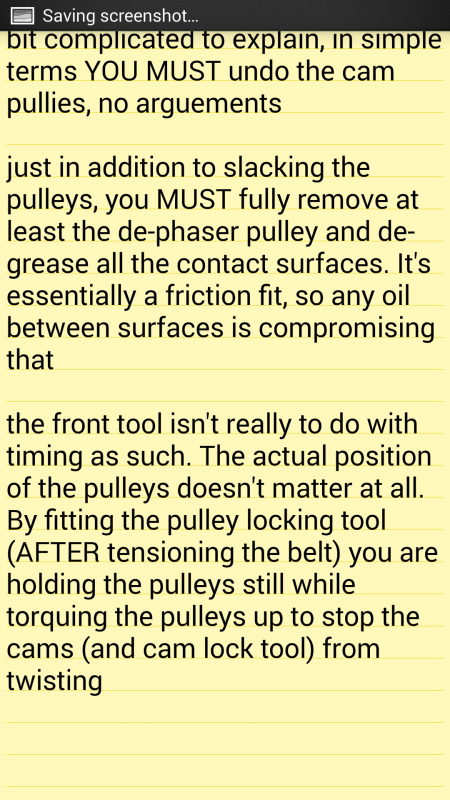

You also need to make sure there is no play in the dephaser and fix any oil leaks in the vicinity.

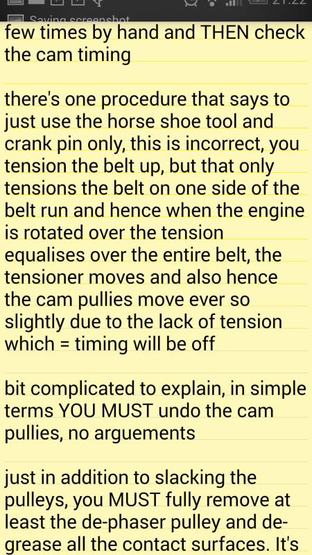

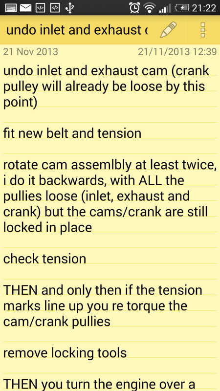

The pdf refers to 2 procedures one involves loosening the cam pulleys the other doesn't.
Undoing all 3 pulleys is the best way, but CS will tell you the procedure that does not loosen the cam pulleys is wrong. It isn't. Sure it relies on the timing being correct previously and that the new belt has the same characteristics as the old one. This is the same assumption that is made when doing a cambelt on a car that has keyed pulleys so is what happens with most cars.
You can do it the Renault way with the pulleys locked as many have I'm sure if the timing was spot on (hence the large numbers of poor Dyno results and poor idles) and take the chance it was all perfect before and it won't move even a little bit once it all settles in (unlikely) but why not just loosen the ruddy pulleys and make sure it is all equal. Engines that have keyed pulleys are not that timing sensitive and can get away with it and so are no comparison.
