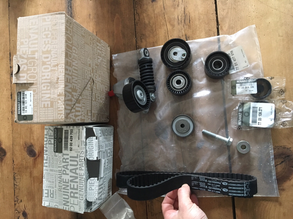

Ordered a cambelt kit with my engine number because not sure what engine is in my Clio 172 as it's been changed at some point, the question is the genuine kit has come with two idlers but different sizes because one had superseded the other at some point, I can't find the old idlers as had a bit of a tidy up ! Anyone know what size they should be anyone heard this before?
afik the two different kits are with plastic idlers or metal ones? bearing centre diameter is also different on them so they mount slightly differently.
Sorry this has taken so long been a bit busy at work this is what I got cheers for your help
