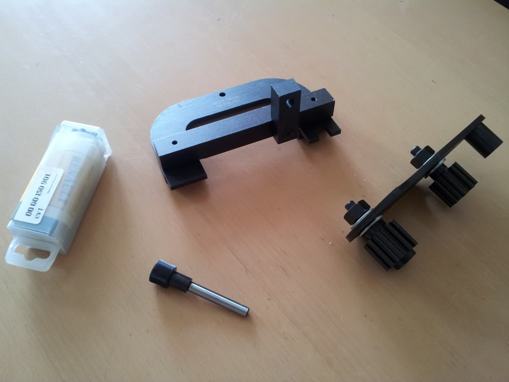

Hi guys,
I've just recently purchased a clio 182 ff and i'm going to change the cambelt, dephaser, water pump and aux belt... got most of the parts now and i'm wanting to know what tool or tools, locking tool etc as i know its very important to use the correct tool Where can i purchase? Is there anyone on here with one i could borrow perhaps?
Thanks in advance.
Ive used the micro tech tools with no problems if you changing the dephaser as well then you need the pulley locking tool, horse shoe tool for the cam shafts and the crank pin, flywheel locking tool comes in handy as well unless you have a friend with a big screwdriver...
You'll need the pulley locking tool whether you change the dephaser or not if you want to follow the procedure correctly.
Here's mine
Bought mine from a local dealer, without all 3 it's very unlikely the timing will be within spec.
These only have to be a nats c**k out and there down on power!
I wish I had the or a c spanner for the exhaust pulley.. Many of my failed attempts were down to the locking off the tools and moving the pulley before I'd even started to lock off the pulleys themselves. Doh
