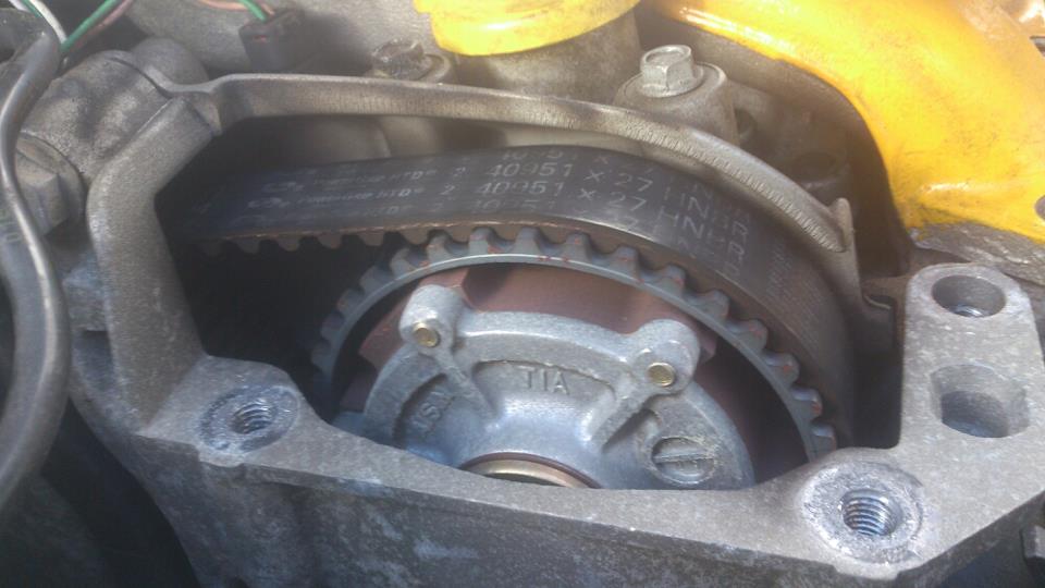

Hi Guys,
Recently bought a 172 and its done 71000 and on a 02 plate, previous owner says he thinks the belt has never been done so i whipped the engine mount bracket off to have a look.
Were they factory fitted with Gates Powergrip Belts? if not it must have been changed atleast once, belt looks good, no fraying and good tension. Dont think writing would still be clear after 10yrs lol

Heres a pic:

Id say that is not the original belt. The writing usually wears off after a few thousand miles.
I'd still start saveing to have it changed for peace of mind though.
Your car has had a cambelt change, you can still see the 'Gates Powergrip' labelling on the belt, widely supplied in the trade by motor factors etc ;) Plus that belt doesn't look too old, but it's never good to judge a camber on how it 'looks'.
Totally WRC i agree mate, the fact it still has writing on it tells me its not too old. Will still change next year at somepoint.
incorrect information
Gates are OEM suppliers, all genuine belts say the same thing
That belt looks relatively old to me, but probably not the original. I'd hope not anyway as it's overdue for it's 2nd belt on age anyway

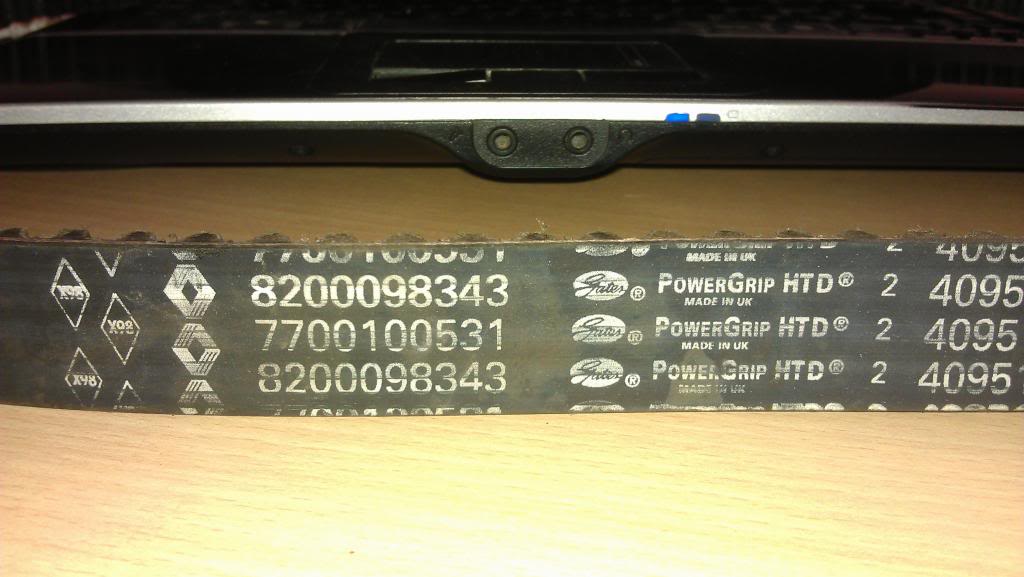

So a Renault belt from the factory has 'Gates powergrip' written all over it?
Even though 'powergrip' is the brand label for their after market kits.....
Googling genuine Renault cambelt, I can't see any that have this stamping.
Agreed, obviously same belt as gates are one on most, but then there is a lot of dayco out there conti also etc, I.e. the belt will be the 'same' but the belts are intact marked different from genuine to aftermarket a lot a lot of the time...
you'll take note of the Renault Diamond stamped on the left, and the Powergrip stamped on the right. Genuine belt.
When i change belts on Renaults etc at 5 years the writing can still be clearly read, so its anyones guess as to how old it is.
Might be too late to help but I have I just got a genuine Clio 182 cambelt kit and the manufacturer of the belt is Gates.
