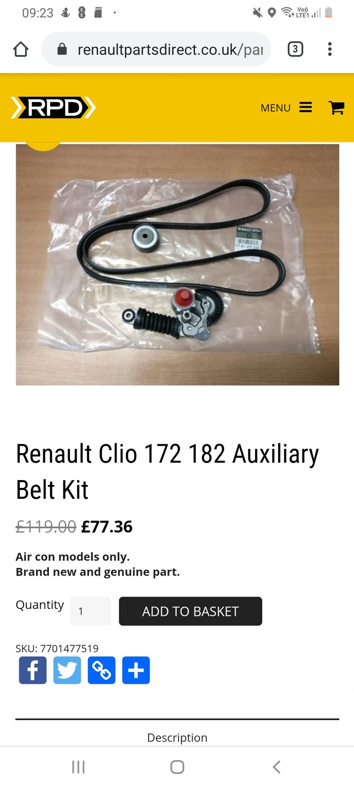

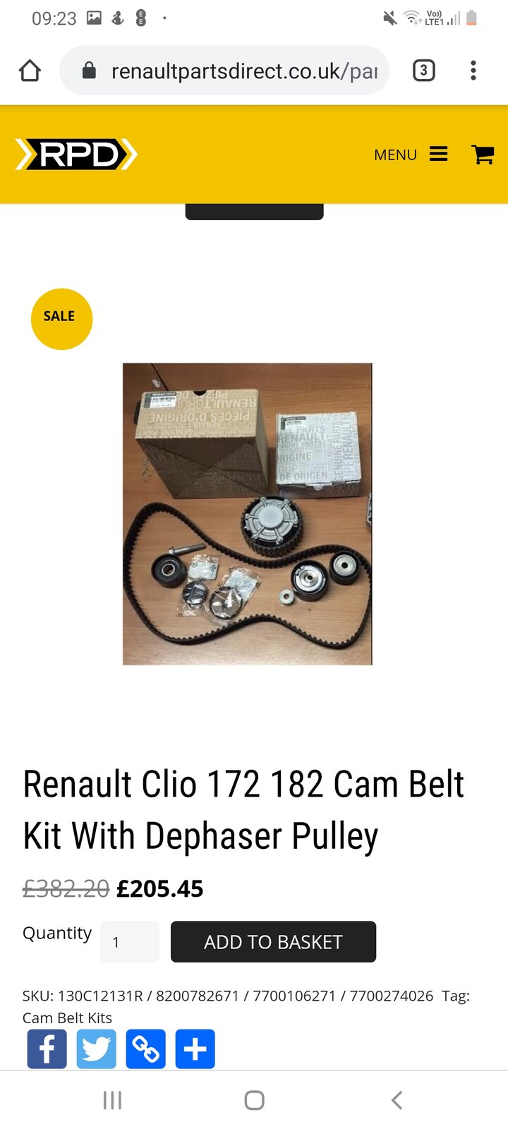

Hi everyone I've booked my car in for its 72k cambelt change and the garage has suggested to order my own parts from Renaultdirect as they have got a massive sale on at the moment. So far I've ordered these 2 items is there anything else I should order
They have a cambelt change kit..(air con or none air con) the auxiliary kit comes with It...you'll need oil and filter too..
I no I noticed that after I ordered them stupid me. Thank you will I need to order the selent aswell
I've just noticed the car had new oil and filter and spark plugs 2.5k ago is there any point in ordering them

Those kits you've ordered doesn't include the seal behind the cams, a new crank pulley bolt or a new waterpump.

The kit he's ordered for £205 doesn't include the cam seals, crank pulley bolt or the seal plug for the dephaser.
Not sure what you mean, but he's ordered both kits but individually.
The cambelt kit (which doesn't actually include everything) for £205 and then the aux kit for £77.
At the start of the thread he stated he ordered the Auxiliary belt kit... I suggested to buy the cambelt change kit..not the cambelt kit..

His first post had 2 picture atttachments, the cambelt kit and aux kit. Maybe you only saw the aux kit pic?
But yeah he should be sorted now once he gets the cams seals kit i linked and a crank bolt.
