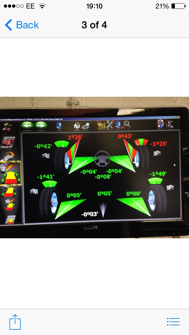

Is this camber out by loads or not too bad, wasted hundreds trying to get it sorted, just need to know the damage as I don't want to buy a new car having spent thousands making mine how I want, but I've given up on the geo

Check the front right wheel bearings for play, top mounts and for any damage to the the subframe, wishbones or hubs.
I'm not quite sure how to read that schematic, but you either have the camber or the caster out on one side. The readouts aren't conclusive for me as to which is which.
