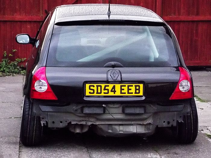

-3 degree's but using washers not shims. standard ph1 has about -1 degree as standard. 1.25mm washer has given an extra 2 degree's

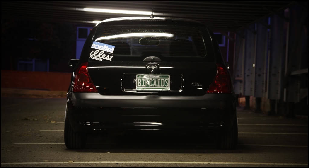

Tyres are only just starting to show signs of ware n ive had the camber for some time easy 18months

As long as the toe is correct it should be just like normal wear but obviously its going to wear more on the inside edge.
